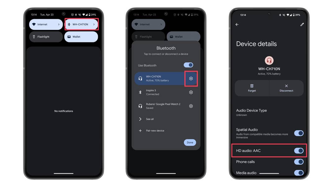

3. Audio quality is poor despite an active connection
If you have problems with poor audio quality, many of the tips we have already mentioned apply. Here too you need a stable and good connection. In addition, there are a few settings on your smartphone that affect the quality of your music.
It’s best to tap the small gear symbol next to the headphones in the Bluetooth menu. Here you may see the HD Audio option. If this is not activated, you should switch it on once. Your cell phone and your smartphone communicate via a different codec, which may provide better quality.
On the computer, some headphones have separate connections for calls and music. In the case of the Anker Soundcore Life Q35, for example, there is a “hands-free” mode that is not suitable for listening to music. Find the setting that you like best.
Many headphones also come with a companion app, which usually contains equalizers or other sound settings. Try out what suits you best here. As a final tip, if possible, you can also connect the headphones to your smartphone using a 3.5-millimeter jack cable. Then you can find out whether the Bluetooth connection or settings are actually the problem for the poor sound quality.
Audio quality recap
- Enable HD audio in your phone’s Bluetooth settings.
- Are you using the correct mode for your headphones on your PC?
- Can you adjust the equalizers via an app?
- Connect the headphones to the smartphone using a cable. Did the audio quality improve?
