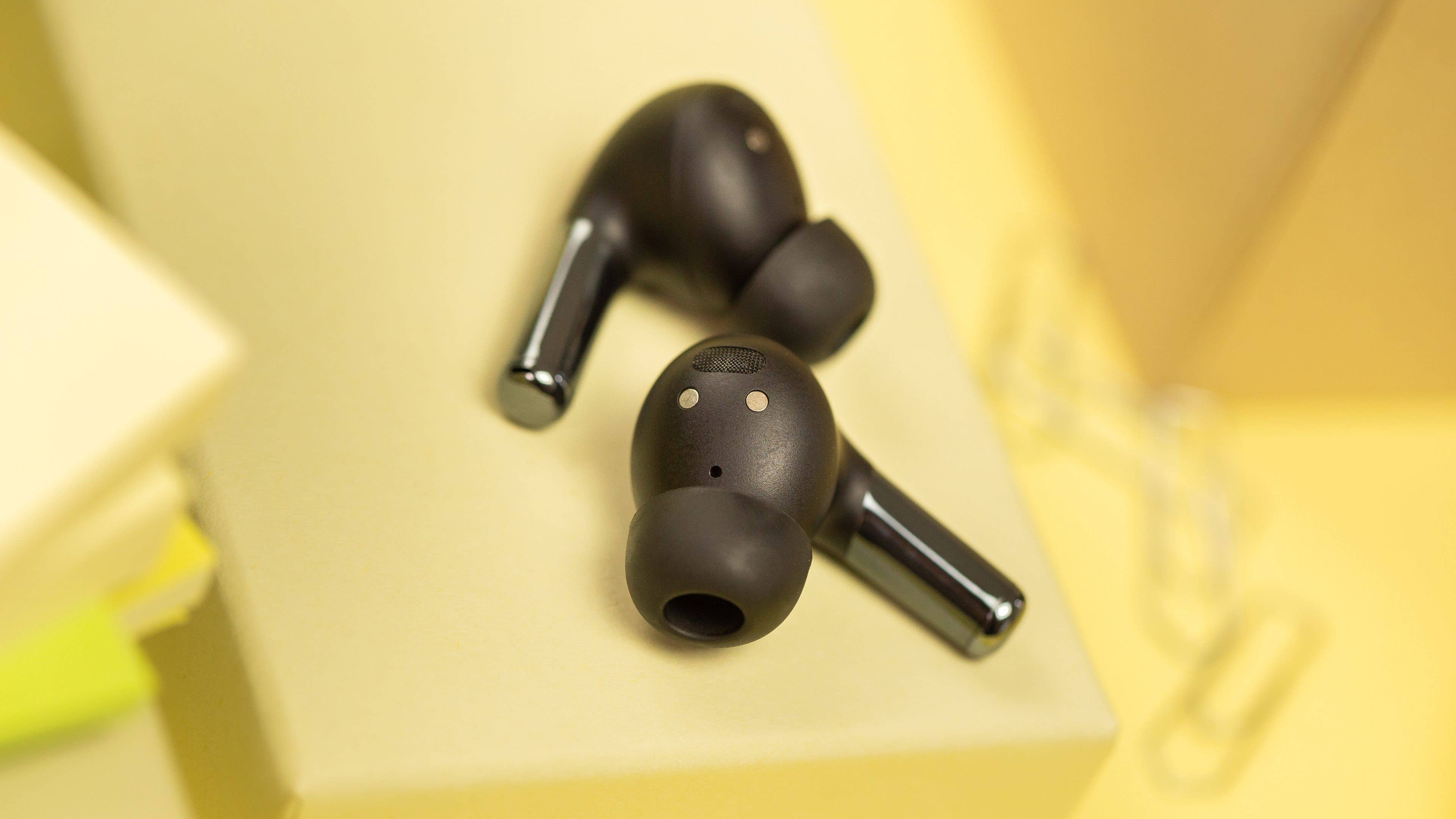

The OnePlus Buds Pro supports the LHDC standard and, in combination with the OnePlus 9 and OnePlus 9 Pro, offers better sound quality than many other Android phones. However, although the flagship line is compatible, OnePlus doesn’t extend the support to its entire product range, which means cheaper models like the OnePlus Nord 2 don’t feature the new feature.
While LHDC is technically impressive, with bit rates of up to 900 kilobits per second in 24-bit definition and sampling rates of 96 kilohertz, the standard simply hasn’t caught on. Not even after a few manufacturers partnered in September 2018, including premium audio brands like Sennheiser, Audio-Technica, and Edifier, chipmaker Cirrus Logic, LDA, and mobile phone maker Huawei.
