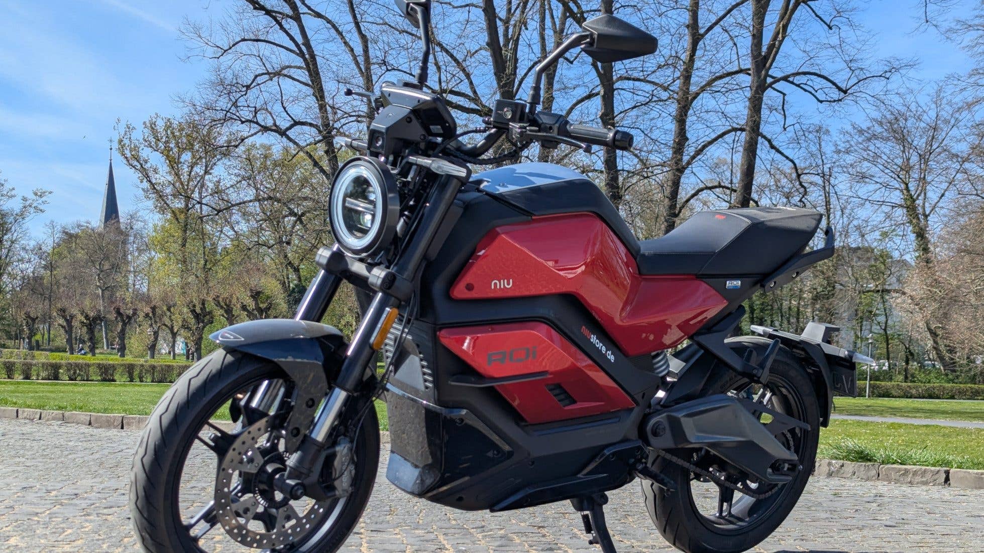

The Niu RQi Sport as seen from the side. / © nextpit
The Niu RQi Sport makes a decidedly grown-up impression on the roadside. At first glance, you might suspect this is a far more powerful machine beneath the sporty, angular design. The robust upside-down fork and the massive rear swingarms already give a hint that the chassis has a lot to offer. The approving glances from passers-by speak for themselves: Brembo brakes, a modern display as a speedometer, and a stylish ring light in the front headlight make for wide smiles.

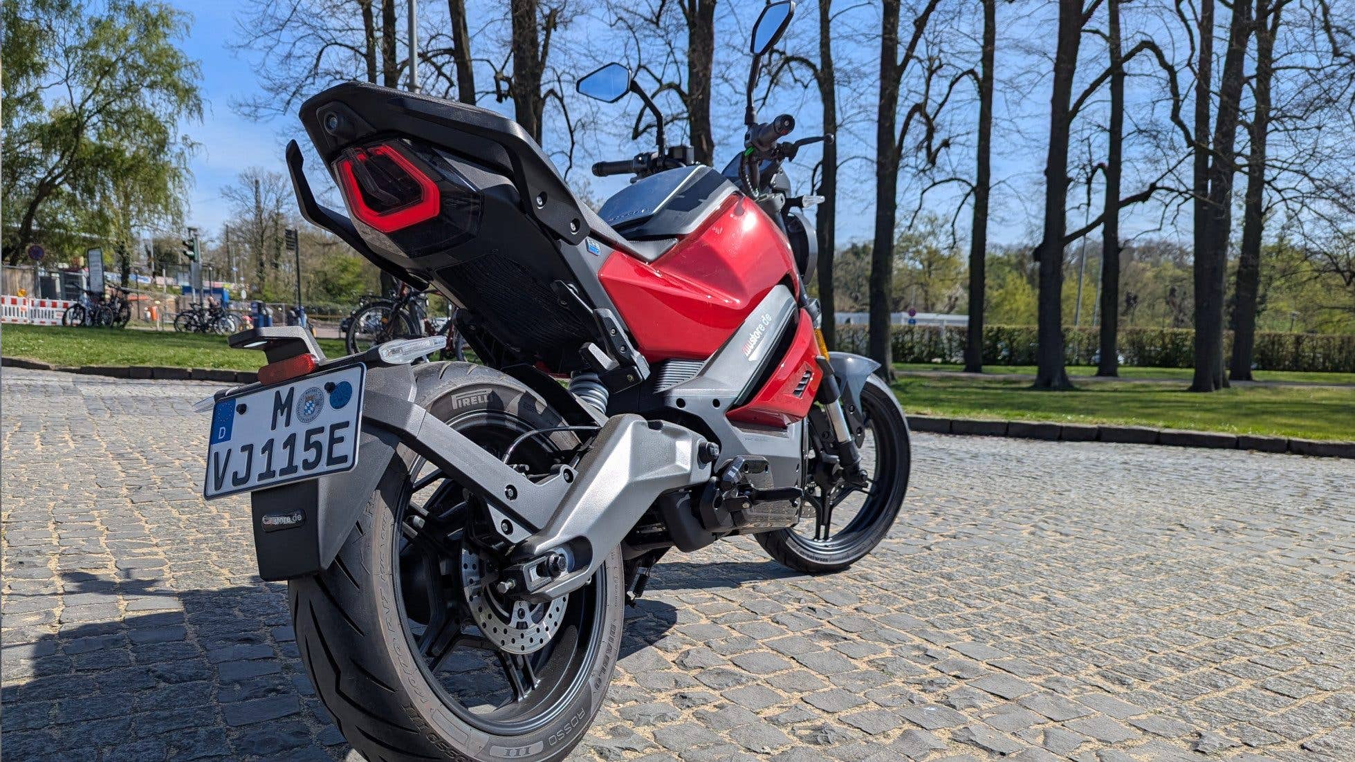

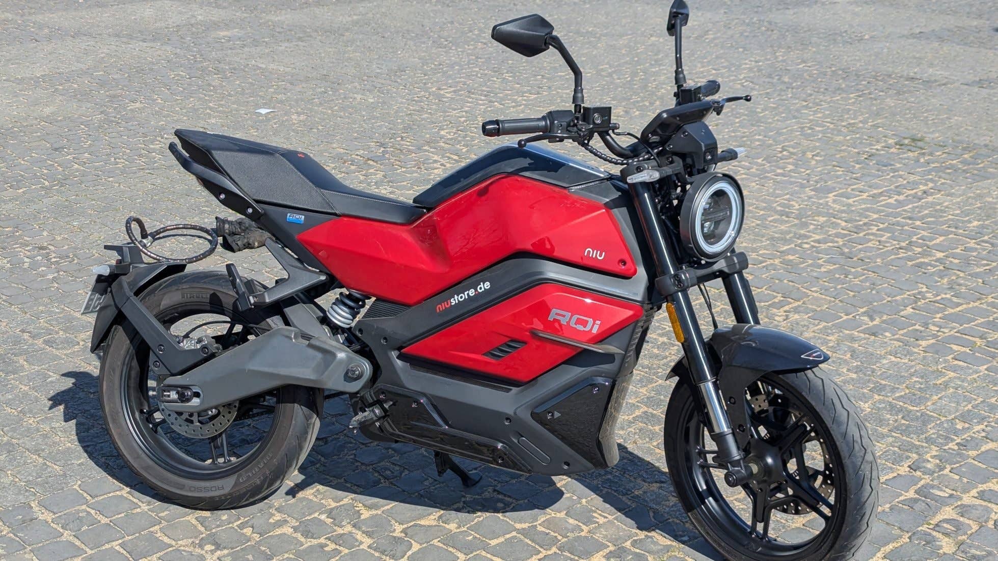

Niu RQi Sport
Another look at the Niu RQi Sport from a different angle. / © nextpit

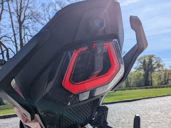

The Niu RQi Sport as viewed from behind. / © nextpit
Once you have left enough cars and powerful Harleys eating your dust behind you at traffic lights in the city, the route eventually leads onto a country road. It is here that the limited power becomes apparent. From around 60 to 70 km/h, propulsion decreases noticeably, and beyond that, it becomes increasingly sluggish. Spontaneous overtaking maneuvers should therefore be carefully considered while keeping the speed limit of the machine in mind at all times. I achieved a maximum speed of 108 km/h on the highway. This makes it clear that the RQi Sport is, as intended by the manufacturer, more of a lively city runabout than a long-distance tourer.

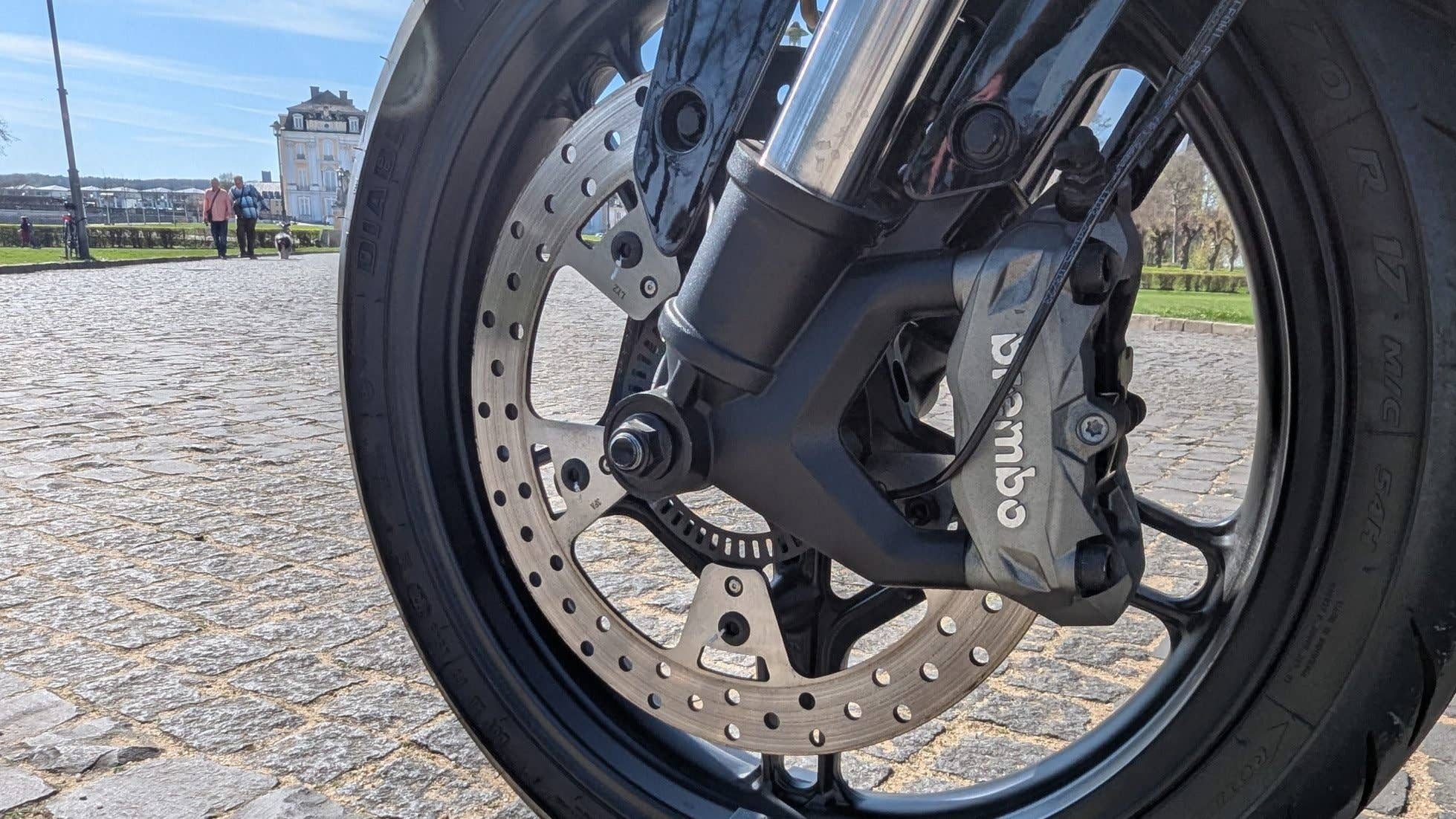

Check out the Brembo brakes on the Niu RQi Sport!
Check out the Brembo brakes on the Niu RQi Sport! / © nextpit
Despite the impressive chassis and powerful brakes, there are also a few criticisms of the Niu RQi Sport. The rear-view mirrors are a little too short for larger-sized riders, which restricts the view to the rear. There is also a software-based feature that should always be kept in mind: if the battery level drops below 17 percent, the system automatically reduces the top speed to below 50 km/h. This is particularly important to take note of in urban areas or on the highway. This energy-saving mode should be taken into account, especially when riding out of town or on the highway. If you don’t want to become a rolling obstacle for 40-ton trucks or farmers in a hurry, you should pay regular attention to the battery level.

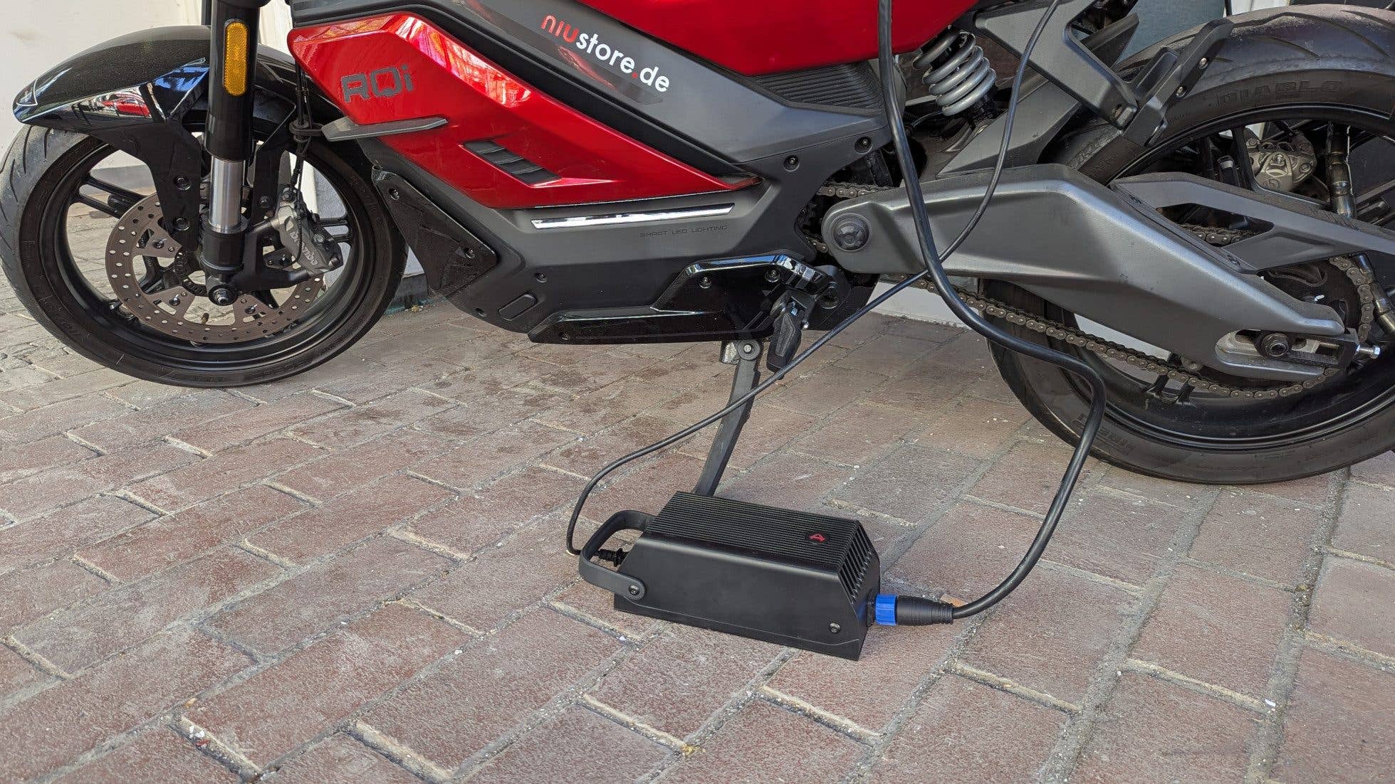

Niu RQi Sport
Charging the battery of the Niu RQi Sport. / © nextpit
Fortunately, the Niu RQi Sport batteries can also be charged directly while strapped to the bike. This requires a charging cable with a hefty adapter, which is also quite heavy. The charging process from 0 to 100 percent takes a snooze-worthy 7 hours in this setup. However, if you were to remove the batteries and charge them at home using a charging adapter and splitter, the charging time is reduced to around 4 hours. Neither of these is a particularly fast time, which doesn’t exactly make Niu bask in glory. However, the range of 100 km makes those quite realistic figures, at least when you take dynamic riding mode into consideration. If you were to switch to Sport and play a little too much with the launch control and sprint competitions at traffic lights, the range will drop to 70 to 80 km.
