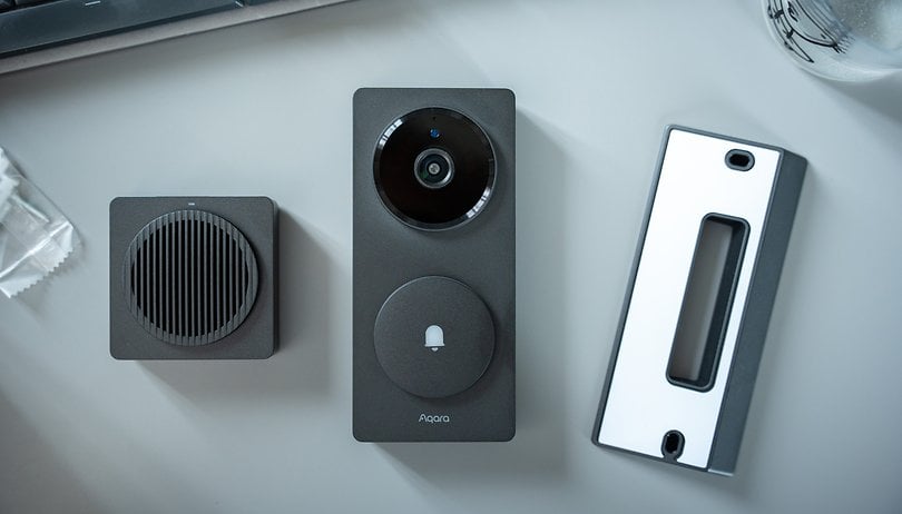

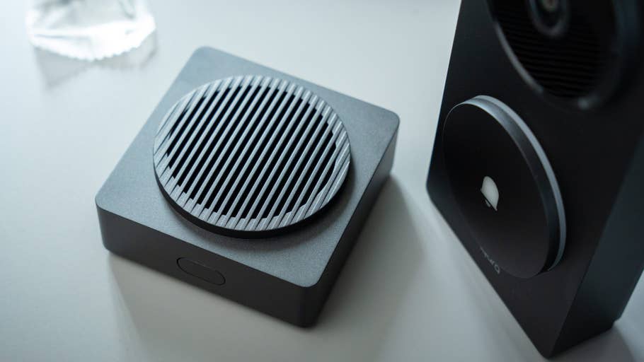

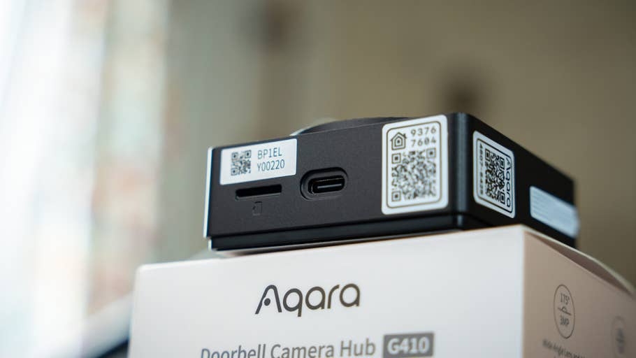

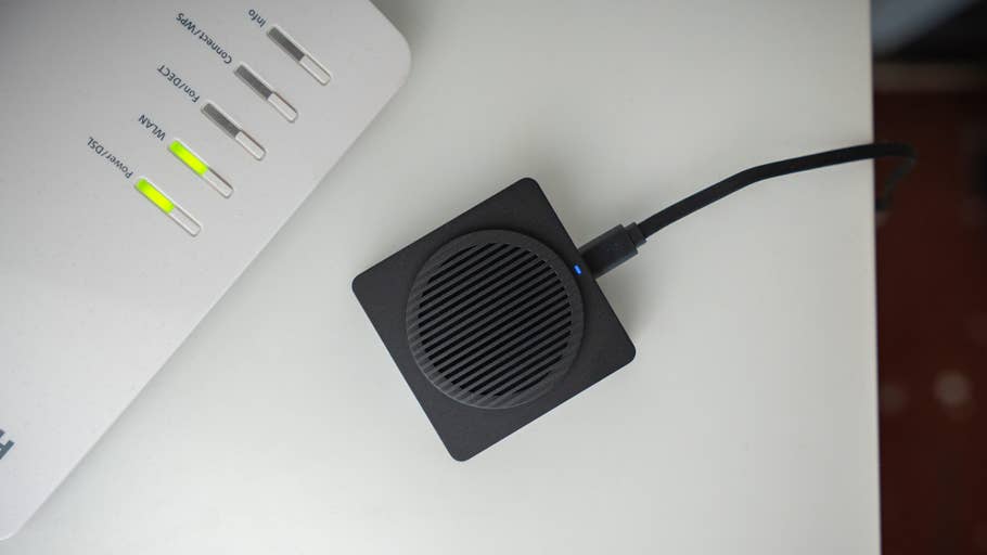

The Doorbell Camera Hub G410 does not consist of just one device. When setting it up, you therefore need to attach the camera and doorbell unit and connect a chime to a power supply. The chime acts as a bridge and is the device that connects to your Wi-Fi. Here we also find a microSD card, on which we can save videos. This has the advantage that the videos always remain safely within the home and cannot be stolen by burglars, as is the case with many smart surveillance cameras.
In our test, however, we were initially a little confused by this setup. We didn’t leave the chime permanently connected to the power supply, and were then puzzled as to why the doorbell lost its connection to the Wi-Fi. A mistake on our part that we would like to spare you. So let’s move on to the design of the doorbell.

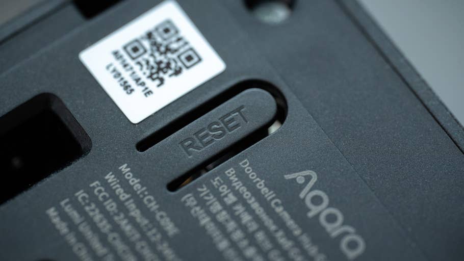

Close-up of the Aqara Doorbell Camera Hub G410 showing the RESET button and QR code.
Quelle: nextpit

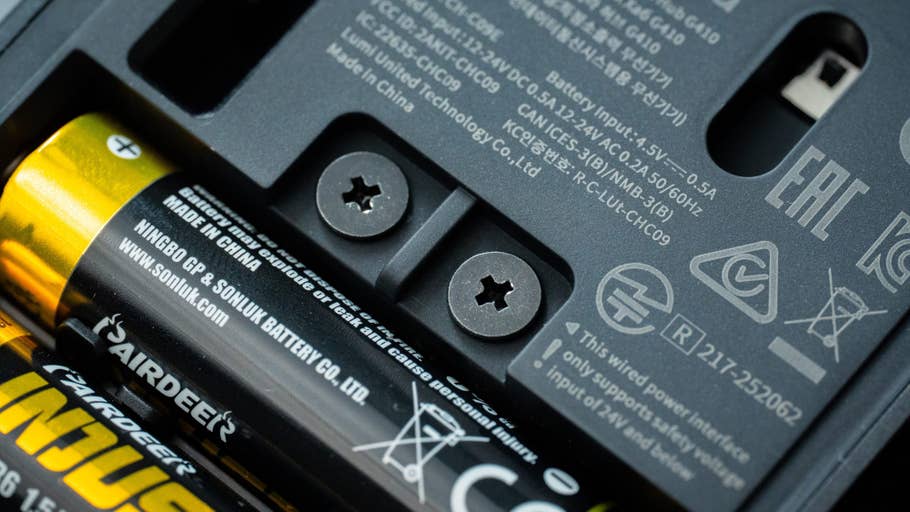

Close-up of batteries and technical specifications for Aqara doorbell camera hub G410.
Quelle: nextpit
Aqara Doorbell Camera Hub G410 placed next to a modem, featuring a square design and a visible power indicator.
Quelle: nextpit

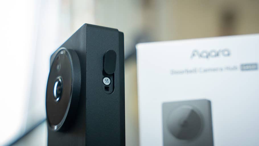

Aqara equips the doorbell unit with a removable back plate that we can drill or glue on. It is convenient that the screw, which sits on the side under a rubber cover, does not fall out, but stays in place when unscrewed. The gong, on the other hand, only has an adhesive surface on the back. However, as it is very light at 70 g, this is not a problem. However, the USB-C cable supplied can be problematic – the flat cable is only 1 m long. You may therefore have to use a different one, but then you lose the advantage of being able to lay the cable under doors or through cupboards.

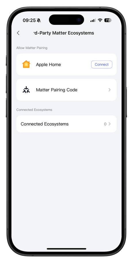

Aqara has already impressed with Matter support for its smart home devices in previous test reports. Now, with the Gong of the Doorbell Camera Hub G410, a remarkably compact device has found its way into our smart home, which also functions as a Matter controller, Thread Border Router, and Zigbee hub. This saves us from having to use proprietary bridges from other manufacturers. For example, I could connect my Tado-X thermostats via the Aqara hub and thus have a free socket in the home. The smart home hub also supports Thread – this is the kind of compatibility you really want from all alternatives.

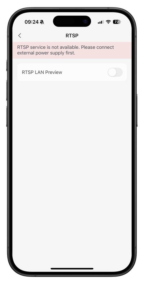

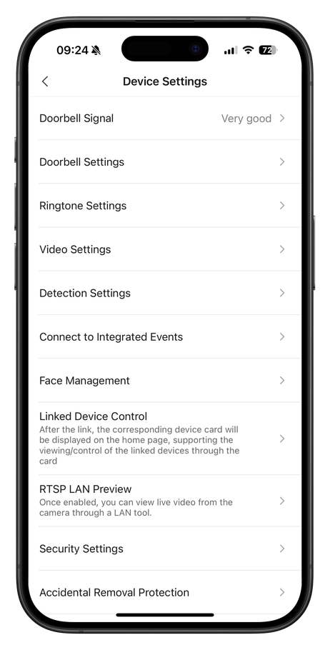

The Camera Hub G410 can also be integrated into the smart home ecosystems of Amazon, Google, Samsung, and Apple. What is particularly interesting is that we can also access the video feed via the open-source Home Assistant system. However, those who opt for the Aqara ecosystem enjoy a few more advantages.

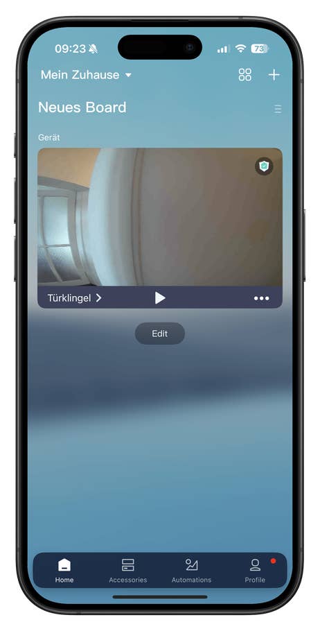

Smartphone screen displaying the Aqara doorbell camera interface with options to edit and view recordings.
Quelle: nextpit

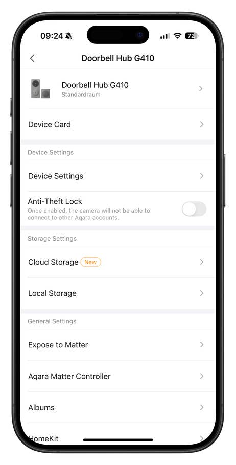

Device settings menu for the Aqara Doorbell Camera Hub G410.
Quelle: nextpit

RTSP settings screen with a message about service unavailability and a toggle for RTSP LAN Preview.
Quelle: nextpit

Settings screen for Aqara Doorbell Camera Hub G410, showing Matter pairing options.
Quelle: nextpit

The Aqara app expands the range of functions to include facial recognition, masking functions for the camera image, and two-way calls with voice distortion for more privacy. In addition, much of this can even be used in the context of smart home automation. For example, if the doorbell recognizes your own face, it can play a personalized greeting and automatically unlock a connected smart lock. Or it can make compatible lamps light up green when it recognizes faces and red when it recognizes strangers. Many more or less sensible ideas are conceivable here.

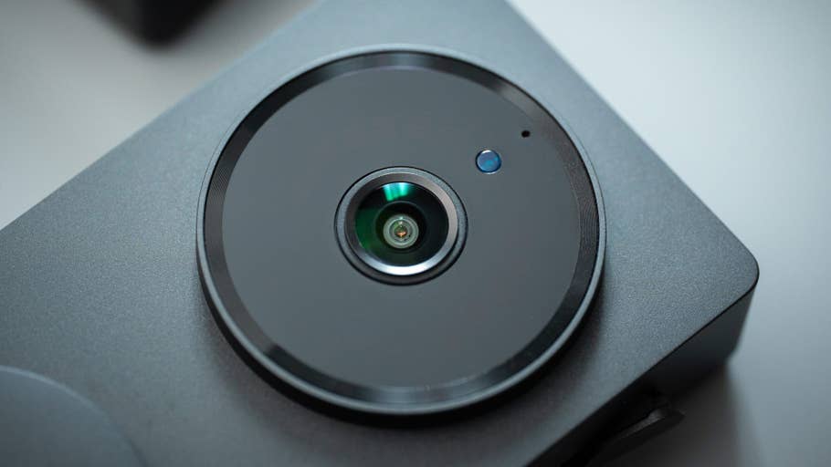

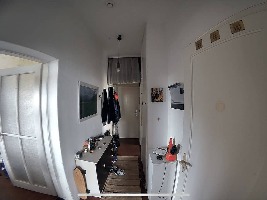

Let’s move on to the technical features of the Doorbell Camera Hub G410 and the detection functions. The maximum resolution of the built-in video camera is 2K and covers a 175° field of view. This means that the camera delivers very clear images during the day and should also cover driveways or part of the street in addition to the area directly in front of your front door. In combination with the 24/7 recording function, the doorbell can even take on a dual role as a smart surveillance camera.

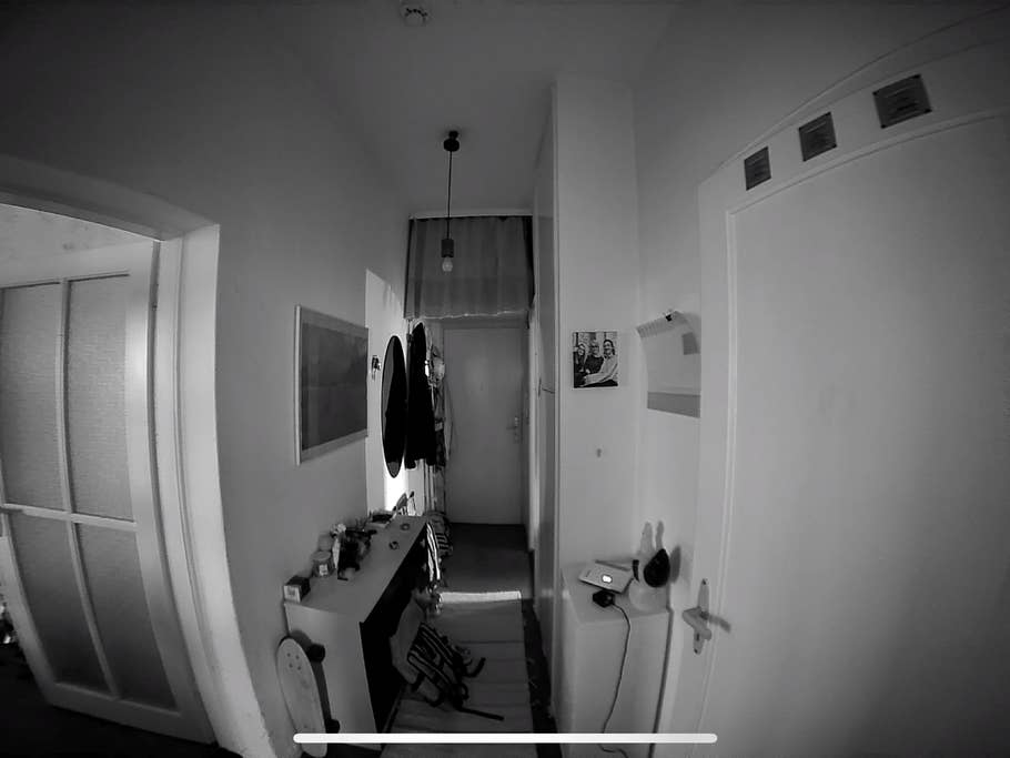

When it gets dark outside, however, the Camera Hub G410 is limited by a missing function: there is no built-in spotlight to deter burglars or illuminate visitors. I think Aqara assumes that most door areas are equipped with lights anyway. If that’s not the case for you, the device at least has infrared night vision – you can see exactly what the night vision looks like in the pictures in our gallery.
A hallway with a door, wall decorations, and a console table with items on it.
Quelle: nextpit
A hallway with a white door, coat rack, and a shelf with items in a black and white tone.
Quelle: nextpit

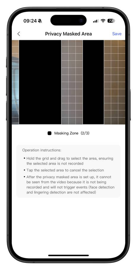

For more privacy or fewer notifications, Aqara also offers the option of deactivating certain areas of the camera image. These are then blacked out, but detection still works thanks to the integrated mmWave radar sensor.

The Aqara Doorbell Camera Hub G410 is somewhat unusual in that the camera unit is battery-operated with six AA batteries, which are not rechargeable out of the box. According to the manufacturer, the battery life is up to five months. However, Aqara assumes only 10 activations per day. If people regularly walk past your front door or you have a lot of visitors, the battery life will decrease accordingly.

USB-C and microSD are located on the gong / © nextpit
