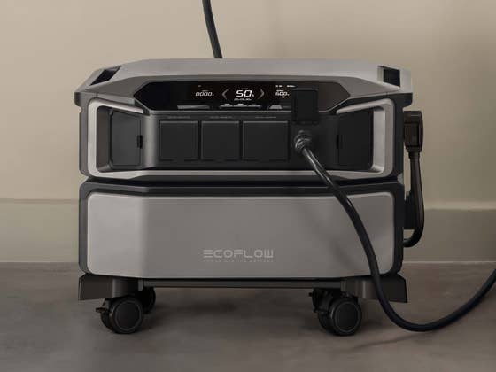

The EcoFlow Delta Pro Ultra itself is initially “just” a battery inverter. The 69 x 48 x 21 cm box does not contain any battery capacity, but is dependent on additional connected batteries. These individual battery modules are similar in size to the inverter and each feature a 6,144 Wh capacity.
You can connect up to a maximum of five batteries per inverter, providing you with a steady 30 kWh. EcoFlow relies on lithium iron phosphate (LFP) for its battery technology. After 3,500 charging cycles, the cells should still offer 80% of their initial capacity.
EcoFlow Delta Pro Ultra: Up to 30 kWh capacity
Back to the Delta Pro Ultra inverter module. This converts the direct current from the batteries into alternating current. You have six 240 V sockets available here, delivering a total possible output power of 7,200 W. However, the output power per socket is, of course, limited to 3,600 W.

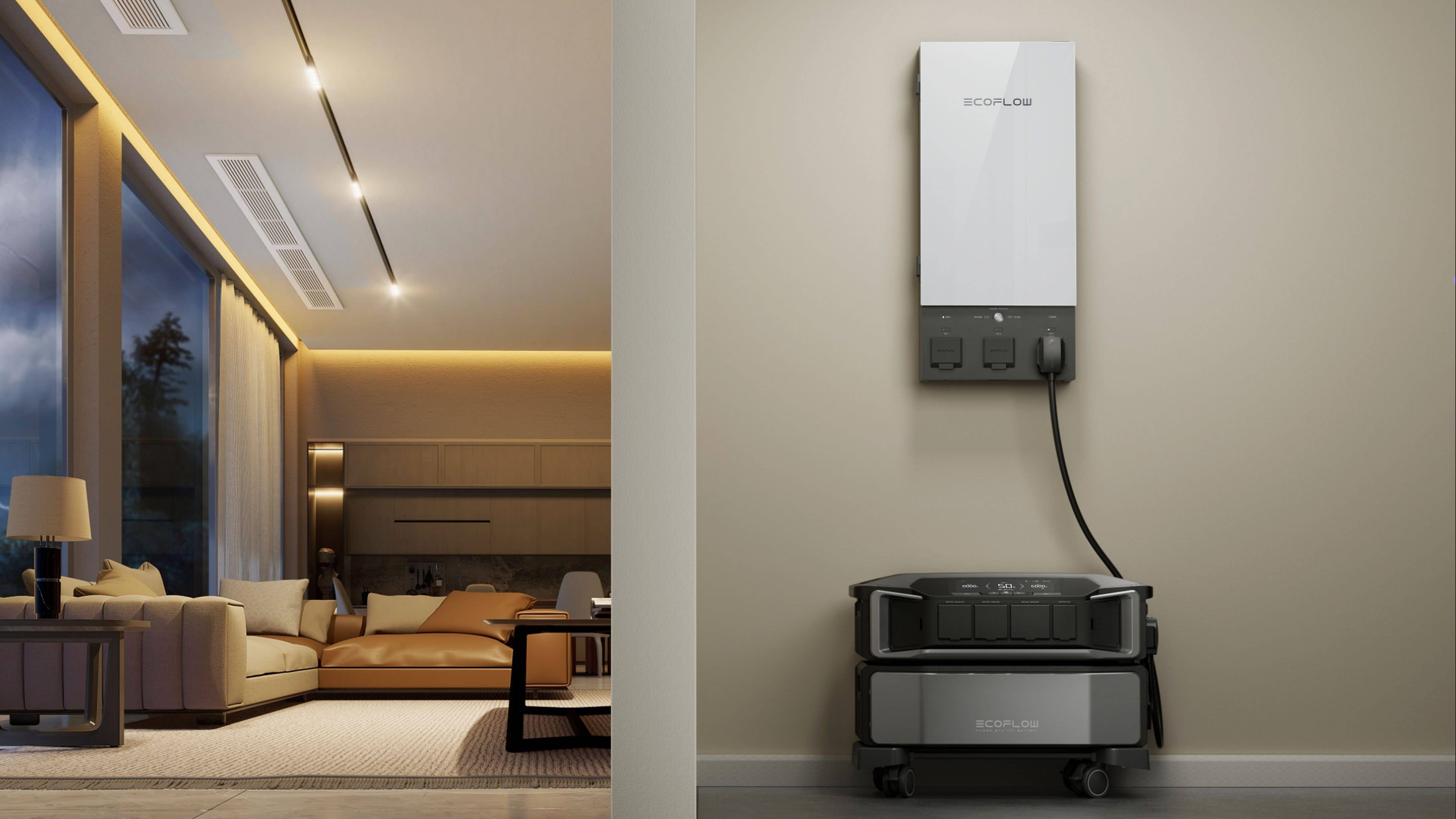

The Smart Home Panel 2 serves as a bridge between the energy storage system and your home network. You connect the Delta Pro Ultra directly to your power box via the device and can feed the energy stored in the Delta Pro Ultra into your household.
You can connect a total of three Delta Pro Ultras to one Smart Home Panel 2. If you were to maximize the use of the power storage unit, this would result in triple the output power of 7,200 W, i.e. 21.6 kW! You can divide the power into twelve load circuits via the panel.
Of course, this also applies to the maximum possible capacity. A system with the Delta Pro Ultra supports a total of 15 battery modules with 6,144 Wh each, i.e. 92 kWh.
Of course, you can also begin small with just one inverter and one battery before gradually expanding the system. We will find out ASAP whether you can supply all three phases with power via the Smart Home Panel 2 with just one Delta Pro Ultra or whether three inverters are required.

According to EcoFlow, the Smart Home Panel should be effortless to integrate into the home network where any electrician can carry out this work without any special EcoFlow training. This should make the Delta Pro Ultra ideal as a PV storage system for uncomplicated retrofitting. The existing inverters can then possibly even be retired (or sold on eBay).
Both the Delta Pro Ultra communicate with your smart home via WLAN and Bluetooth, while the Smart Home Panel 2 also offers an Ethernet connection for a more reliable connection. With the Smart Home Panel 2, the EcoFlow Delta Pro Ultra also serves as an uninterruptible backup power supply.
According to EcoFlow, the box switches your entire household from the primary operation to battery operation with a maximum delay of 20 ms. You can also connect particularly important devices directly to the Delta Pro Ultra according to the manufacturer, with a switching time of 0 ms.
