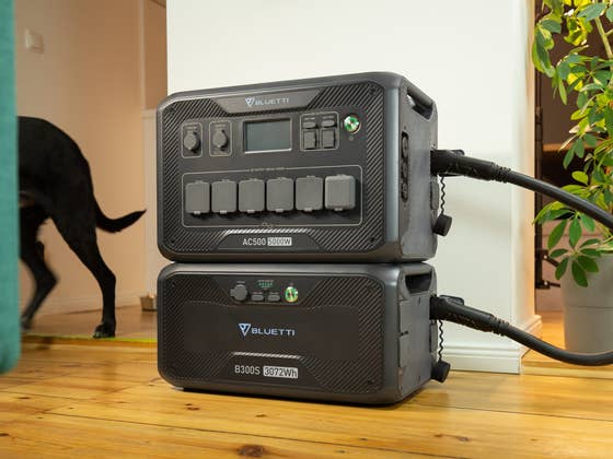

The unit that we reviewed consists of two components. First is the Bluetti AC500, an inverter with up to 5,000 watts of continuous output power and up to 10,000 watts of peak power. What would be of interest to owners of solar-powered systems, this model is capable of handling up to 3,000 watts of DC input power, making it a suitable inverter for small to mid-sized rooftop systems.
The second part is the power storage unit. In the NextPit review, this is a single Bluetti B300s with a capacity of 3,072 Wh. Theoretically, you can connect up to six of these batteries to the AC500 and achieve a maximum capacity of 18,432 Wh. That is pretty impressive, being enough to power a single-family home for several days in the event of a zombie apocalypse.

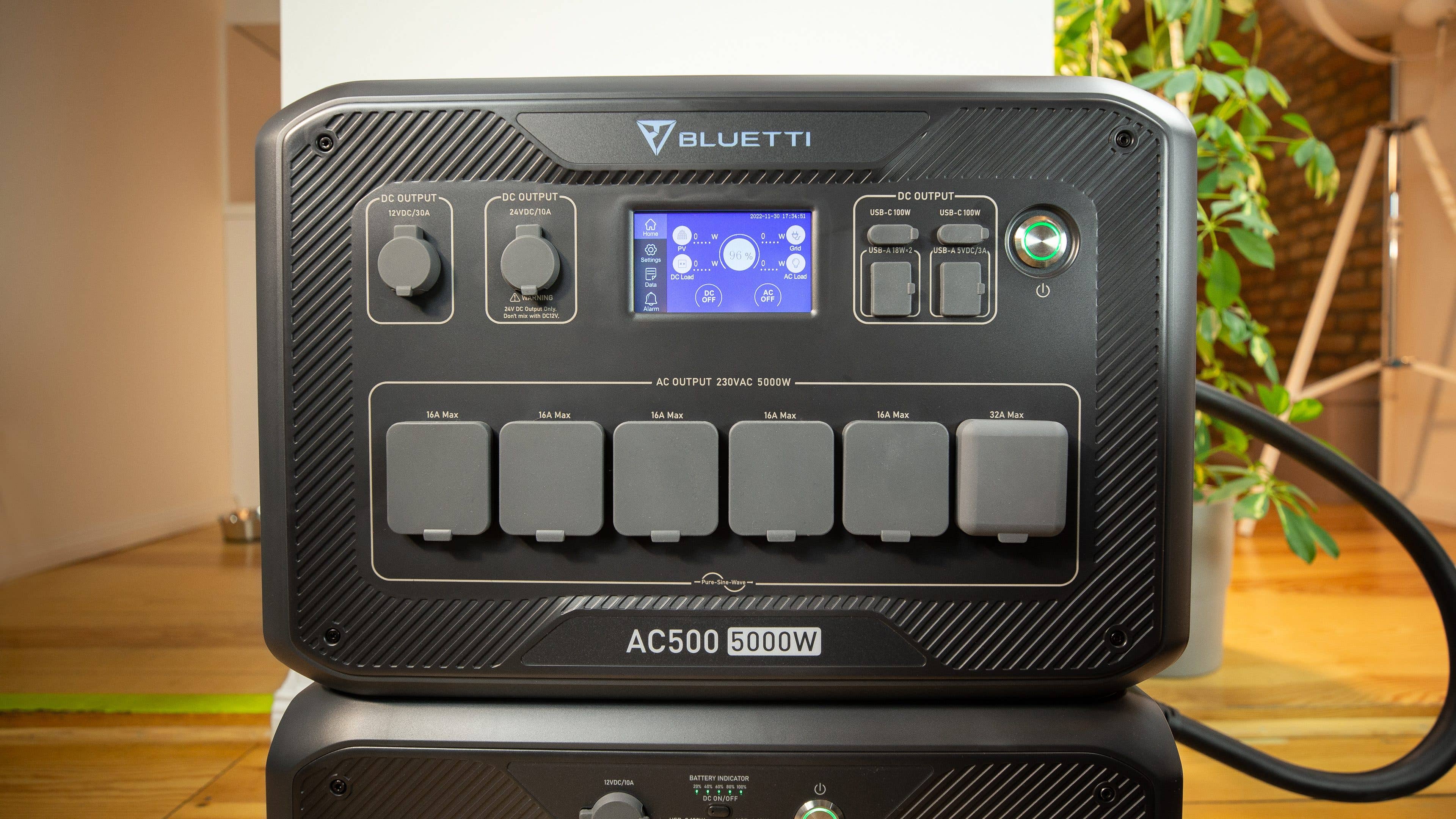

Like most other Bluetti power stations, the AC500 arrives in a solid black plastic box. The material used feels like it is made from very high-quality stock and does not look cheap. At the top, there are two handles that remain flush with the case, making it easy to carry the 30 kg inverter. At the bottom, there are four non-slip rubber feet to ensure a secure stand.

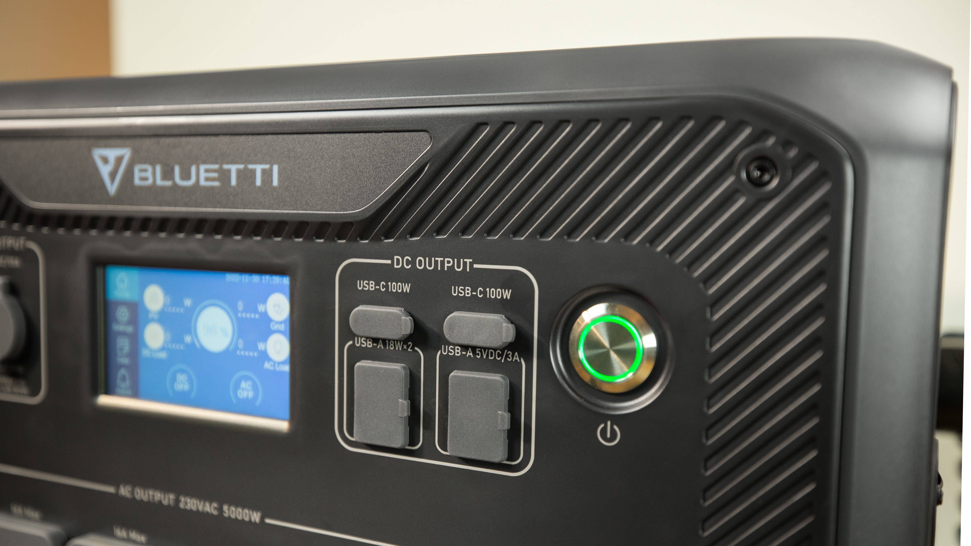

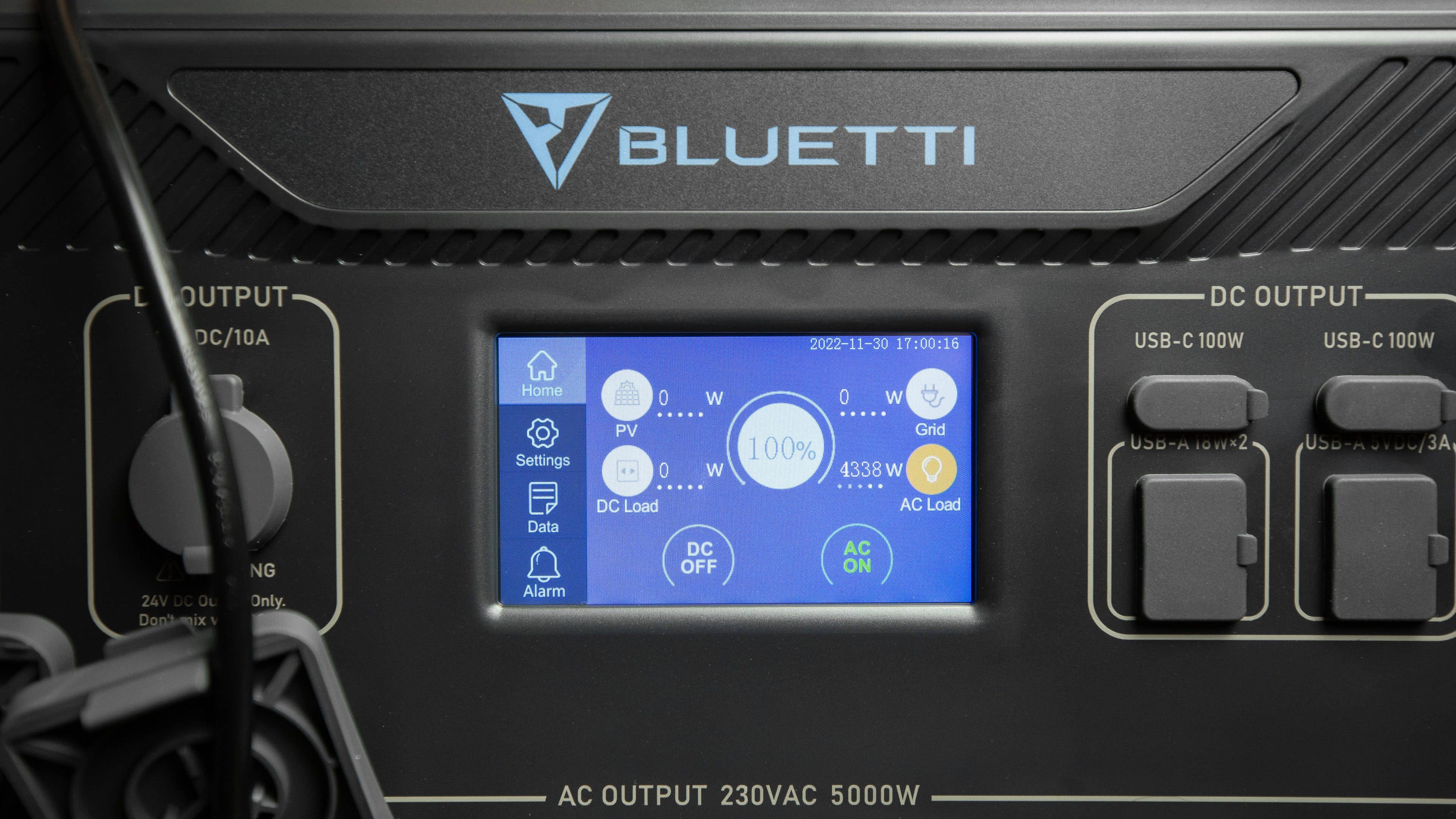

The Bluetti AC500 and the connected batteries are operated via the large on/off button on the right front and the touchscreen. The touch-sensitive display responds well but looks a bit out of date with the plastic coating and the rather low resolution.
Bluetti AC500 mit B300s
The Bluetti AC500’s touchscreen display doesn’t look particularly modern, but it serves its purpose and is responsive. / © NextPit Image source: NextPit
All of the AC500’s outputs remain in front. When it comes to DC, you will find two cigarette lighter sockets at 12 and 24 volts and 30 and 10 amps, respectively, which you should avoid getting confused with. A corresponding warning is also found on the case below the 24-volt socket. There are also four USB-A ports (maximum 18 watts) and two USB-C ports (maximum 100 watts).
Below the DC outlets, you’ll find six 120-volt sockets seated in a long row. The first three are fused at 20 amps each, two at 30 amps, with the last at 50 amps. Unlike the 20 & 30-amp sockets, the 50-amp socket has standard NEMA14-50 under its rubber cap. This socket is one of the Bluetti AC500’s great strengths.

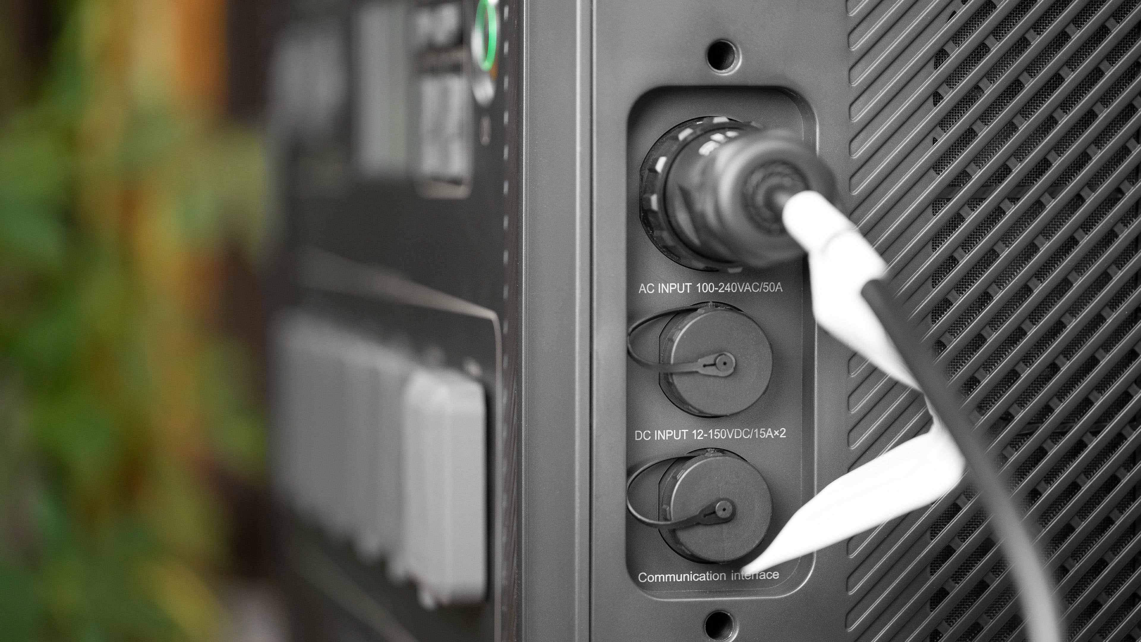

Let’s move on to the inputs: There are a total of five ports on the right side of the AC500. Two ports are used to connect additional Bluetti batteries to the inverter. As mentioned at the beginning, you can connect up to six B300s here. According to the Bluetti website, you can also connect up to four B300s or mix a maximum of four B300s and B300s. However, the cables that come with the B300s, unfortunately, do not fit into the sockets of the AC500 despite having a similar pin arrangement. Therefore, we could not test out a mixed operation.
At the right side of the AC500’s case, you’ll find two inputs for charging the power station via direct current and alternating current. / © NextPit Image source: NextPit
Finally, you’ll find another DC input on the side of the AC500, that makes it suitable for solar-powered systems. The port supports voltages between 12 and 150 volts. If your solar-power system has a higher voltage, you will have to connect the optionally available Bluetti D300s, which then is streamlined lower from 550 volts to 120 volts. According to Bluetti, the maximum input power here is rated at 3,000 watts.
Last but not least, there’s an AC input for charging the AC500 or the batteries via your mains. In the review, we charged it at just under 2,300 watts. The last port is labeled “Communication Interface” and is used to connect two AC500s with the Bluetti Smart Home Panel, which is unfortunately only available in the US at the moment.

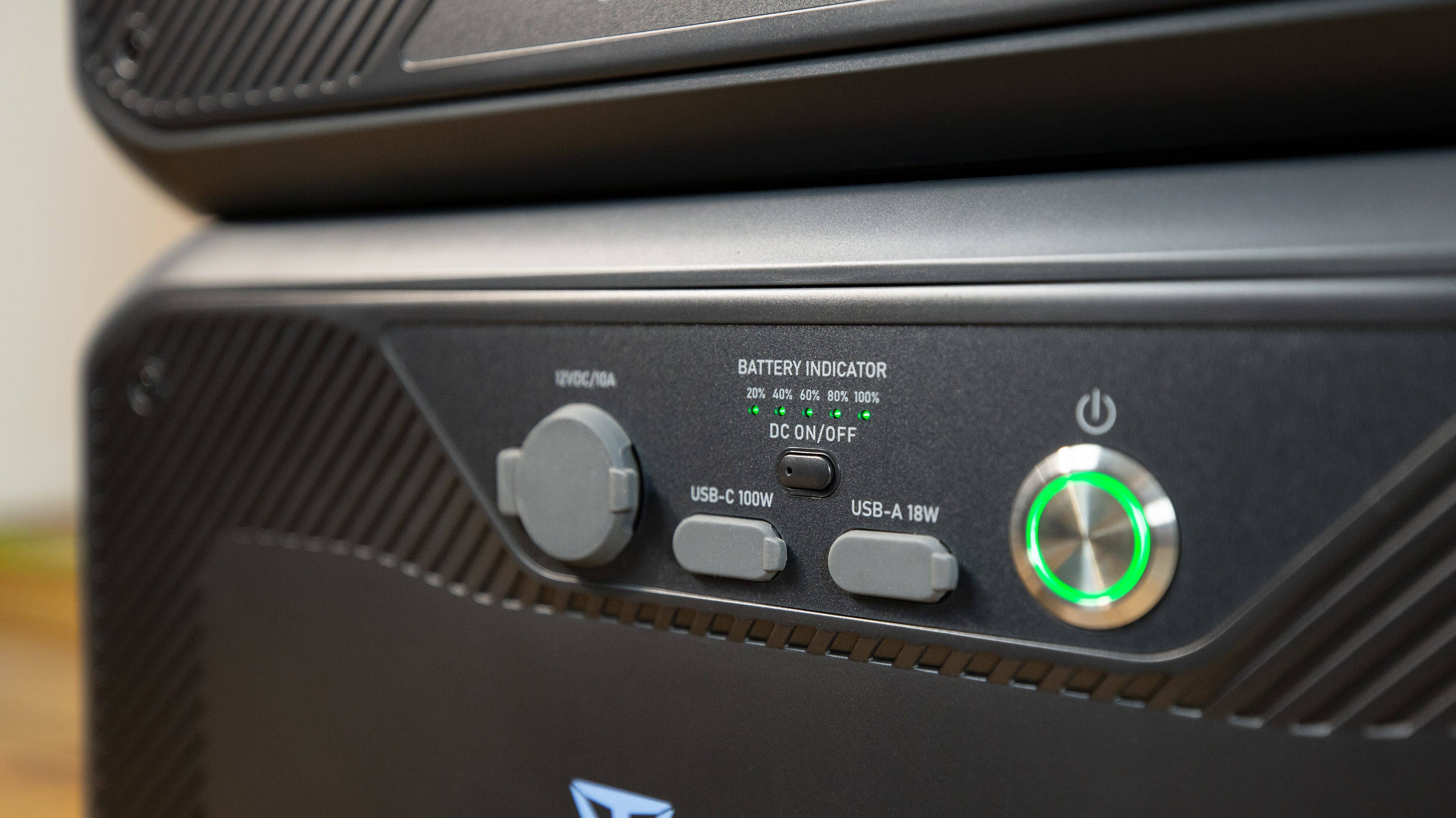

The B300s battery modules don’t have their own display, but at least they have a row of LEDs to indicate capacity – and a couple of outputs as well. / © NextPit Image source: NextPit

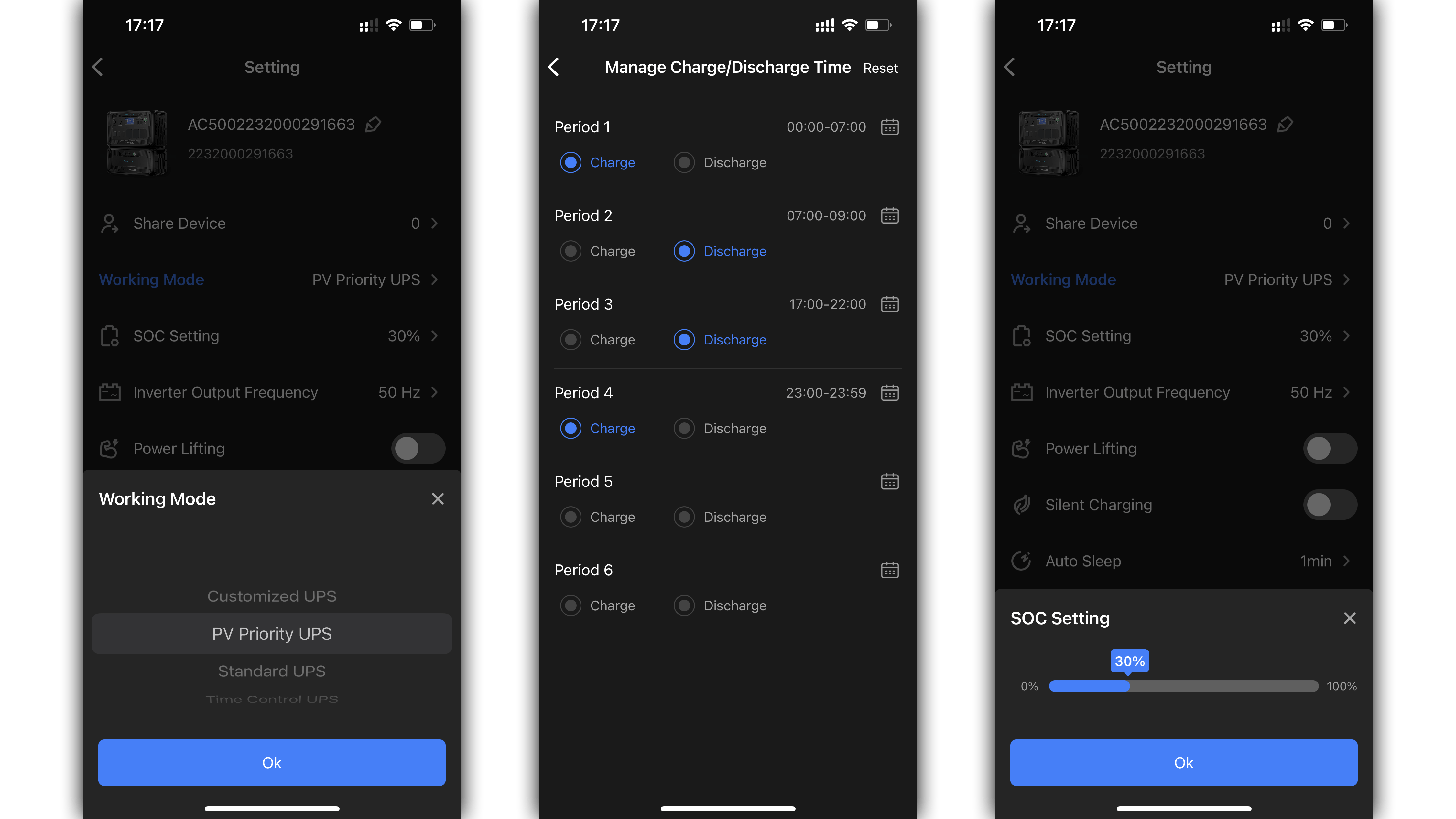

First of all, is it easy to use? You have two options to control the Bluetti AC500. One would be via the touchscreen, while the other is through the smartphone app. The options on both are exactly the same. Connecting the AC500 to the smartphone via Bluetooth is lightning fast, although there is no password protection or confirmation on the power bank itself. Therefore, we recommend activating the Wi-Fi connection and then deactivating Bluetooth. Otherwise, anyone within range can access your power station with the Bluetti app and, for example, turn the outputs on and off.

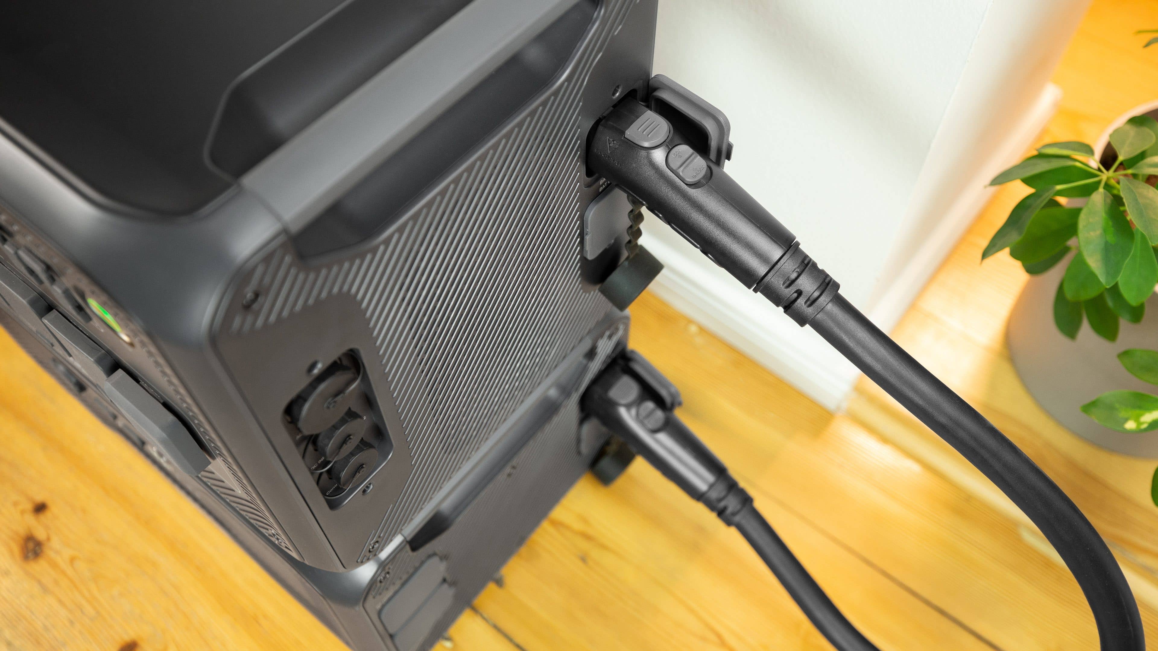

Connection between Bluetti AC500 and B300s: A lot of power goes through these fat cables! / © NextPit Image source: NextPit

The various operating options that the AC500 offers are also exciting. Like the EP500(Pro), for example, there are four operating modes here:
In standard mode, the power station always charges to 100 percent when connected to the mains. When the battery is fully charged, connected consumers are supplied with power via a pass-through. Should the power fail, the AC500 steps in as an uninterruptible power supply (UPS) and supplies connected consumers with power almost immediately. A simulated power failure in this way actually ran without any interruption in the NextPit review.
Bluetti AC500 App Screenshot
The Bluetti AC500 offers different operating modes depending on the application. / © NextPit Image source: NextPit
In addition, there are the two modes, “PV Priority UPS” and “Time Control UPS”, to choose from. In solar-power priority mode, you set a threshold on how long the AC500 is allowed to charge from the grid. The remaining capacity in the batteries is then available for the connected photovoltaic system and is therefore only filled by direct current. At the same time, however, you always have a certain capacity in the battery when connected to the mains, in order to be prepared for power failures. The time-controlled mode, on the other hand, always refuels and discharges the AC500 or the B300s batteries at certain times. Finally, in the “Customized UPS” mode, you can set all parameters according to your personal preference.
