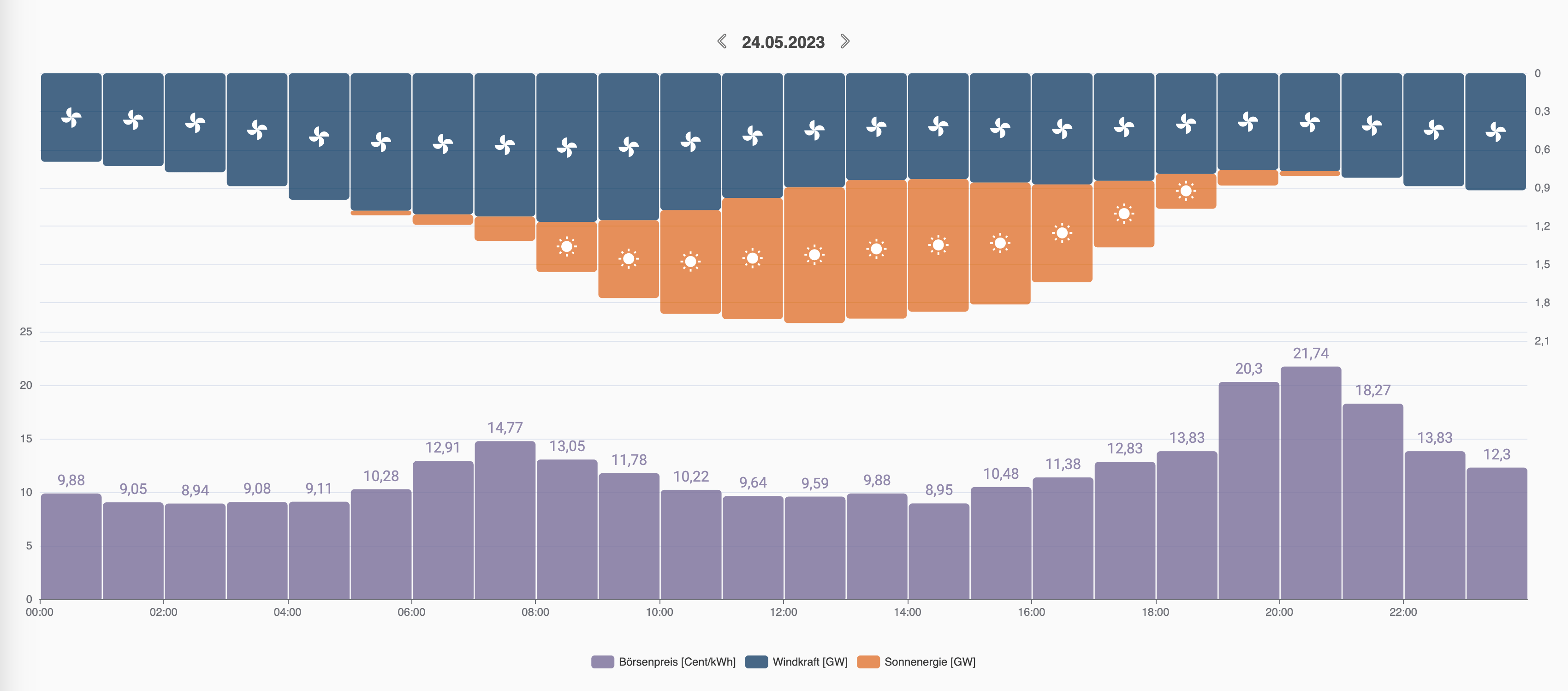

In Germany, electricity is traded on the EEX energy exchange in Leipzig; the prices, which vary by the hour, are determined in an auction at 12:00 noon on the previous day and announced from 12:40 onwards. The greater the share of renewable energies, the greater the fluctuations. We have to take advantage of this.

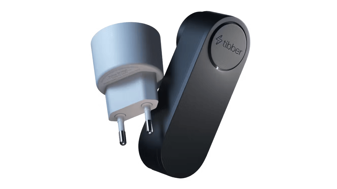

On the other side of the pond, however, there are already several providers of variable electricity tariffs, for example, the Berlin-based start-up Tibber. Here, customers pay a monthly base price, and all other costs are passed on directly—taxes, network fees, and so on are added to the actual EEX exchange price.
Such a tariff is the simplest and most direct way to get everyone involved. By rewarding energy consumption at the right time, it can be controlled—because if you participate, you can save a lot of money.

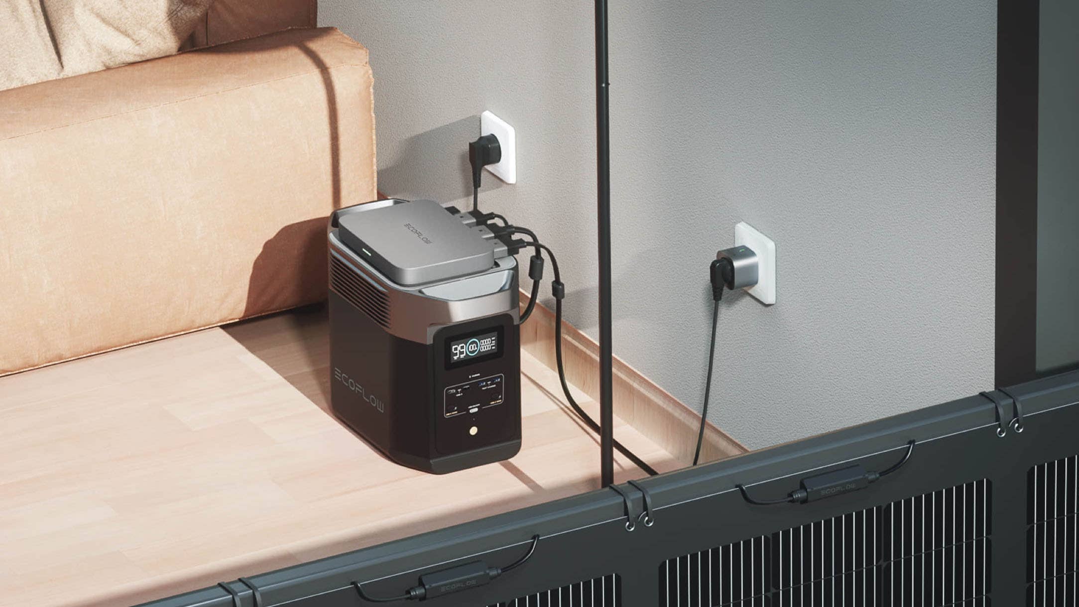

Even the power stations that have been so popular in recent years could be made available to the grid as storage. Thanks to increasingly widespread LiFePO4 technology, modern power stations can easily withstand a decade of daily charging and discharging—and could even earn the user money as part of a decentralized buffer storage system. All it would take is a battery inverter like the EcoFlow PowerStream to feed the stored electricity not only into the home grid but also into the power grid.
The startup Daylight.eco has exactly such a product in mind. In late summer of this year, the startup plans to launch a battery on the German market that does nothing but refuel cheaply and then feed the electricity back into the home grid later. Like a balcony power plant, the purchase is expected to pay for itself in just a few years, saving the user money and at the same time relieving the strain on the grid.

So what stands in the way of a grid that regulates itself smartly as a whole? We need the appropriate hardware across the board—in other words, at least digital electricity meters that, if necessary, log consumption on an hourly basis via an additional gadget like the Tibber Pulse. Unfortunately, the smart meters currently installed in the US, for example, vary a lot in terms of supported protocols, interoperability, and, as usual, regulatory issues.
