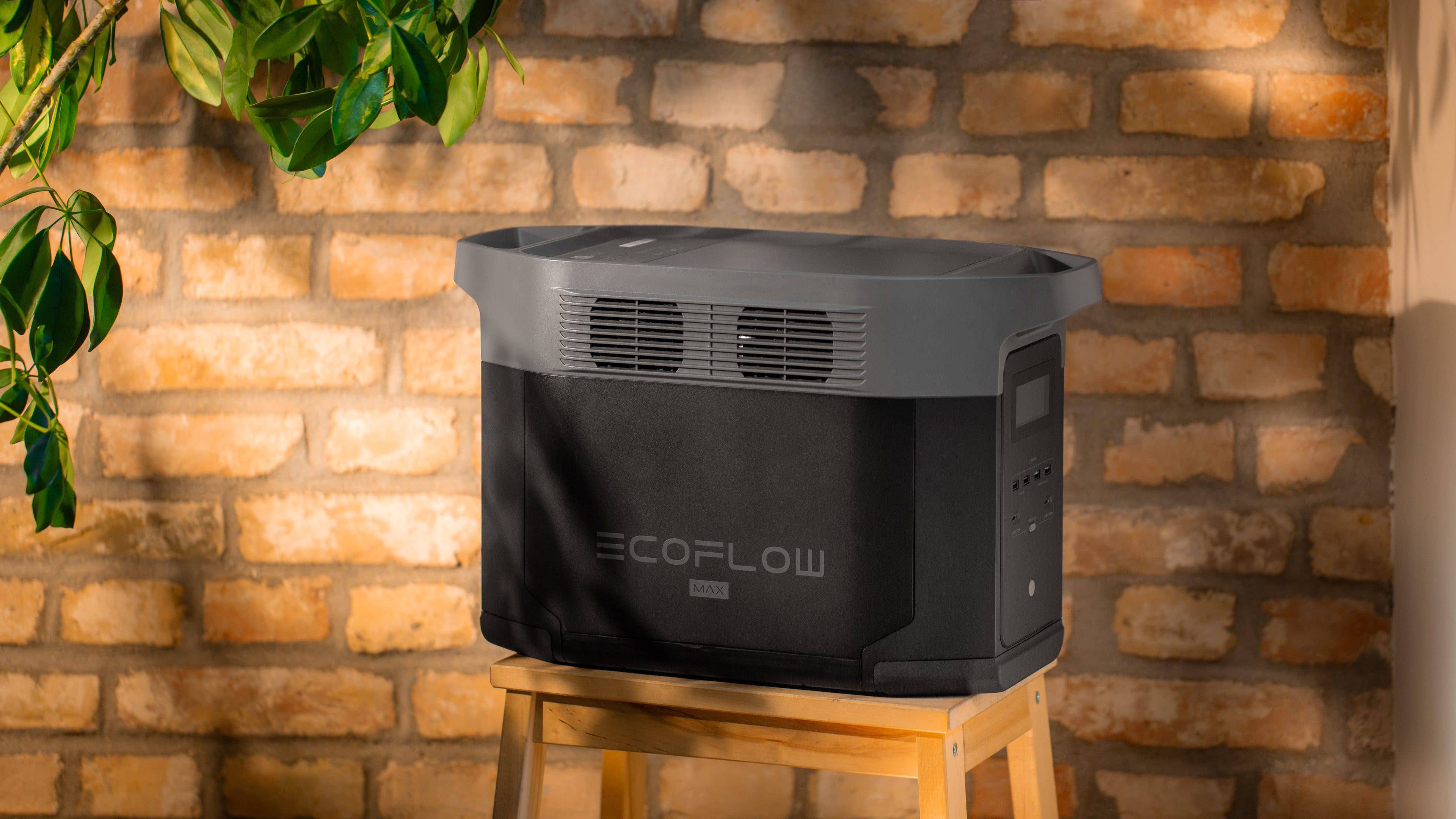

The EcoFlow Delta 2 Max is a robust power station with a timeless design. As usual, EcoFlow decided not to change the color design of the Delta 2 Max, retaining the plain gray-silver shade for the chassis. The power station measures 49.7 × 24.2 × 30.5 cm and tips the scales at 23 kg. The compact Delta 2 Max is bundled with an AC charging cable, a car charging cable, and a DC5521 to DC5525 cable with each purchase.

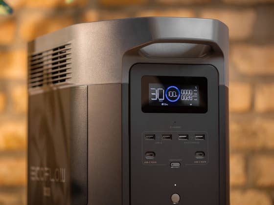

EcoFlow installed a small, clear screen on the front of the Delta 2 Max to show off important information at a glance. Below the display, there are four USB-A ports (2x 12 W and 2x 18 W) and two USB-C ports with a maximum power of 100 W per port. Let’s move on to the sides where you will find the inconspicuously mounted vents and two ports for additional batteries to increase the capacity by another 6 kWh if the need arises.

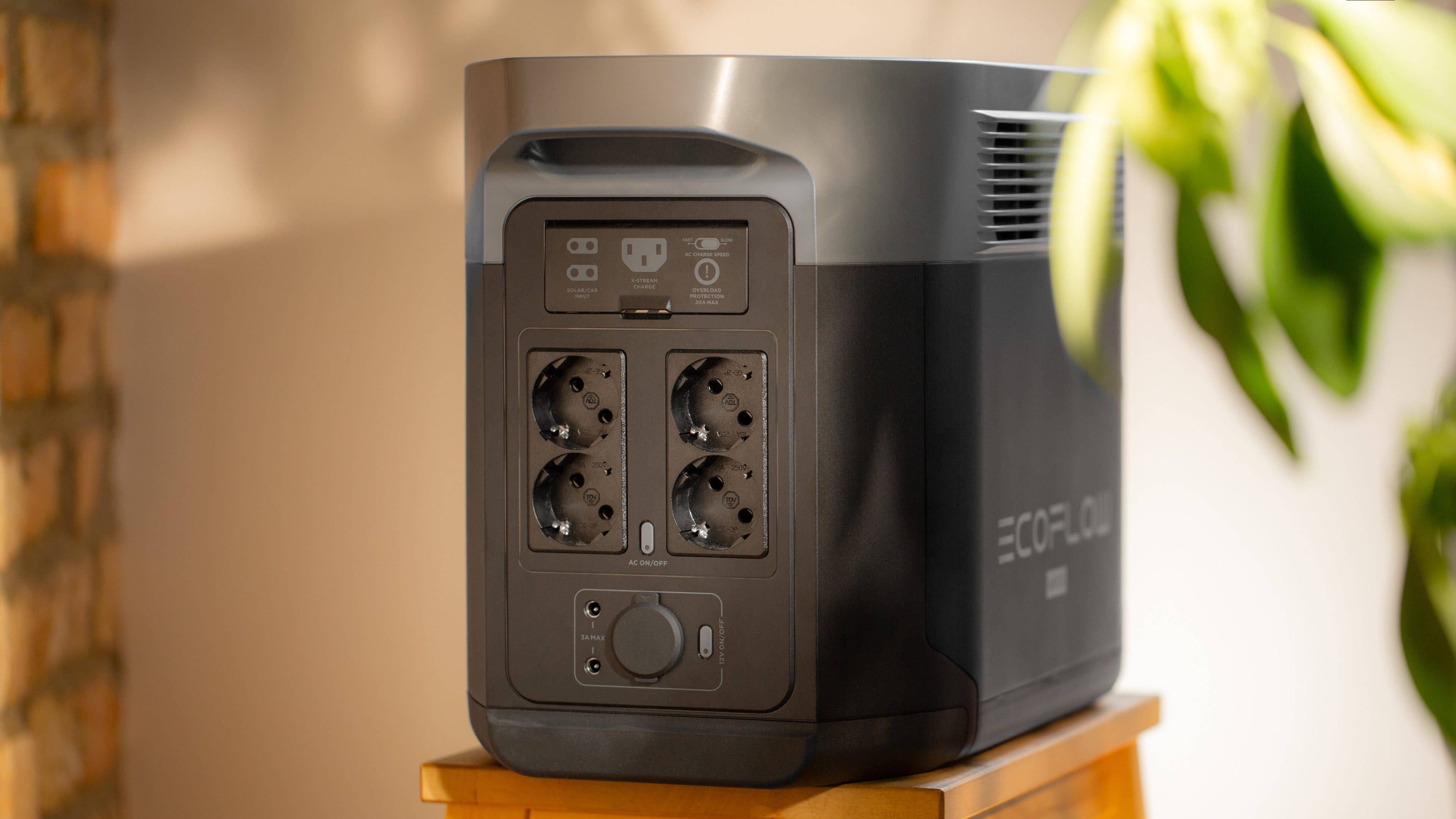

Finally, the rear sports four 230 V sockets, a couple of 12 V DC ports, and a cigarette lighter port. In addition, all the connections that will fill the Delta 2 Max with energy are located behind. You can charge the power station directly from a shockproof socket, connect up to two solar panels, or power the Delta 2 Max with your car—it is your call.
What else is there? EcoFlow has equipped the Delta 2 Max with a non-slip coated base. This means you do not have to worry about the power station slipping off the boat on your next trip out to the sea. The rubberized bottom is also an advantage when stowing the device in the car to keep it in place, with the only problem being the two protruding side handles that make stowing it away a real-life game of Tetris.

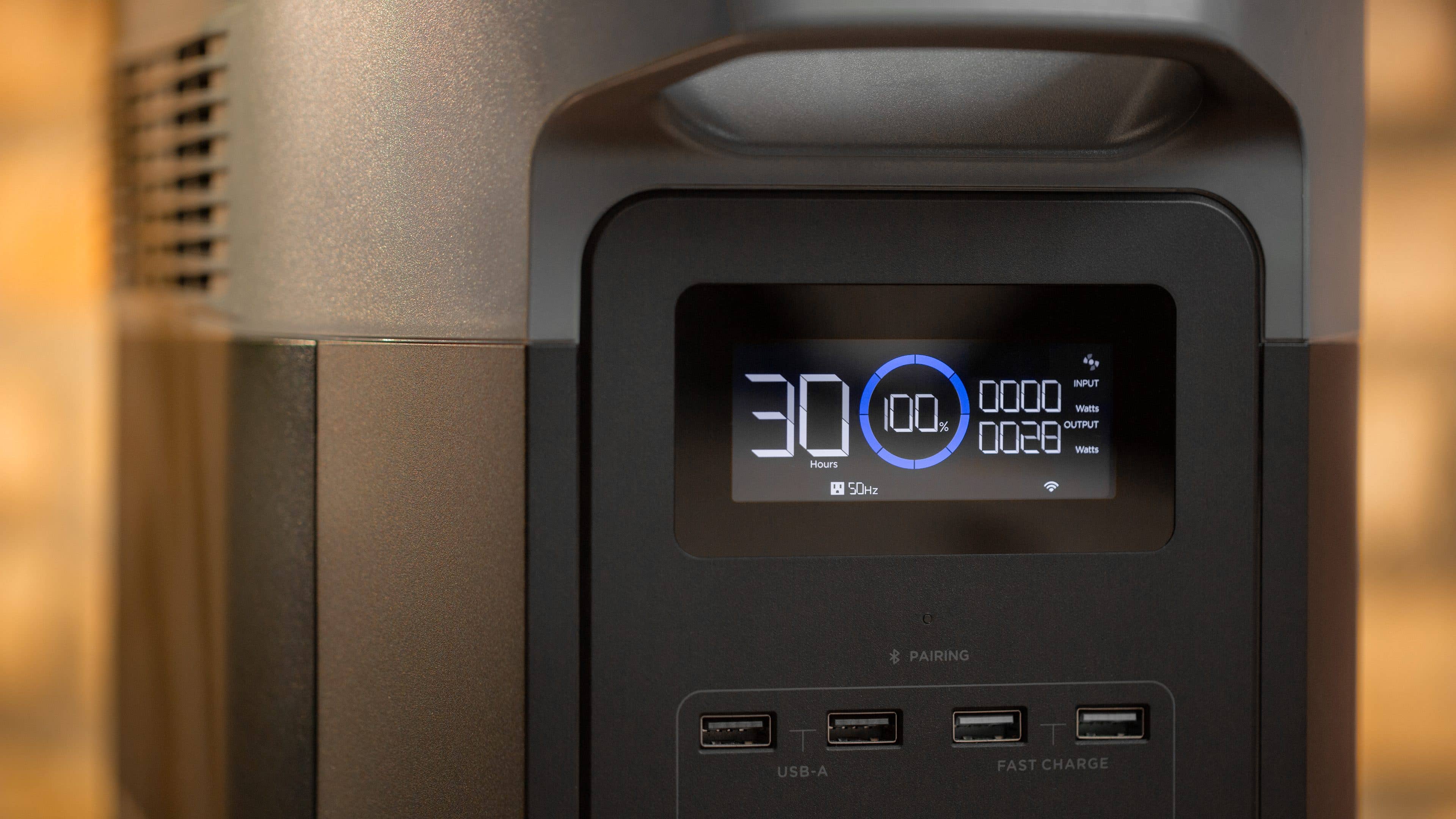

The small display always keeps you up to date on the power station’s status. It is here where you read the input and output power, see how long the charging process will take, and how long more can the connected devices be supplied power with  In addition, the EcoFlow app provides you with excellent software support to operate the power station.

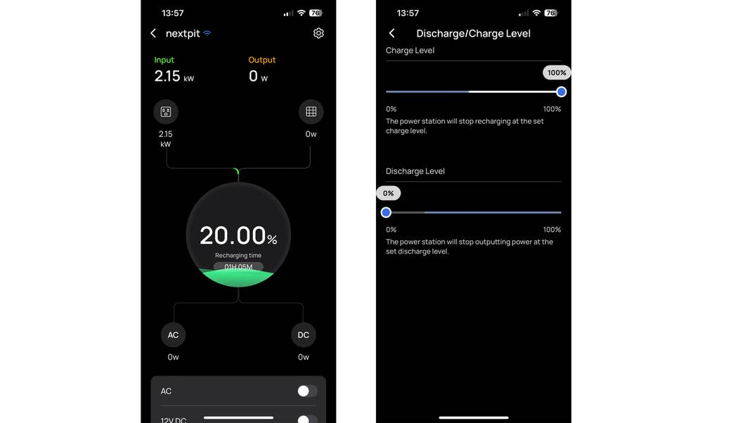

The setup in the EcoFlow app is a quick and simple affair. You first establish a Wi-Fi connection, scan the QR code that is located above the power station, or add the Delta 2 Max via Bluetooth in the EcoFlow app. The entire process takes a maximum of three minutes if you have your Wi-Fi password on hand.
Ecoflow Delta 2 Max app menus
The neat layout of the EcoFlow app shows you all the important information at a glance. / © nextpit Image source: nextpit

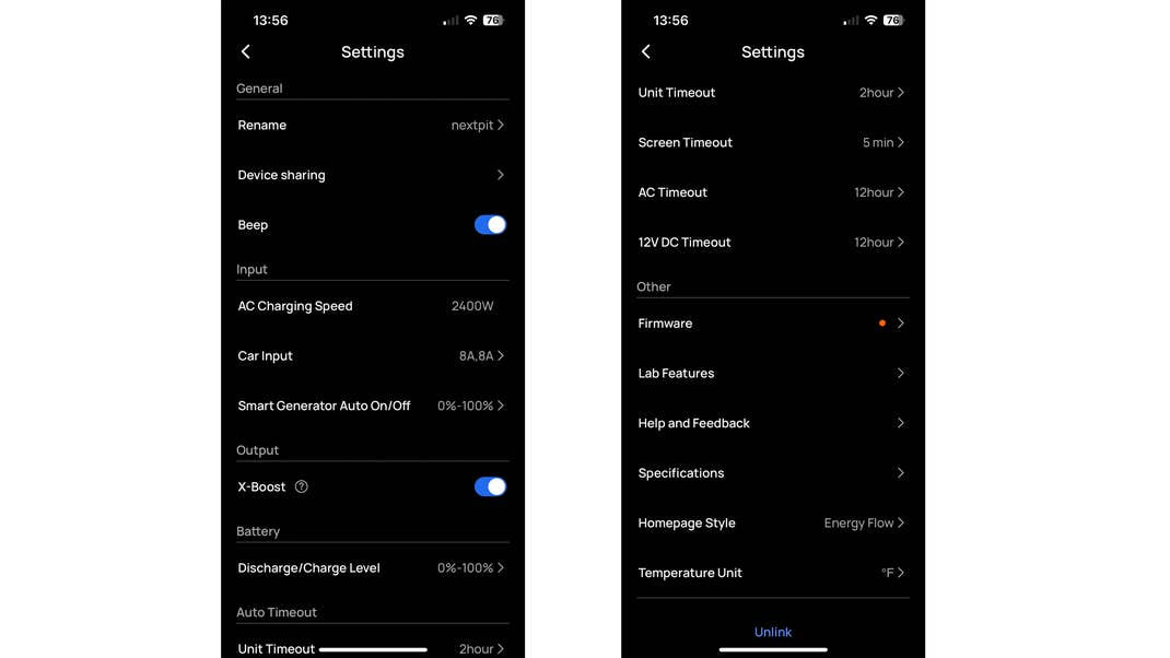

Once the Delta 2 Max is added in the app, you will be able to navigate easily thanks to the simple and clear design. Basically, you’ll see the same information as shown on the display, but you can dive into more detail for certain segments. For instance, you can specify the exact battery level the Delta 2 Max should be charged, and how much battery should remain in the reserves. This is a practical feature when it comes to the UPS function of the Delta 2 Max, but more about that later.
Last but not least, you can activate X-Boost. Doing so increases the output power from a constant 2,400 W to 3,100 W for a very short time, perhaps to cater to starting up a power-hungry machine. What can we say? The app is fantastic.
