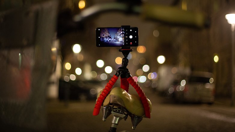

Night Mode with Tripod (including Realme, Oppo, and OnePlus)
Many manufacturers, including Apple or those from the BBK group, offer the option of activating a tripod mode in night mode. This mode will only provide useful results if you actually place your smartphone on a tripod—or at least lean it somewhere, clamping it, laying it down, or holding it against a windowpane or wall.
One more tip: If you use a tripod, activate the two-second self-timer. This prevents the photo from being blurred by pressing the shutter release on the display or by pressing the volume button.
Your smartphone does not have a tripod mode? No problem! In the next section on manual mode, we'll show you how to take control of ISO sensitivity and shutter speed—and make your photos look exactly the way you want them.
A smartphone mounted on a bicycle seat capturing a night scene with blurred city lights.
If you want to take photos in tripod mode, you should also have a tripod. The reward is noise-free and sharp photos in the dark. / © nextpit

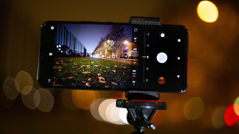

Shutter speed
The most important parameter for creative nighttime shooting is the shutter speed. It determines how long the camera "collects light". The slower the shutter speed, the brighter the image. However, as soon as the shutter speeds become slower than 1/10 to 1/20 of a second, depending on the performance of the image stabilizer, it is no longer possible to take sharp pictures by holding it in your hands. In this case, you will need a tripod or you have to lean the smartphone somewhere or press it against a wall to keep it very still.
A smartphone mounted on a tripod, displaying a night photography scene with blurred lights in the background.
Shutter speeds slower than 1/10 to 1/20 second require a tripod. At 1/5 second, it is already difficult to take sharp photos freehand. / © nextpit

ISO sensitivity
The ISO value determines how much your smartphone amplifies the captured photo. The higher the ISO value, the brighter the image. At the same time, however, a stronger degree of brightness also means more image noise. When it comes to the ideal image quality, ISO values should be set as low as possible.
Since the aperture is fixed on most smartphones, the ISO sensitivity together with the shutter speed controls the brightness of the image. Is your smartphone overexposing the photo at your desired shutter speed with the ISO value set to "Auto"? Then select a lower value manually.
If your smartphone doesn't allow manual adjustment of ISO sensitivity, there are several apps available, such as Camera FV-5 Lite (Android) or Pro Camera (Apple).
A smartphone mounted on a tripod displaying night photography settings with blurred colorful lights in the background.
ISO values in the range of 50 to 200 are usually sufficient for exposure times of several seconds. The photos are then beautifully noise-free. / © nextpit
