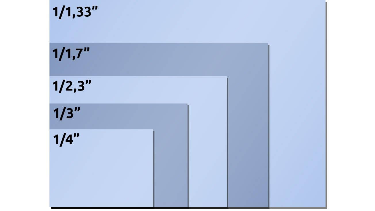

image sensor sizes
This graphic shows some of the sensor formats currently used in smartphones in a true-to-scale comparison. / © NextPit Image source: NextPit
Granted: the difference in smartphone image sensors is not quite as great as that between a shot glass and a paddling pool. But the aforementioned Sony IMX586 in the Samsung Galaxy S20 Ultra‘s telephoto camera is about four times larger in terms of area size than the 1/4.4-inch sensor in the Xiaomi Mi Note 10’s telephoto camera.

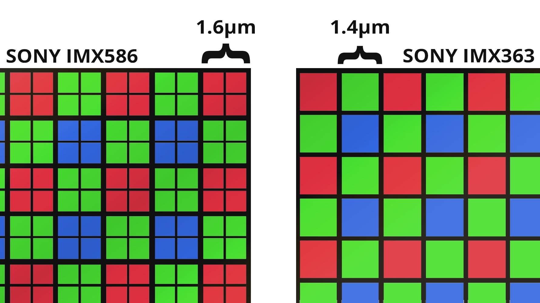

Quad Bayer and Tetracell
Whether it is 48, 64, or 108 megapixels, most of the current extremely high-resolution sensors in smartphones have one thing in common. While the sensor itself actually has 108 million buckets of water or light sensors, the Bayer mask above it has a lower resolution by a factor of four. So there are four pixels under each color filter.
image sensor pixel sizes quad bayer
Whether Quad-Bayer or Samsung Tetracell sensors: more and more image sensors have four pixels sharing one color filter. By the way, the pixel size is relatively insignificant to the image quality. A tiny sensor with a few but large pixels does not take great photos. And a large sensor can afford many small pixels at a gigantic resolution. / © NextPit Image source: NextPit
This, of course, looks incredibly great when specified on the datasheet. A 48-megapixel sensor! 108-megapixels! It is just ballooned figures to titillate the imagination. And when it’s dark, the tiny pixels can be combined to form big superpixels while delivering great night shots.
Paradoxically, however, many cheaper smartphones don’t offer the possibility of taking 48-megapixel photos at all – or even provide poorer image quality in direct comparison when in 12-megapixel mode. In all cases known to me, the smartphones are so much slower when taking pictures with a maximum resolution that the slight increase in quality is simply not worth the amount of time taken – especially since 12, 16 or 27-megapixels are completely sufficient for everyday use and do not exhaust your device’s memory so quickly.
Most of the marketing propaganda that pushes tens of megapixels into tripe digit territory may be ignored. But in practice, high-resolution sensors are actually larger – and the image quality ends up with noticeable benefits.

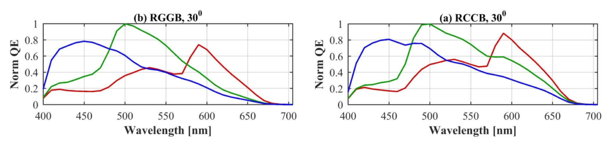

quantum efficiency rggb ryyb
Quantum efficiency diagrams show how sensitively different sensors react to light of different wavelengths. In the case of the RYYB or RCCB sensor on the right, the interval below the green or yellow absorption curve is therefore much larger. But the green-yellow pixels respond more to the “red frequency range”, which makes demosaicing more difficult. / © Society for Imaging Science and Technology Image source: Society for Imaging Science and Technology
However, the wavelengths measured by the sensor are no longer as evenly distributed in the spectrum and as clearly separated from each other as compared to an RGGB sensor. In order to maintain accurate color reproduction levels, the demands on the algorithms, which must subsequently interpolate the RGB color values, will have to increase in a corresponding manner.
It is not possible to predict which approach will produce better photos in the end. This largely depends on the practical and laboratory tests that tend to prove one or the other technology ‘better’.

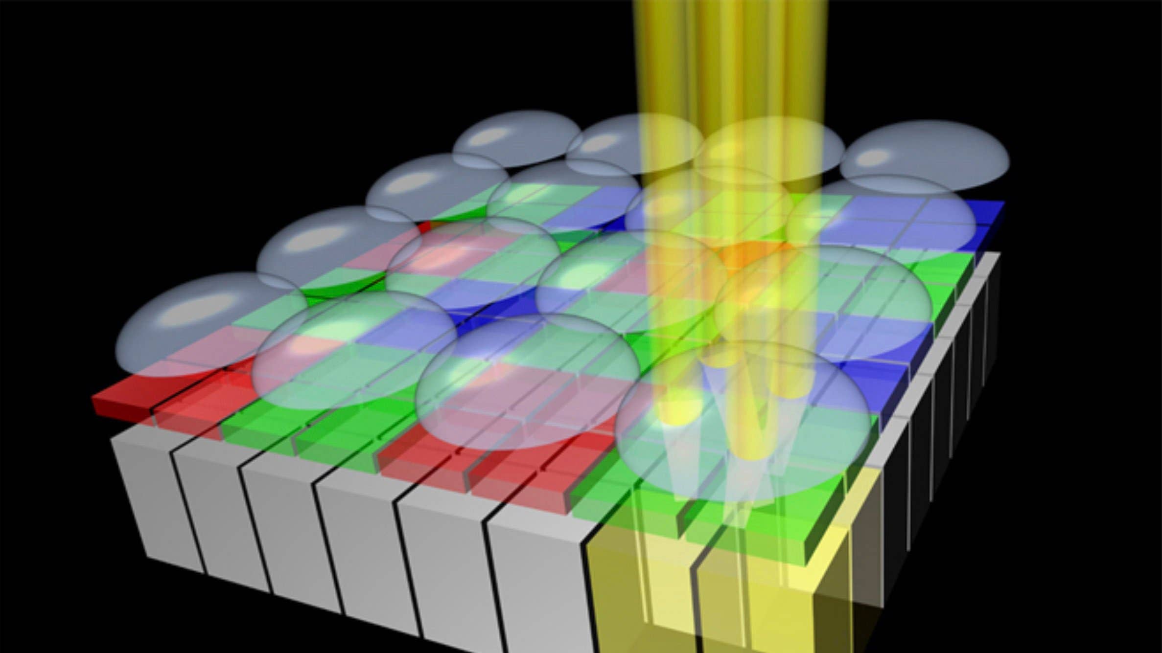

However, there is a more elegant approach that does not render pixels unusable. The micro-lenses already present on the sensor are distributed over several pixels in places. Sony, for example, calls this 2×2 OCL or 2×1 OCL, depending on whether the microlenses combine four or two pixels.
sony 2x2 ocl
Four pixels under a color filter in a microlens: Sony’s 2×2-OCL technology turns all pixels into autofocus cross sensors. / © Sony Image source: Sony
