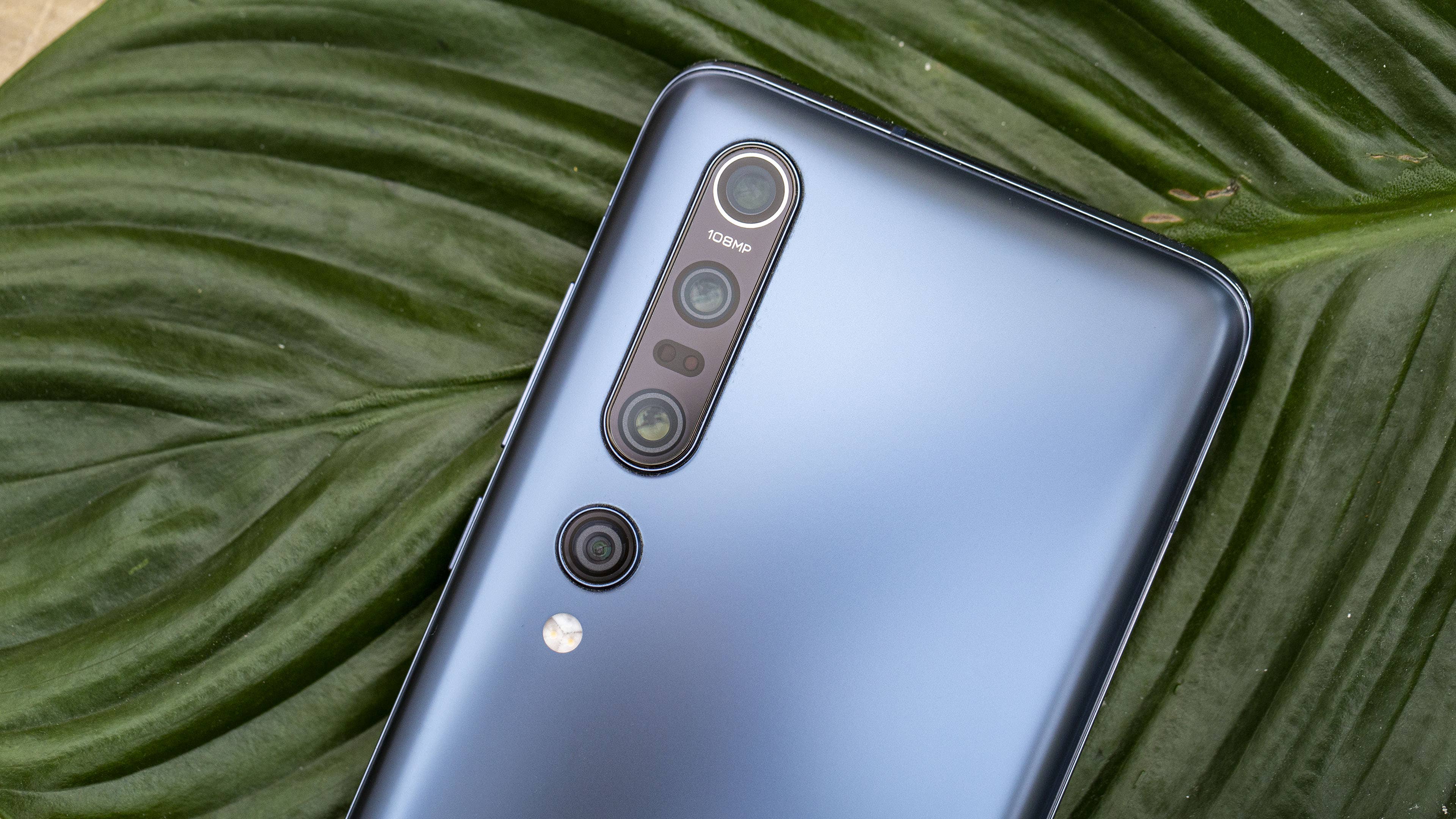

AndroidPIT xiaomi mi 10 pro camera detail
Looks large but these are far from a 12-millimeter entrance pupil: the Xiaomi Mi 10. / © NextPit Image source: NextPit
The reason for this is, the manufacturers always state the focal length that have been converted to the 35mm equivalent. Compared to a 35 mm camera, the real optical focal length of the smartphone lens system is far, far lower due to the tiny sensors. The diagonal measurement of a 1/1.7-inch sensor, for example, is 4.55 times smaller than a 35 mm or full-frame sensor. Similarly, a smartphone camera with a 1/1.7-inch sensor requires a focal length that is 4.55 times smaller to achieve a similar viewing angle.

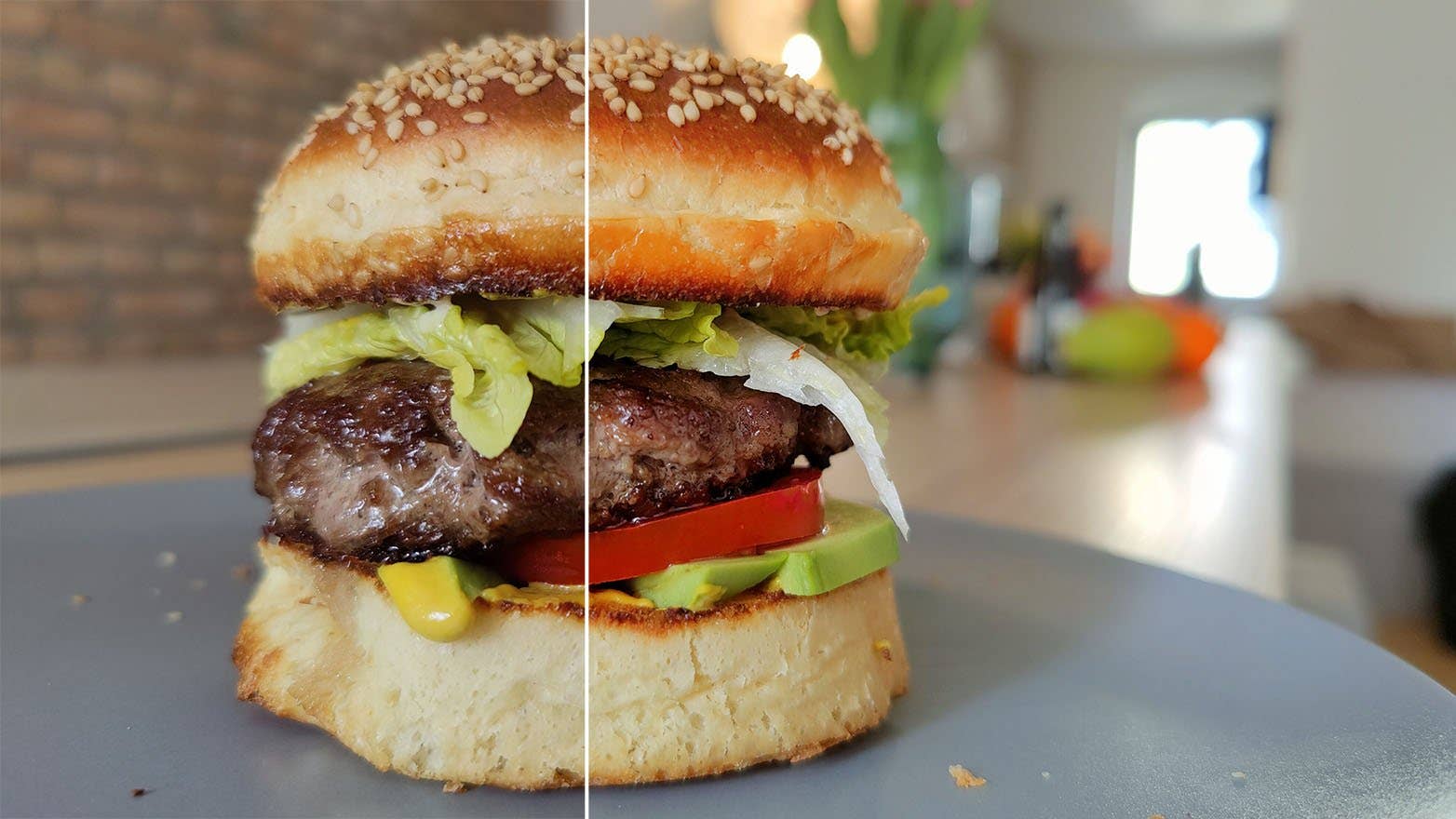

AndroidPIT oppo find x2 pro ai color dof issue
The recent increase in sensor size in smartphone cameras has been accompanied by an increase in the focal length, even at wide-angle. This results in a shallower depth of field, which in this photo from Oppo Find X2 depicts in the frayed burger. / © NextPit Image source: NextPit

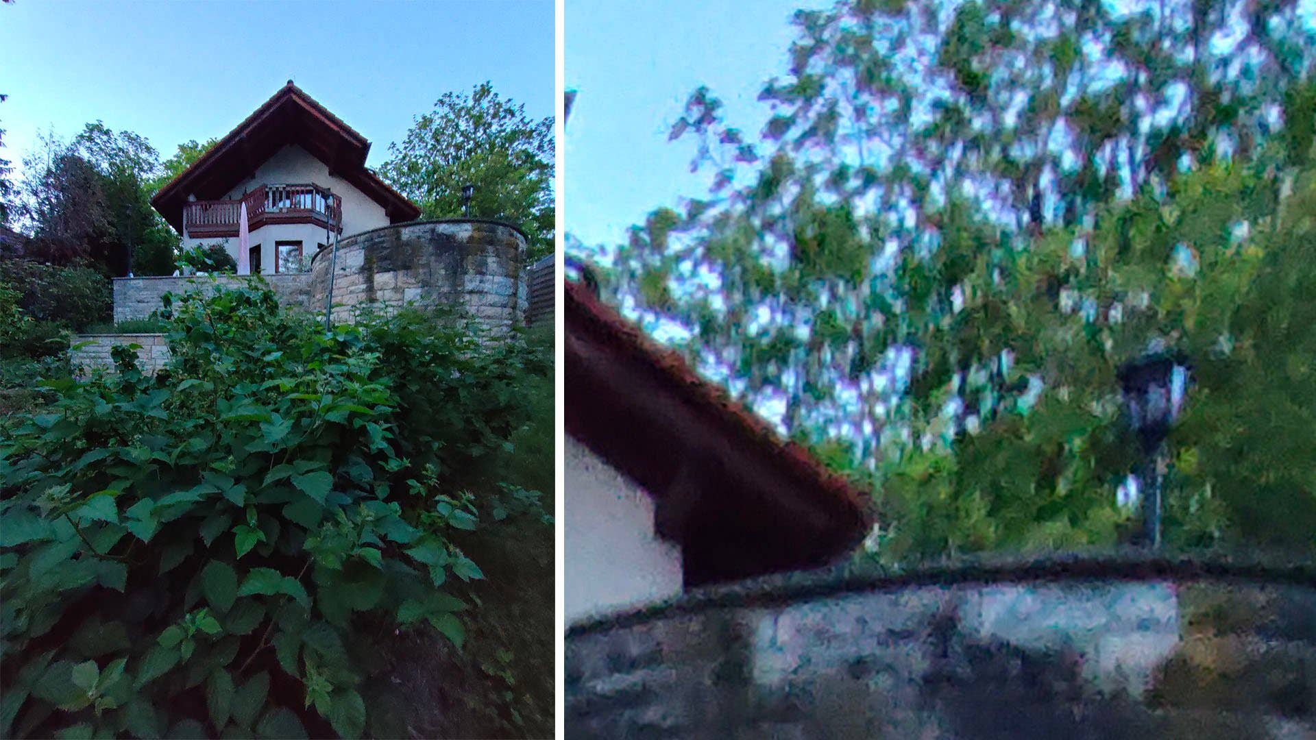

AndroidPIT realme x3 superzoom image quality wide angle low light
Nasty color fringes: Chromatic aberrations tend to be violet or green in color. The Realme X3 SuperZoom can do both simultaneously. / © NextPit Image source: NextPit
Unfortunately, light has the unpleasant property where refractive index is dependent on the wavelength. What sounds complicated can be easily explained via sunlight that reflects through the window and creating a rainbow in your living room. This phenomenon becomes stronger and stronger with a higher degree of light refraction, ergo a bigger aperture – and it becomes more and more complex to correct.
In technical jargon, the color fringes thus formed are known as “chromatic aberrations”. They are usually stronger at the edge of the image than in the middle and occur mainly at high-contrast transitions, e.g. on branches in front of a bright sky. In order not to oversell the specifications sheet by receiving poor reviews when it comes to photo-taking, Samsung has included a mechanical shutter in some of its flagship smartphones. This covers the edge of the lens under good lighting conditions in order to minimize such imaging errors.
