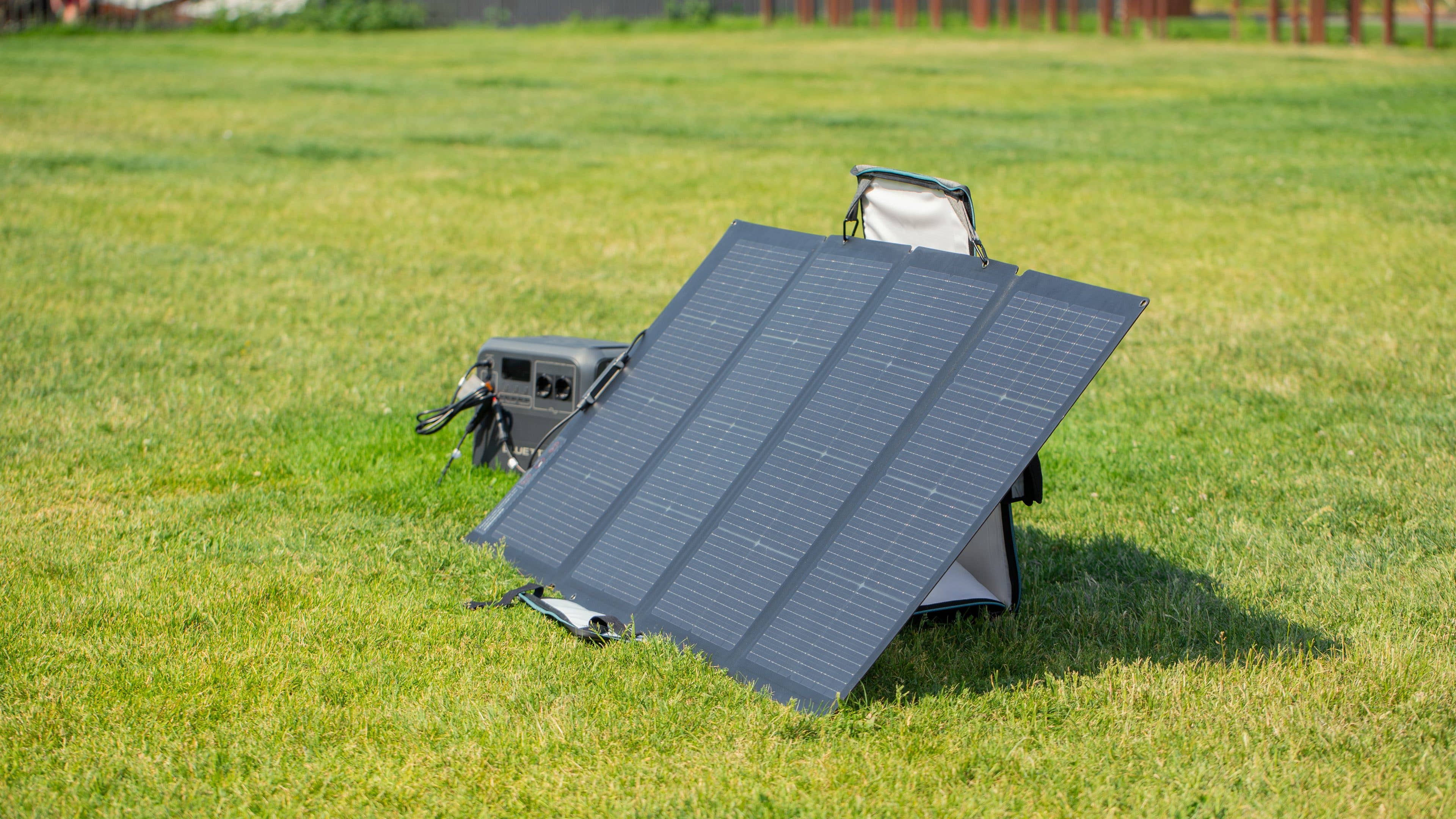

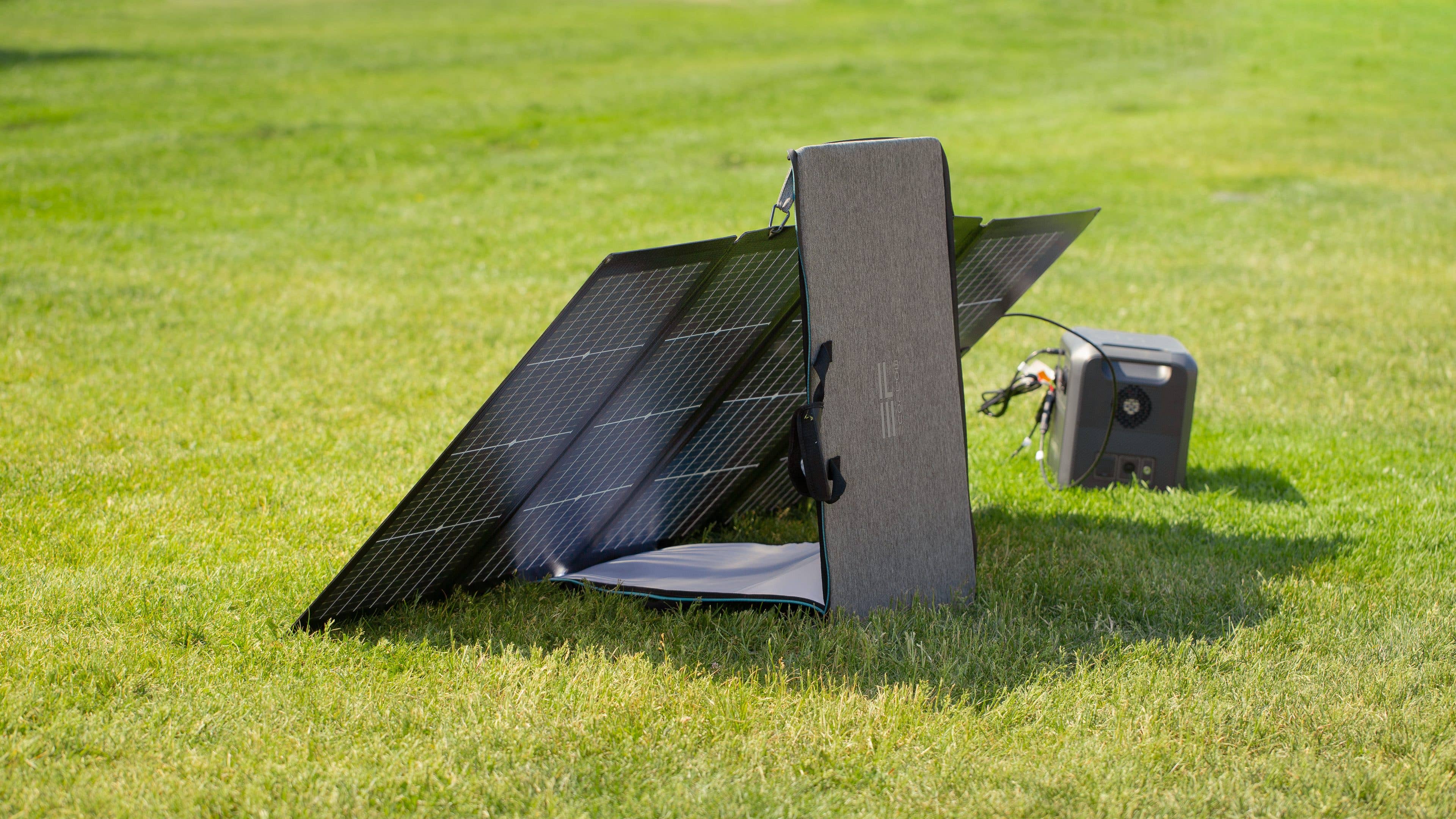

The solar panel tips the scales at 9.6 kg and can be easily transported thanks to the carrying bag. The panel does not have any feet. Instead, you can use the carrying bag as a holder for the solar panel when out camping or on your yacht.
The setup is simple and can be completed quickly without the help of another person: You only have to attach the panel to the carrying bag using two of the four included carabiners. However, the module makes a somewhat stiff impression during the setup process and when unfolding it. When fully opened, the solar panels take up quite a bit of space with dimensions measuring 82 × 182 × 25 cm.
The Ecoflow’s 220 W panel has fixed tilt angles unlike the Bluetti PV200 (review). In addition, the 220 W panel with the carrying bag—like most other foldable solar panels — is only moderately stable. If you are not tucked away in an area that is protected from strong winds, then I would highly recommend you secure the panel from flying away using the accompanying eyelets.
EcoFlow 220W Bifacial Portable Solar Panel
The carrying bag acts as a holder for the 220 W solar panel. / © nextpit Image source: nextpit

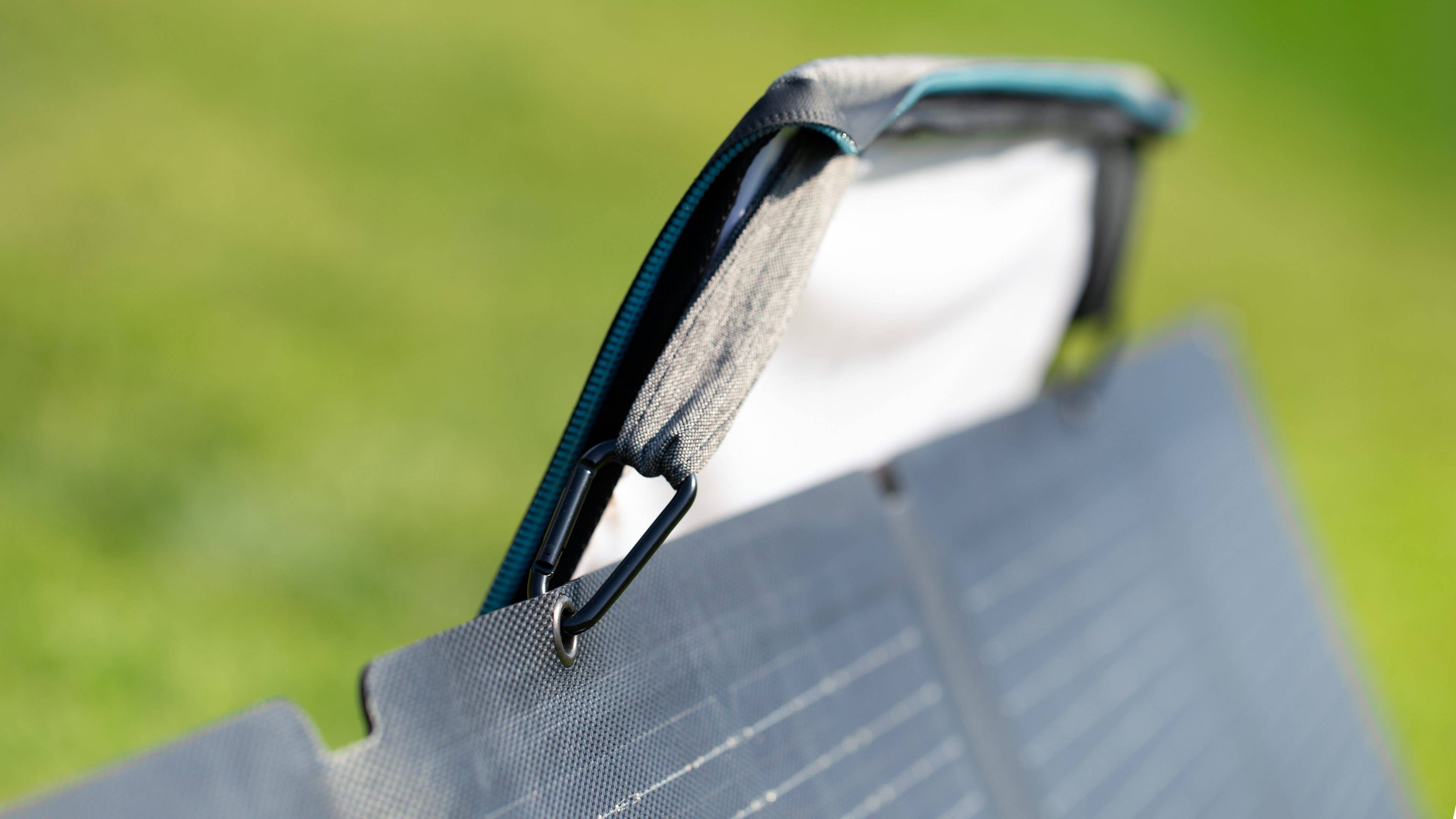

Ecoflow included four eyelets in the module, making the 220 W panel suitable not only as a mobile energy source on a camping trip but also as your balcony power plant. If you lack the necessary know-how, you should definitely read our guide on how to build your own balcony power plant.
Moreover, thanks to its IP68 certification, the panel can be exposed to rain without any issue and is also dust-resistant. Last but not least, Ecoflow attached its cables firmly to the panel and the 220 W solar panel relies on MC4 connectors. Ecoflow did not install additional charging ports, such as a USB port, in the panel.
The 220 W solar panel from Ecoflow has four eyelets. / © nextpit Image source: nextpit

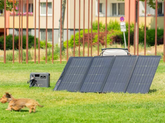

The 220 W solar panel from Ecoflow charged our review unit at 150 W all the way. At times, the power increased to 152 W. Just to compare: The Bluetti PV200 charges the AC180 at the same time with 157 W at peak, with short power drops to 154 W.
So, at such elevation, the Ecoflow panel has no power advantages over the Bluetti panel. Given the manufacturer’s mentioned conversion rates, we would have expected a bit more power from the Ecoflow panel at 220 W at 23% than from the Bluetti PV200 at 200 W and 23.4%.
One final note: At first glance, being 68 W below the rated power seemed to be rather disappointing. Nevertheless, when it comes to solar panels, you will have to bear in mind that the specified nominal power is the best possible result. Module orientation, increased material temperature, hazy skies, or other obstacles will always result in worse numbers. Normally, you achieve the best results shortly after midday in cold weather.
