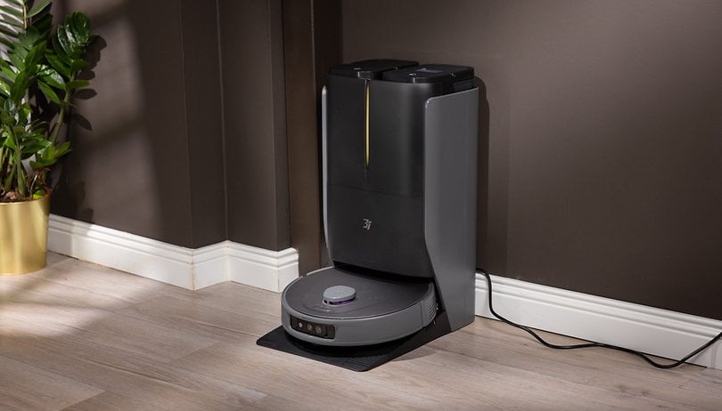

The 3i P10 Ultra is only available in one color variant. The appliance has a timeless gray tone. It measures 10 cm and has a navigation tower. Compared to other robot vacuum cleaners, the 3i model is significantly taller. To its credit, the appliance has an extendable side brush and an extendable mop. The base station is not the most compact on the market. It measures 31 x 46.8 x 59.4 cm, sporting a couple of water containers in the base station. There is also a 3-liter dust bag hidden behind the cover.

Once the cleaning tour is complete, the base station comes into play. It vacuums up the dust and takes care of washing and drying the mopping equipment. On top of this, the cleaning agent supply is added here. The solution is automatically added when the mops are cleaned.
