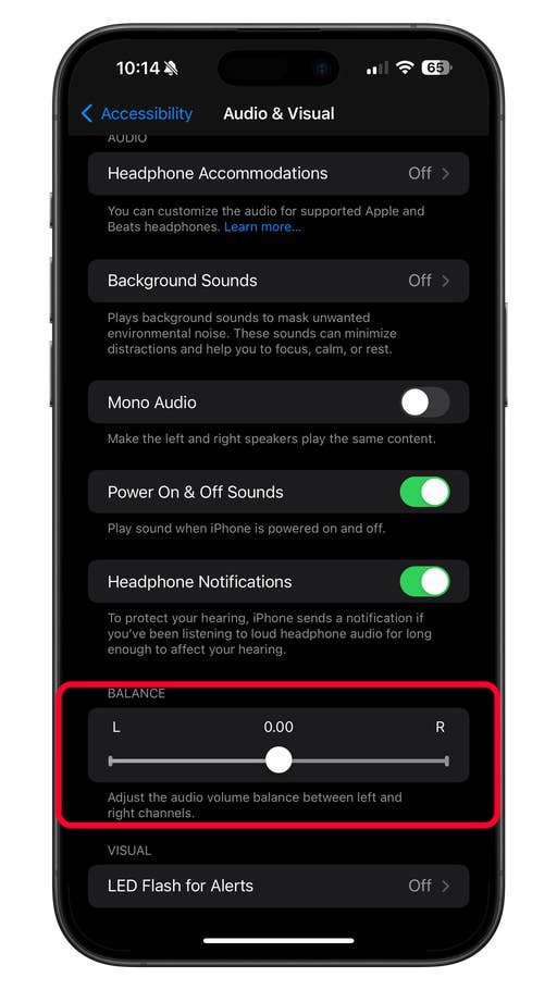

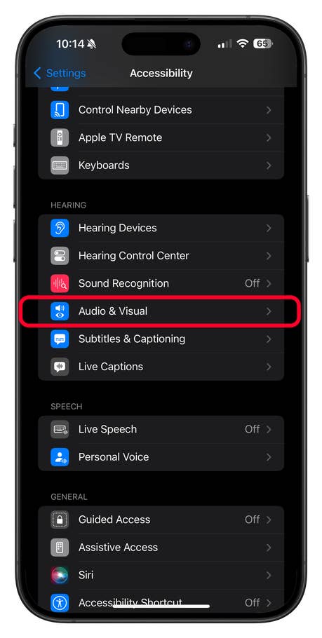

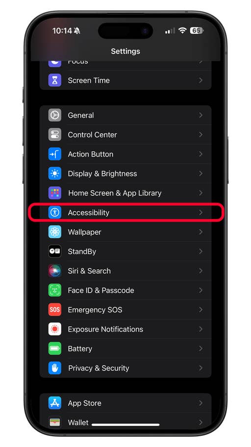

If changing the settings for call audio routing didn’t fix the silent voice calls on your headsets, there might be other culprits behind like having imbalanced audio channels. To that end, there might be instances when you are only wearing one side of the earbuds with a lower set of volume. So, you might check also if the volume between the left and right channels are on center, follow the steps below how.
  1. Go to Settings on your iPhone.
  2. Select Accessibility.
  3. Tap Audio & Visual.
  4. Look for Balance (slider) and bring it to 0.
  5. Exit to save changes.
Checking of audio volume balance for headsets
Open Settings and go to Accessibility on your iPhone
Quelle: nextpit
Checking of audio volume balance on iPhone
Go to Audio and Visual
Quelle: nextpit
How to check audio volume balance for iPhones
Bring the Balance to center
Quelle: nextpit
