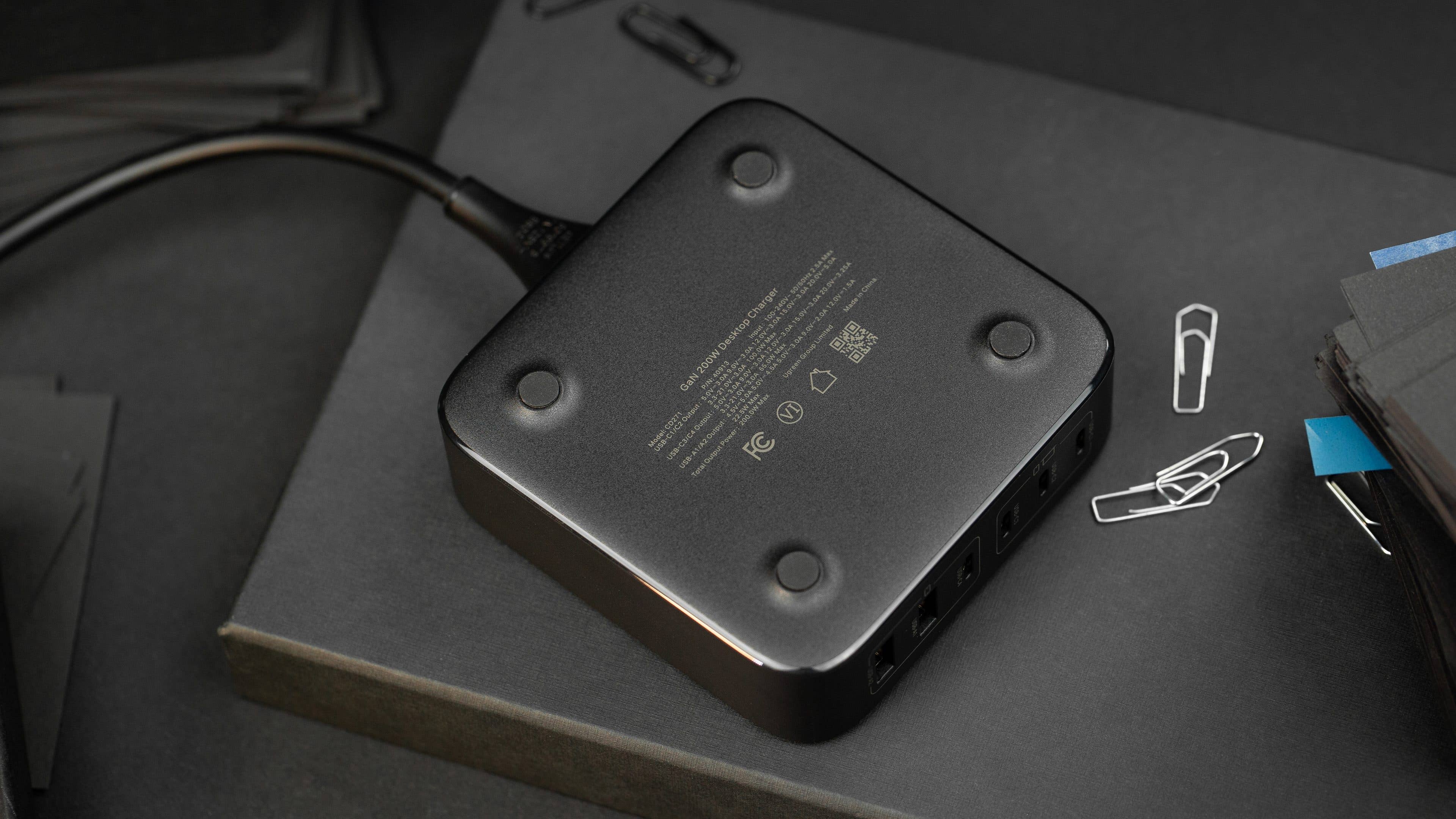

Underside of the Ugreen Nexode 200W charger with its certifications and specifications
The underside of the Ugreen Nexode 200W: Four plastic feet provide slip resistance. / © NextPit Image source: NextPit

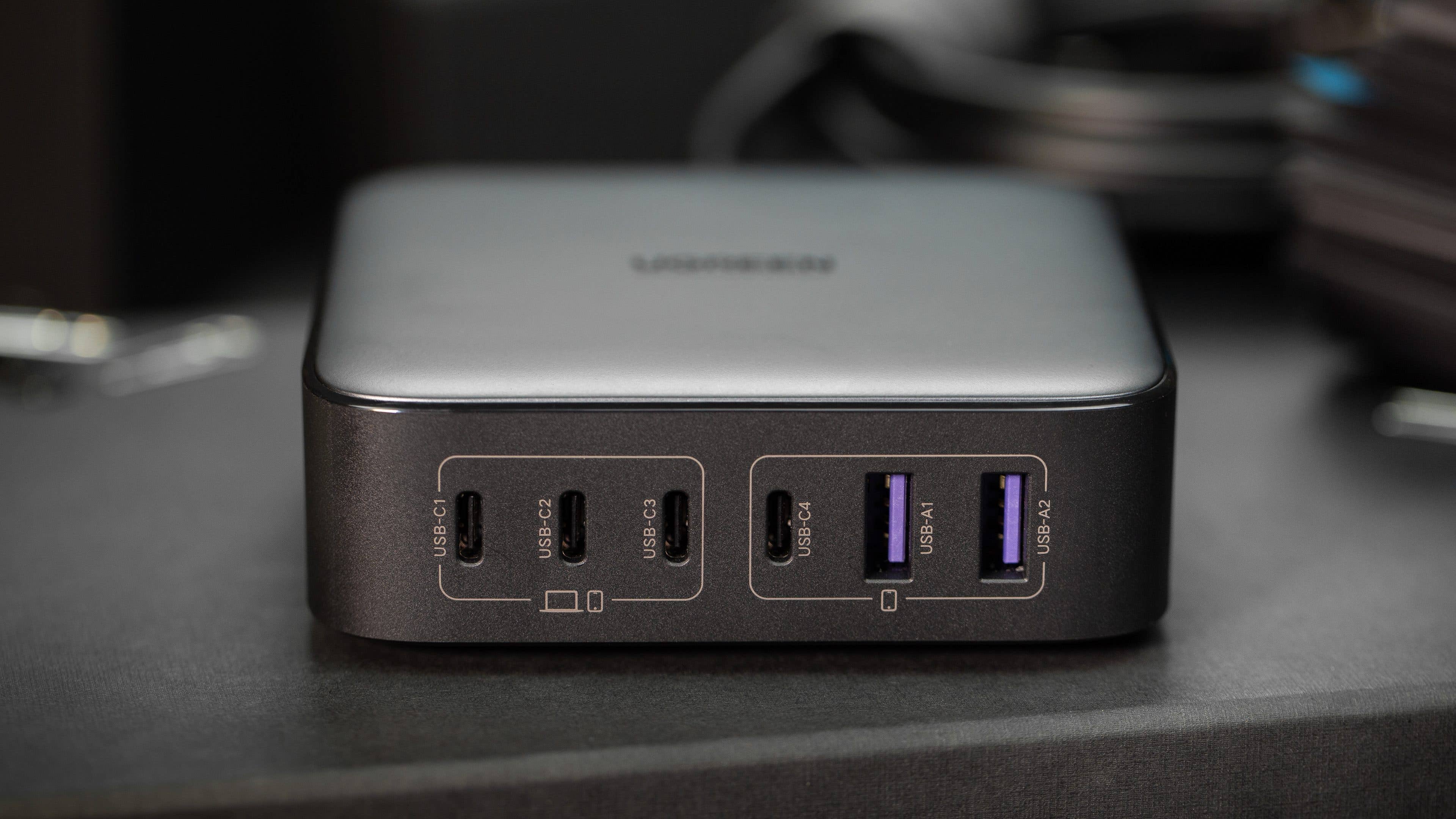

The technology is built into a solid plastic casing. To prevent slipping and guarantee a secure stand, four plastic feet are installed on the underside. There are a total of six ports on the charger’s front. The USB-C ports can handle up to 100 W, the USB-A ports up to 22.5 W. If all ports are used to the maximum, the output power is distributed as follows:
  • USB-C1: 65 W
  • USB-C2: 45 W
  • USB-C3: 45 W
  • USB-C4: 20 W
  • USB-A1 + USB-A2: 20 W
Ugreen Nexode 200W ports: 4 USB-C and 2 USB-A
The front of the Ugreen Nexode 200W offers many ports for many devices. / © NextPit Image source: NextPit

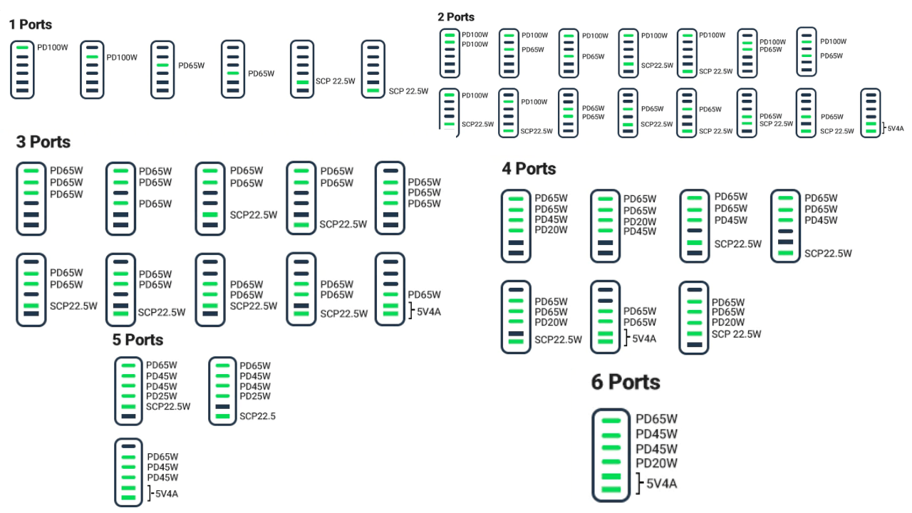

With the Ugreen Nexode 200-Watt Charger, you can charge up to six devices simultaneously , two of which could be laptops with a charging power of up to 100 watts each, for example. However, the output power varies depending on which slots are occupied. To help you figure out which power you can charge with which slot assignment, Ugreen has created a graphic that doesn’t look so clear at first glance. However, once you understand the system, everything is logical.
Illustration displaying the different power outputs according to the ports used
Ugreen’s cheatsheet for the Nexode 200 Watt Charger. / © Ugreen Image source: Ugreen
The attentive reader will have noticed immediately: As soon as more than two ports are occupied, the power of ports 1 and 2 drops from 100 watts to 65 watts. By the way, the values were more or less the same in the test. We used a power meter and connected various devices.
The biggest challenge was to find a device that can be charged with 100 watts via USB-PD. Manufacturers like Xiaomi, Oppo & Co. are capable of 100 W and more, but they use their own proprietary standards. Or the devices are charged at 65 watts or less. My MacBook Pro M1 is charged with around 62 watts via the Magsafe interface as well as via USB-C with Power Delivery. A 16-inch MacBook Pro can again be charged with the promised 100 watts (power consumption in the test: 95.4 watts).
Two notes at this point: The charging cable you use is also crucial for USB-PD. The cable has to be PD-capable so that the full power can flow. This requires the USB Power Delivery protocol: An integrated chip negotiates how much current is allowed to flow through the cable.

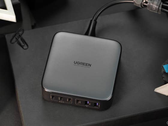

Ugreen Nexode 200W charger with all ports populated
Ugreen Nexode 200W Charger: Plenty of space for plenty of power. / © NextPit Image source: NextPit
Even though the Nexode 200W is not lightweight at around half a kilo, it reliably replaces the many chargers you usually carry around in a compact format. The device is especially useful for people who want to charge a lot of devices at the same time—and here, especially larger devices are included, such as power-hungry laptops. Otherwise, there are certainly cheaper options.
