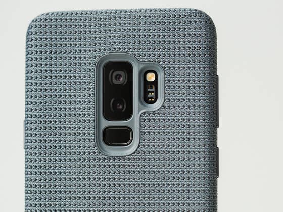

Let’s begin with the hardware: Samsung has actually given the camera in the Galaxy S9 and S9+ some new features. With a luminous intensity of f/1.5, the new flagship duo currently has the fastest aperture of all mobile phones. And apart from the Samsung W2018 reserved for the Asian market, the S9 and S9+ are the first smartphones to have a variable aperture. This means that the aperture ratio can be reduced to f/2.4 if required. But we’ll discuss that later in greater detail.
Under the f/1.5 lens there’s a sensor that is not specified by Samsung. Compared to the Galaxy S8, the sensor has grown a bit (at least according to EXIF data), and the crop factor is now 6.05 instead of 6.19, which corresponds to an increase in area of about 4.65%. The resolution is still 12 megapixels. The Galaxy S9+ also has a second camera, the same module that Samsung uses in the Galaxy Note 8, with an f/2.4 aperture and 12 megapixels. Both the wide-angle and telemodule have an optical image stabilizer.

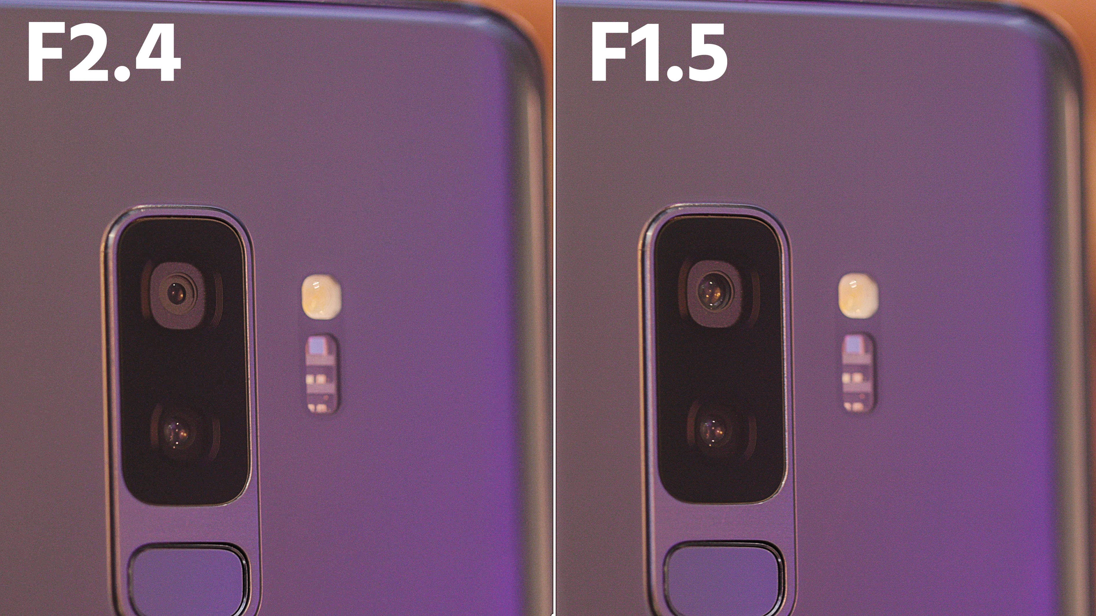

What does the variable aperture in the Galaxy S9 and S9+ do?
As soon as the new flagships detect more than about 100 lux, a small mask moves between the lens and the image sensor, shifting the aperture ratio from f/1.5 to f/2.4. 100 lux corresponds to the lighting typically found in corridors and stairwells in public buildings. But why does Samsung even bother? Because light is refracted to different degrees depending on the wavelength.
To be more precise, the lower the aperture ratio of an optical system, the more strongly the lenses are curved. Towards the edge of the lenses, the angle of refraction increasingly differs from the angle of refraction in the center of the image, and as with a prism, the light is fanned out according to the wavelengths of the colors. This causes spherical and chromatic aberrations. The spherical aberrations cause blurring, especially towards the edge of the image, and the chromatic aberrations usually manifest in the form of violet and green color fringes at transitions with great differences in brightness. The complex optical correction of these effects usually also plays an important role in the price of the camera lenses.
On the other hand, the tiny sensors in smartphones are still a good reason to install high-intensity optics. In low lighting conditions, the negative influence that high ISO sensitivities has on image quality is greater than the negative influence of a high-intensity lens. The difference between f/1.4 and f/2.4 is approximately one a half f-stops. This in turn usually allows the smartphone to shoot with ISO 1250 instead of ISO 3200, which significantly reduces noise.
In daylight, however, even a small sensor gets enough light, and the problematic peripheral regions of the lens are eliminated by dimming to f/2.4. As the preceding photo shows, this is really effective: the reproduction of details is much better at f/2.4 than at f/1.5, which is also noticeable in a direct comparison between the Galaxy S9 and Galaxy S8. On its predecessor, Samsung still used an f/1.7 aperture. In this case it’s also noticeable that despite better quality, the file size of JPEG images slightly shrinks.
