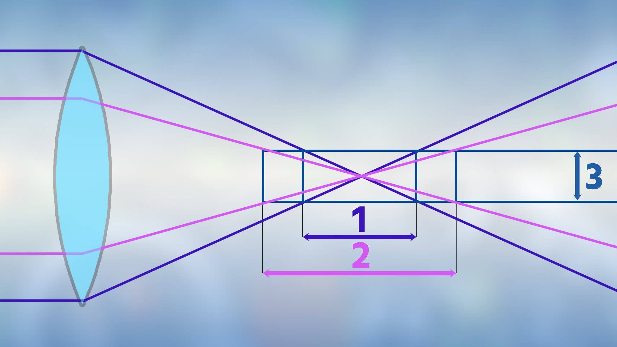

I would first like to start by explaining the concept of focus and blurriness and, to that end, consider a lens as one individual lens for simplicity’s sake. The greater the diameter of this lens, the quicker the rays drift apart in the beam path of the following graphic. As a result, objects outside of focus are no longer depicted in a punctiform manner but rather as an increasingly bigger circle as the lens diameter increases. As soon as one of these circles becomes greater on the sensor than a single pixel, the picture section in question is no longer in focus.
Apart from the lens’ diameter, the lens’ focal length also plays a role. The greater the focal length, the more selective the focus. What you may know as e.g. 24 or 26 millimeters from the datasheet is not the true focal length of the lenses; the 35-mm equivalent focal length is what’s specified here. It describes the focal length that the lens on a camera with a 36 x 24-millimeter sensor would need to have in order to achieve the same image angle as the smartphone’s lens-sensor combination. The real focal lengths of a smartphone’s wide-angle lenses actually range from 4.0 to 4.5 millimeters.
One thing is clear due to the mini-lens and the tiny focal lengths: The depth of field is always huge on smartphones, and it also doesn’t help that smartphones have a smaller circle of confusion than single-lens reflex cameras due to their tiny pixels. I have deliberately left out one influencing factor on the depth of field: the distance from the subject – the closer the distance, the more selective the depth of field. Most of you will have observed the effect on macro photos with a smartphone.

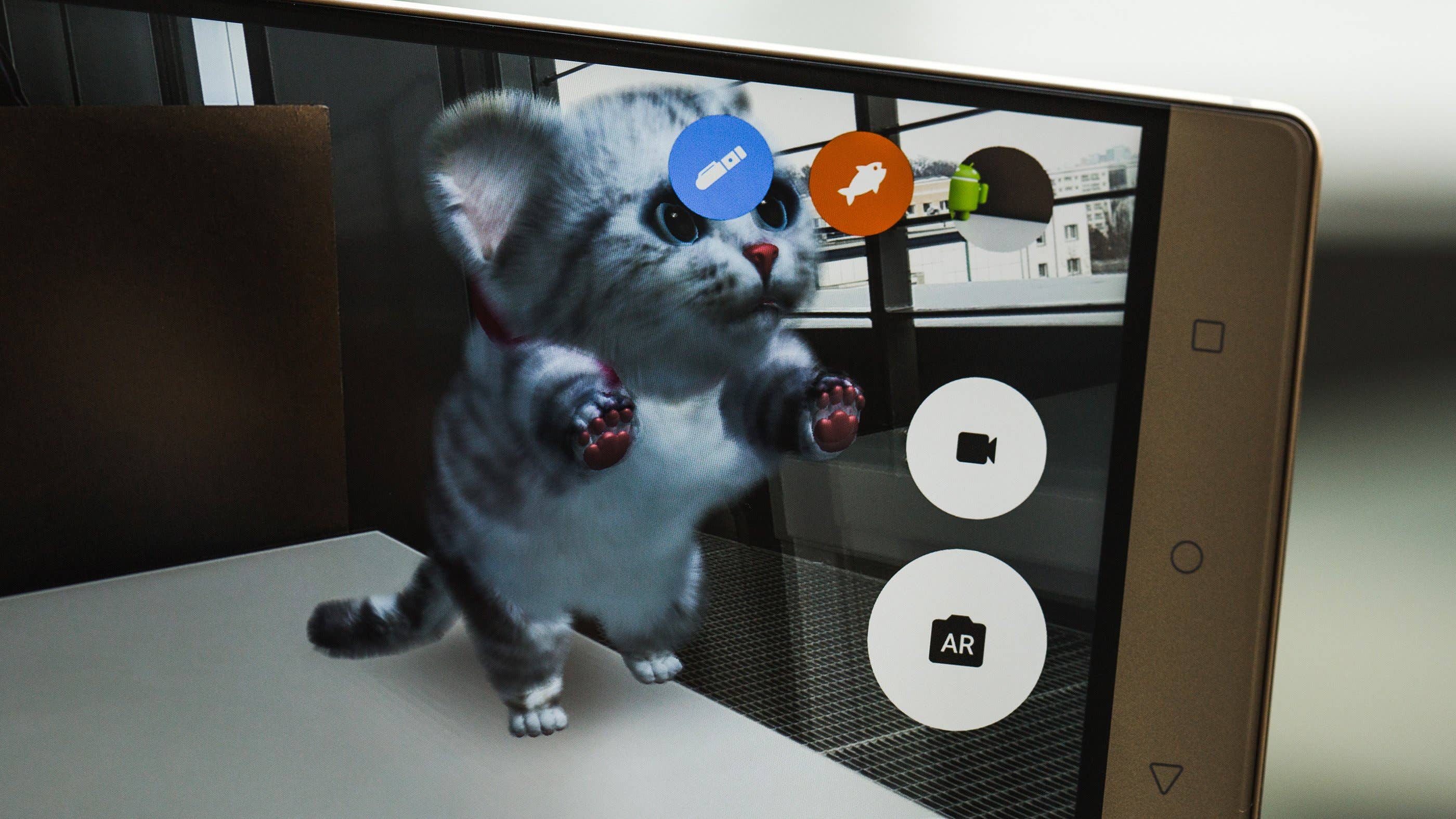

The Asus Zenfone AR and the Lenovo Phab 2 Pro, each of which have a time-of-flight camera integrated below the rear camera, take it a step further. In the process, they scan the room with an infrared laser, which once again provides increased range. This technology, promoted by Google under Project Tango, has not managed to gain a foothold so far. Elsewhere, we already made an extensive report on Time-of-flight cameras and Project Tango.
