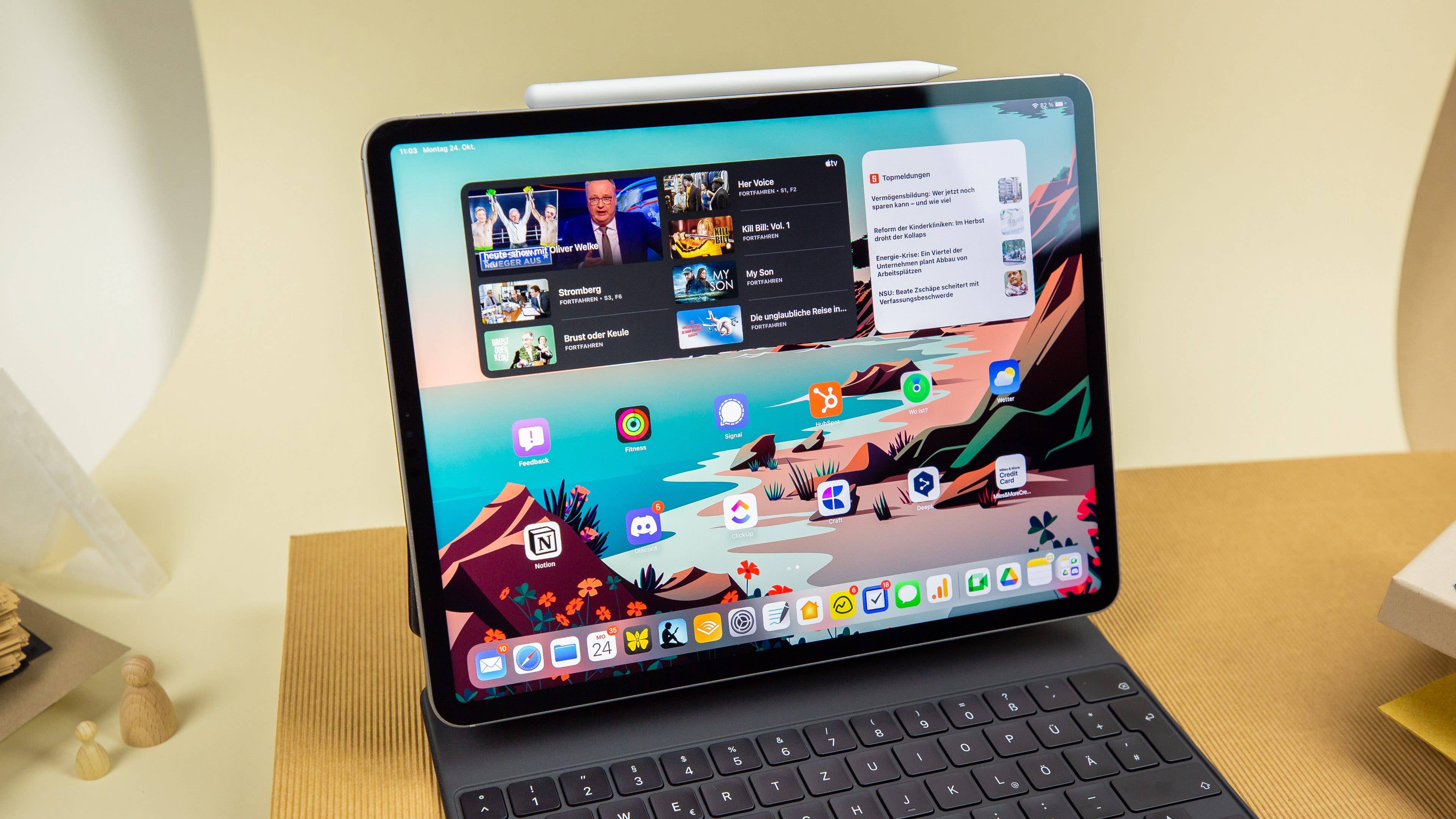

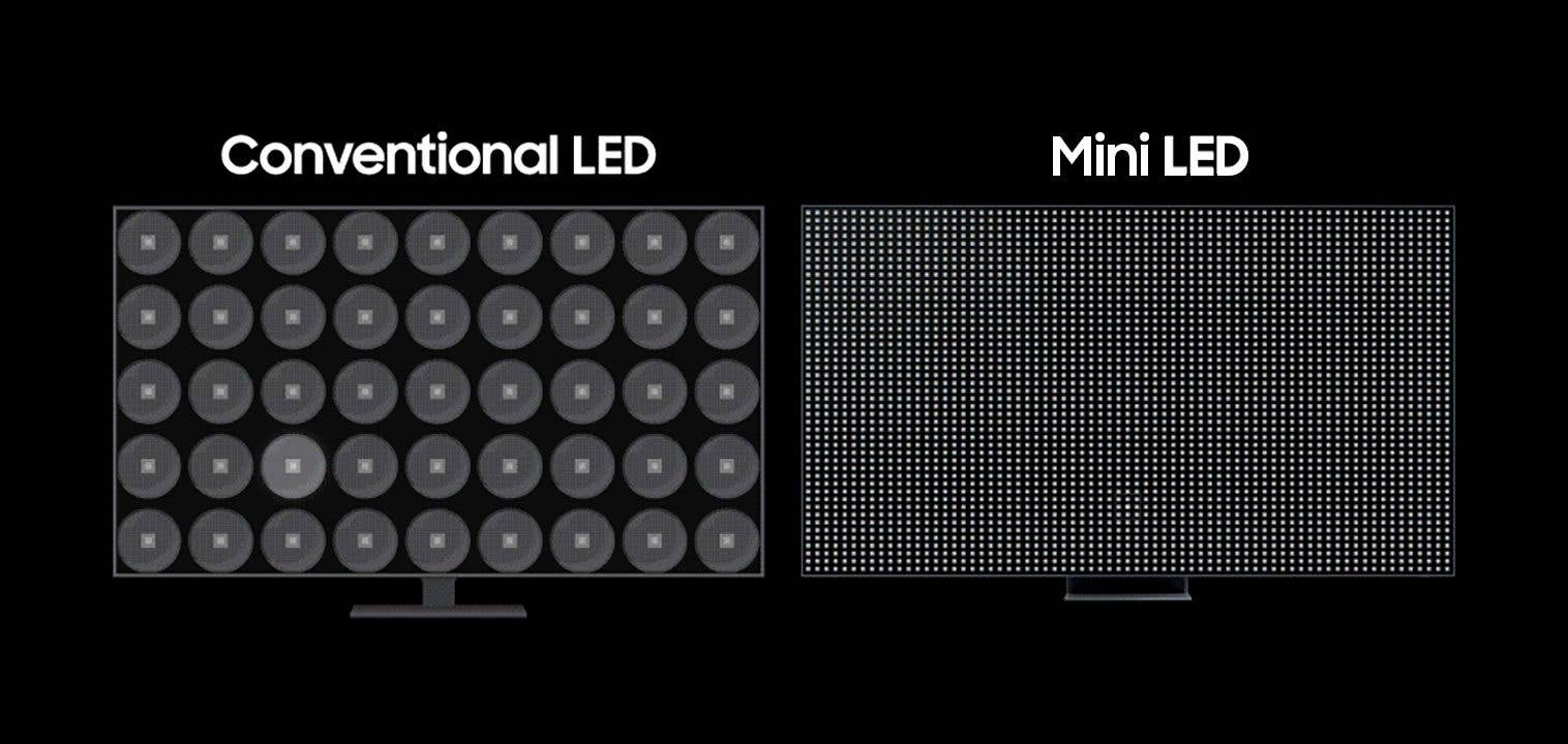

Mini LED: The new kid in town
Presented as the next-big-thing-Âź in 2021, Mini LEDs were first seen on televisions but soon reached mobile devices with Appleâs iPad Pro 12.9â (2021). Despite the marketing hype, Mini LED screens are basically LCD panels with more LEDs on the backlight.
The result is greater control over contrast levels in different areas of the display, with more backlight sections on the screen. Another advantage highlighted by Apple for the new iPad is a higher peak brightnessâup to 1,600 nits in HDR mode, versus 600 nits for the previous generation.
Despite the improvement in terms of contrast (and potentially brightness) over traditional LCD/LED displays, Mini LEDs still divide the screen into brightness zonesâover 2,500 in the case of the iPad and some âQNEDâ TVs from LGâcompared to dozens or hundreds of zones in previous-generation FALD (full-array local dimming) displays, on which the LEDs are behind the LCD panel instead of the edges.
However, for even greater contrast control, done individually at each point on the screen, it is necessary to go to panels equipped with microLED technologiesâstill cost-prohibitive in 2021âor OLED.

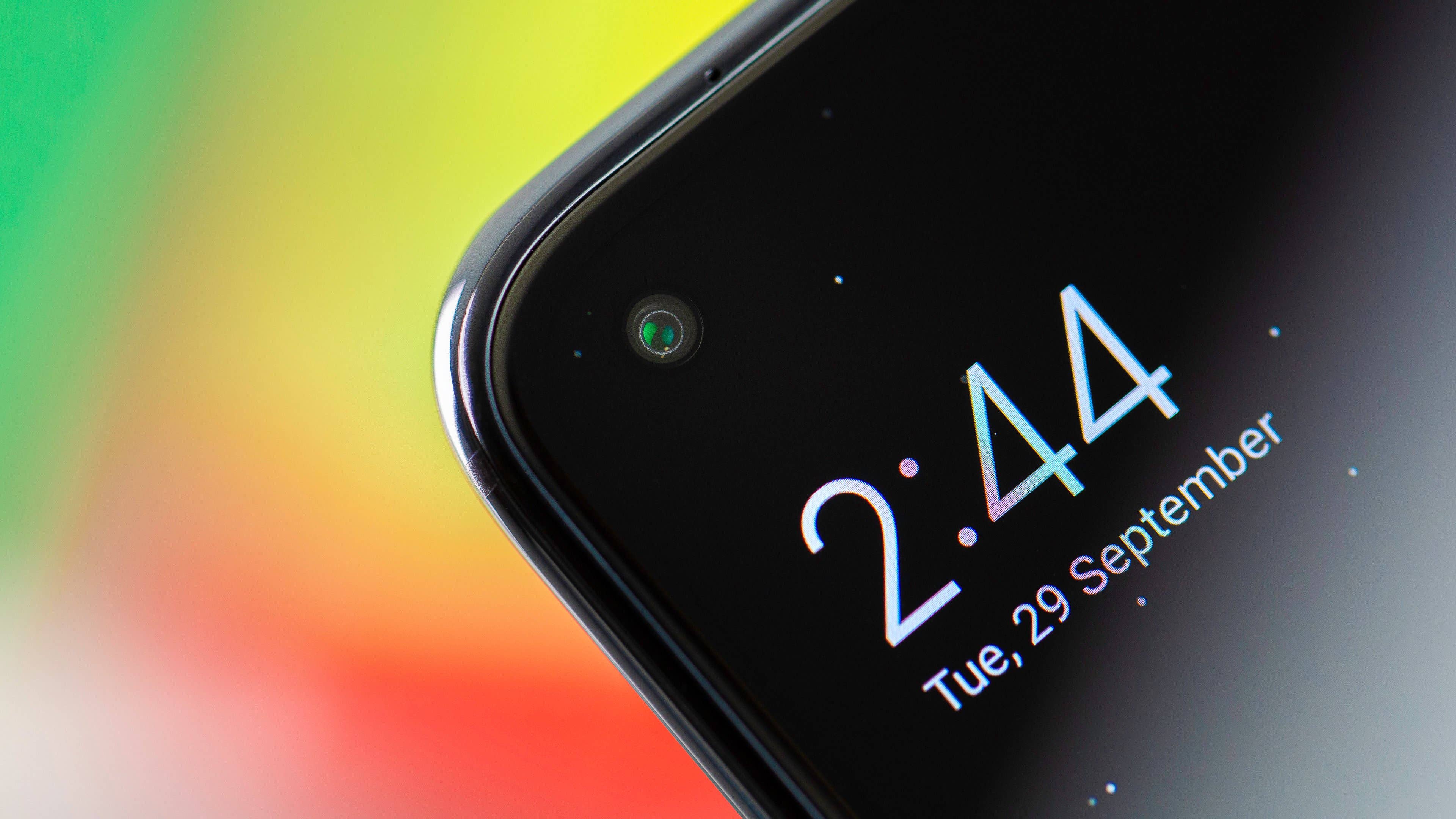

OLED screens
OLED stands for Organic Light Emitting Diode. An OLED display is comprised of thin sheets of electroluminescent material that, as the name implies, emits light when a current is passed through it. As opposed to LCD panels, which are backlit, OLED displays are âalways offâ unless the individual pixels are powered.
This means that OLED displays have much purer blacks and consume less energy when black or darker colors are displayed on-screen. However, lighter-colored themes on OLED screens use considerably more power than an LCD using the same theme. OLED screens are also more expensive to produce than LCDs.
Because the black pixels are âoffâ in an OLED display, the contrast ratios are also higher compared to LCD screens. OLED displays can have a very fast refresh rate too, but on the downside are not quite as visible in direct sunlight as backlit LCDs. Screen burn-in and diode degradation (because they are organic) are other factors to consider.

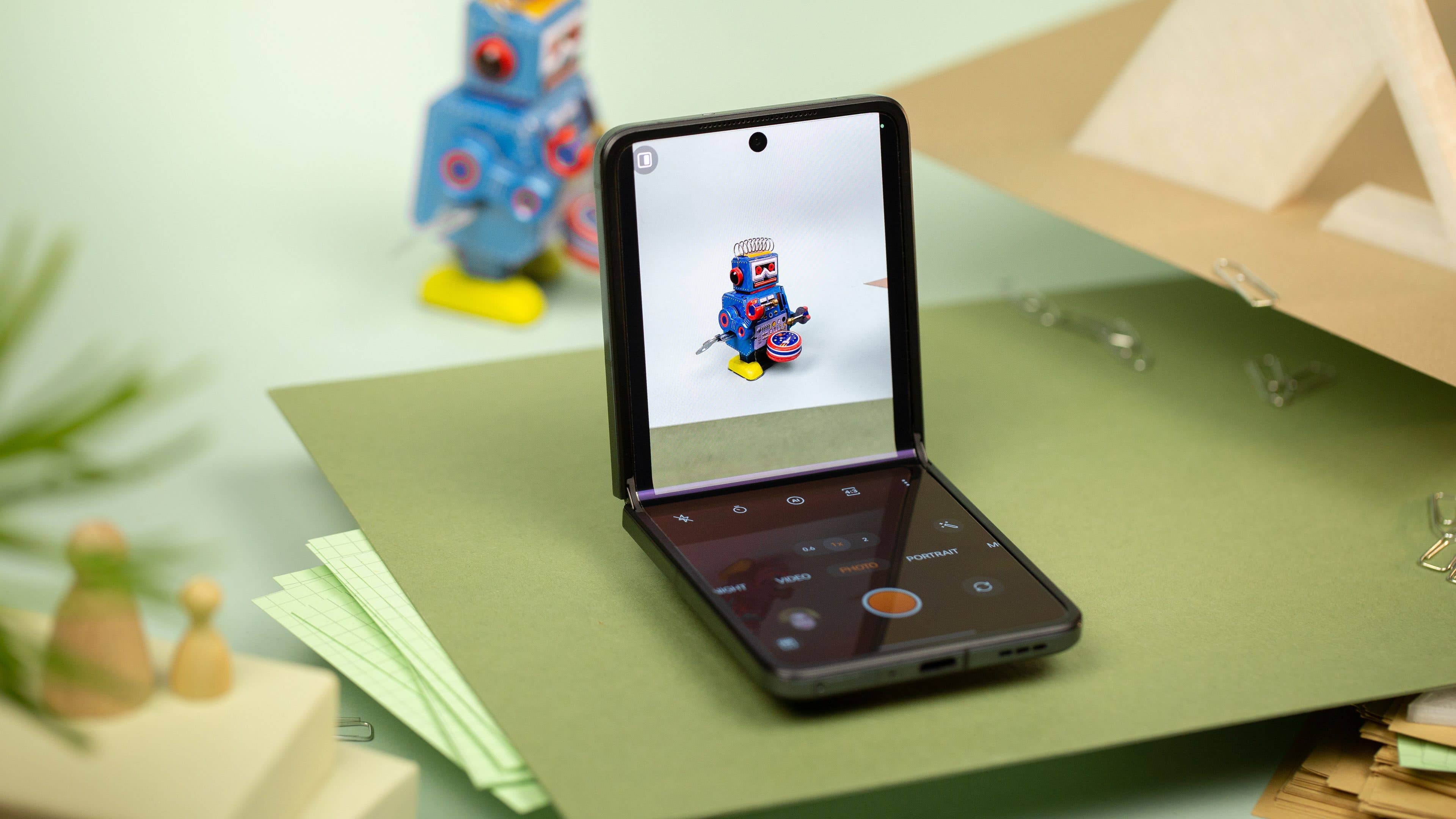

On the positive side, OLED screens can be made thinner than LCDs (because they donât require a backlight layer) and they can also be made flexible.
- Want to see flexible OLEDs in action? Check the best foldable smartphones on the market

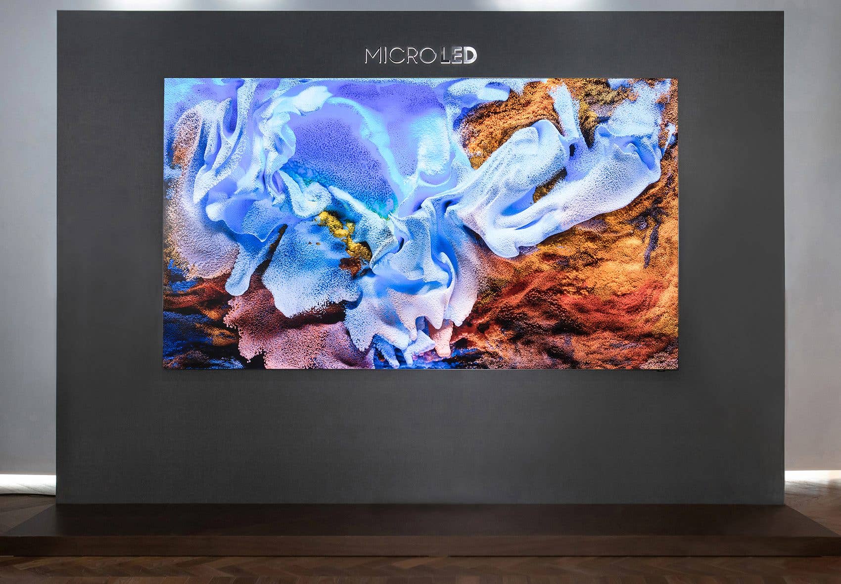

Displays of the future: microLED
There are whispers going around that smartphones and smartwatches will be looking at incorporating microLED technology in their devices soon, with it being radically different from LCD/LED displays as it sports similar image characteristics to that of OLEDs.
A microLED display has one light-emitting diode for each subpixel of the screenâusually a set of red, green, and blue diodes for each dot. Chances are it will use a kind of inorganic material such as gallium nitride (GaN).
By adopting a self-emitting light technology, microLED displays do not require the use of a backlight, with each pixel being âturned offâ individually. The result is impressive: your eyes see the same level of contrast as OLED displays, without suffering from the risk of image retention or burn-in of organic diodes.
Another advantage of microLED technology is the potential to display images with higher brightness levels while benefitting from lower power consumption, combining the strengths of both OLED and LCD panels.
On the other hand, the use of multiple diodes for each pixel poses a challenge in terms of component miniaturization. For example, a Full HD resolution has just over two million pixels (1,920 x 1,080 dots), which requires 6 million microscopic LEDs using a traditional RGB (red, green, and blue) structure.
This is one of the reasons that explain the adoption of such technology to date remains rather limited in scope. You will see them mainly on large screens of 75 to 150 inches only, which enable 4K resolution (3,840 x 2,160 resolution, which is close to 8.3 million pixels or 24.8 million RGB subpixels). This is a huge number of pixels to look at!

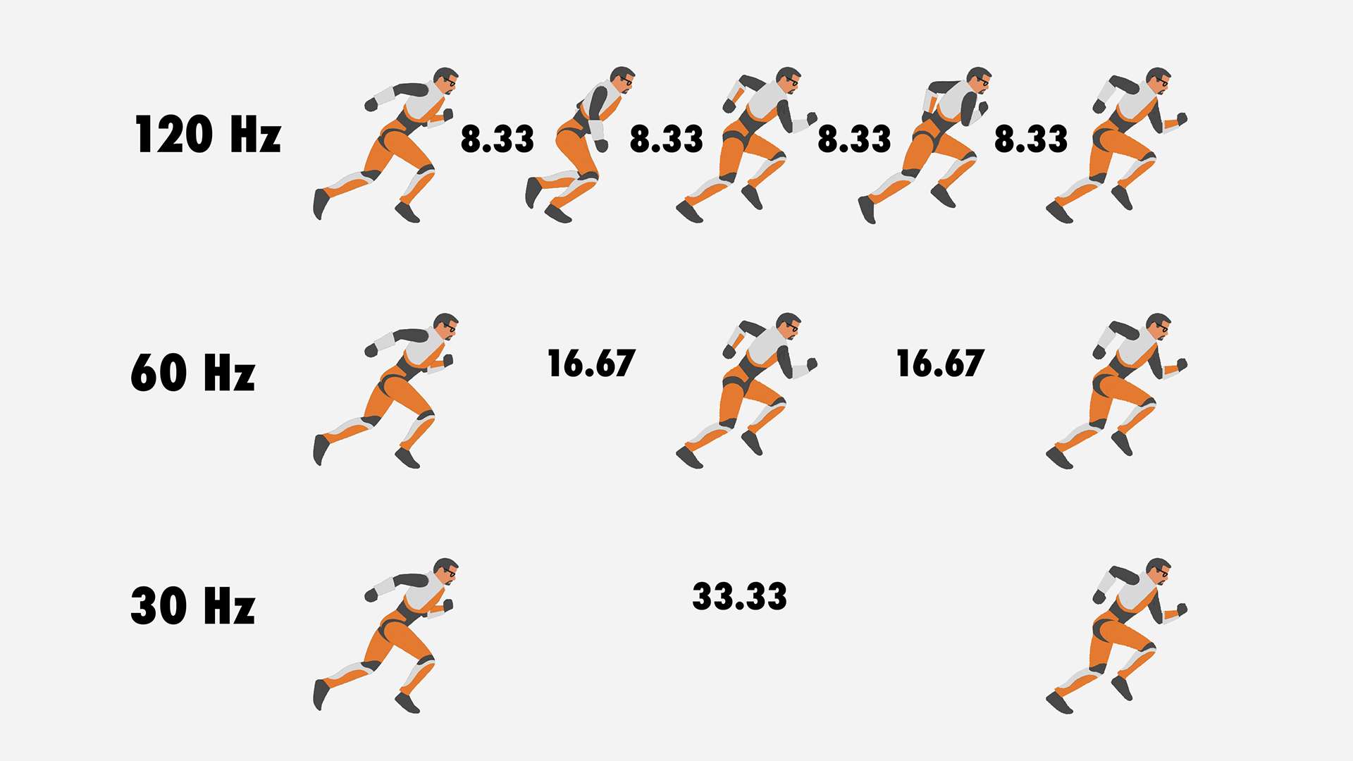

Refresh rates: what do 60Hz, 90Hz, and 120Hz mean?
Popularized in 2019 and 2020 by high-end and even some mid-range smartphones, the terms â120 Hzâ, â90 Hzâ and others with a similar measurement in Hertz represent the refresh rate of the panel, be it LCD or OLED. The higher the value, the more frames per second are displayed on the screen.
The result is smoother animations on the phone, both during regular use and in games, compared to screens that have a 60 Hz refresh rate which remains the standard rate in the market when it comes to displays.
Originally touted to be a âgimmickâ in 2017, with the launch of the Razer Phone, the feature gained more and more momentum in due time, even with a corresponding decrease in battery life. In order to make the most of this feature, manufacturers began to adopt screens with variable refresh rates, which can be adjusted according to the content displayedâwhich is 24 fps in most movies, 30 or 60 fps in home video recordings, and so forth.
The same unit of measurement is used for the sampling rate. Although similar, the value here represents the number of times per second the screen is able to register touches. The higher the sample rate, the faster the smartphone registers such touches, which results in a faster response time.
