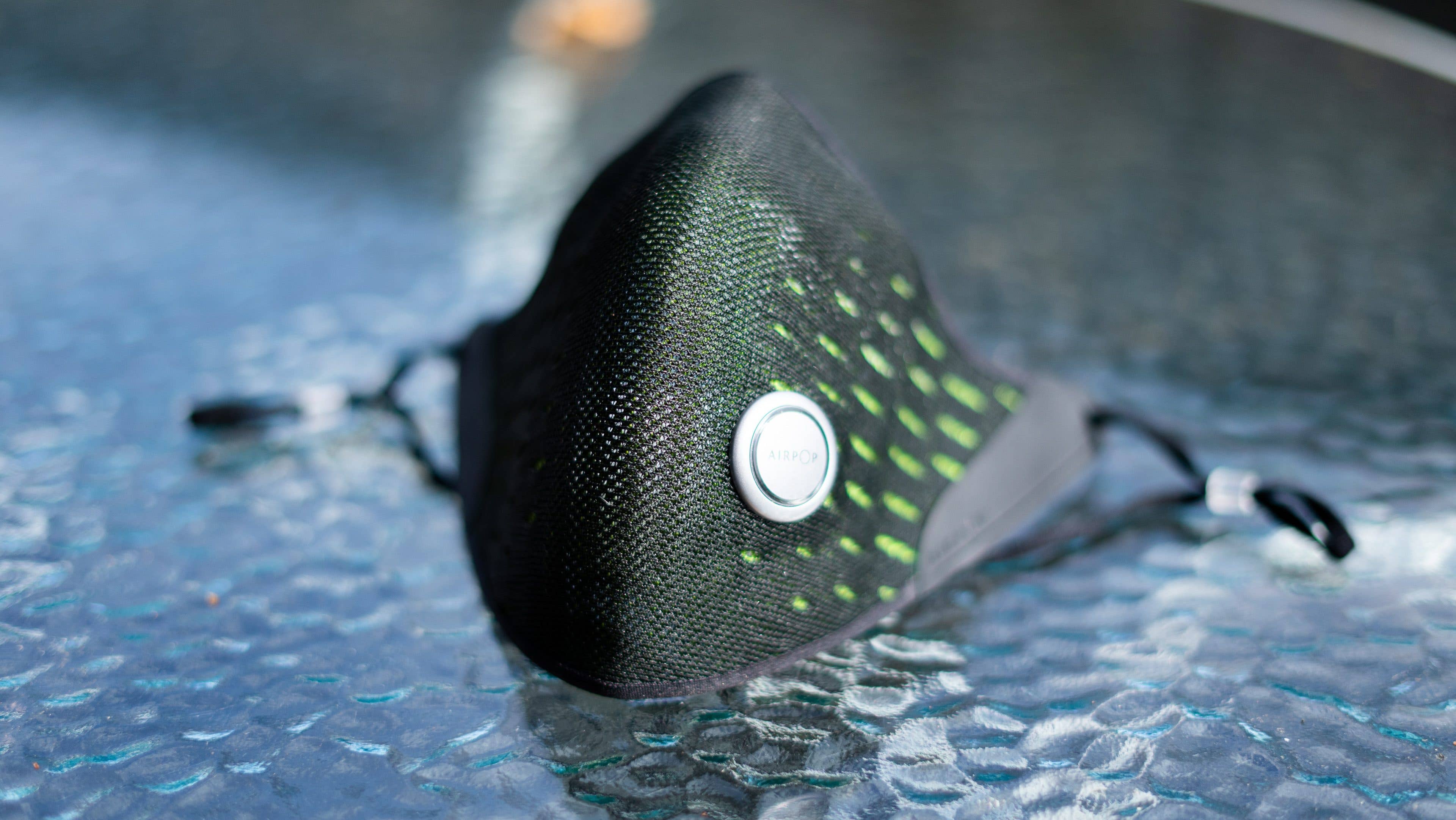

However, AirPop has no such intentions and focuses on something more related to the basic function of a breathing mask. Dubbing it Halo, the sensor you notice as a small “plug” inside the mask measures your respiration rate and relies on your location data to calculate the number and type of particles that were filtered while you were wearing it. At the same time, AirPop can also tell you exactly when you need to change the replaceable filters.

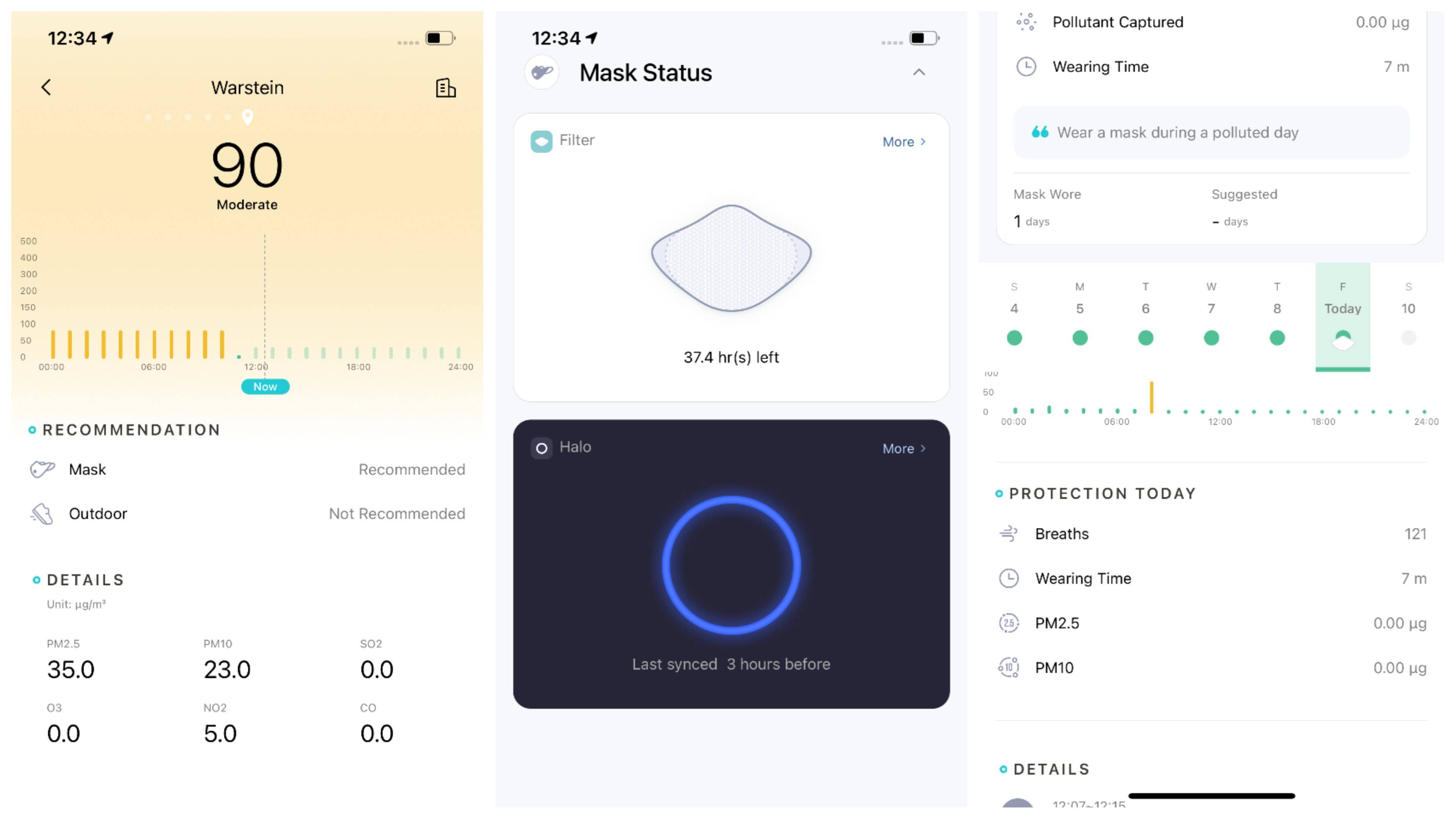

The health data, or “breath data”, can then be viewed in the Halo app on your smartphone. At the time of publishing, the app was only available on iOS. Here, you have the added advantage that the data also ends up duplicated in the Apple Health app.
The Halo app itself can either be synced manually after wearing it, or you can rely on one of the three tracking modes. According to the app, it is compatible with cycling, walking, and running. Adding to the convenience is the ability to record the distance ran after enabling location sharing.

It all sounds good in theory so far! In reality, however, I ran into quite a few problems with the AirPop Active+ Halo. Although the mask connected to my iPhone and the display even showed me data about the humidity levels in the sensor and the temperature, it does not record my breathing.
In order to troubleshoot, I disconnected the mask halfway through, removed the battery to reboot it, and downloaded the latest beta version of the app via TestFlight on AirPop’s advice. Hence, I doubt that I am able to obtain reliable tracking data over the course of time.

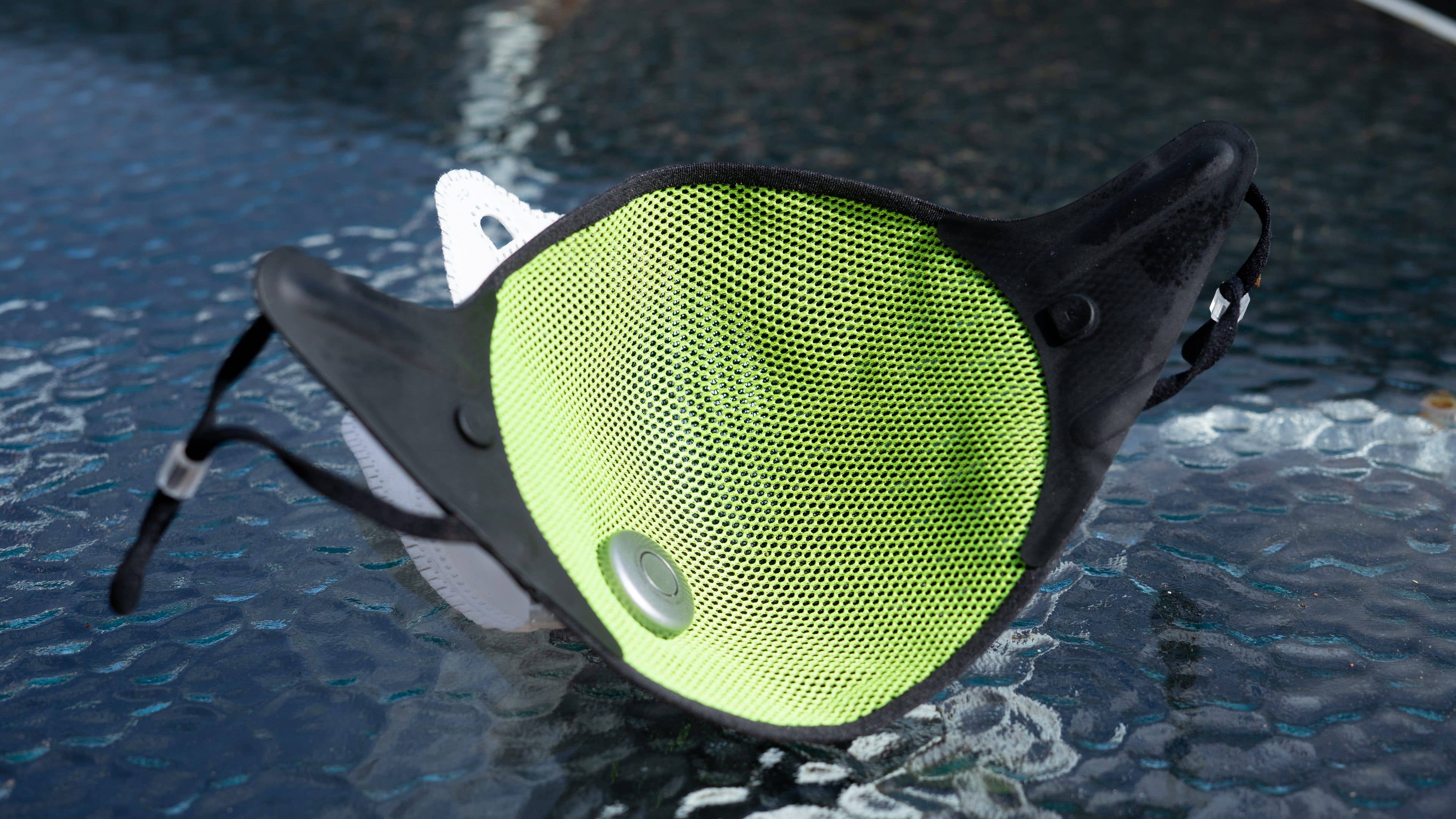

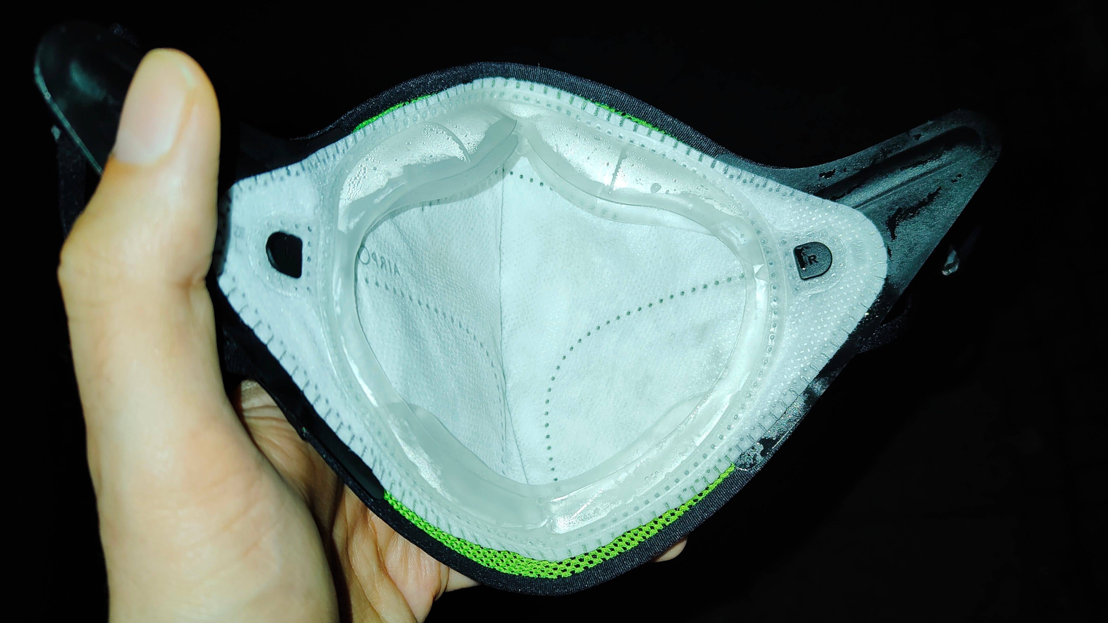

To prevent you from breathing in unfiltered air, AirPop surrounds the replaceable filters with a ring of polypropylene that you have to bend a bit in order to wear. It takes a while to get used to doing so, but with a little bit of practice, wearing the breathing mask is no problem at all, and when you can feel the slight movement of the filter as you inhale and exhale means you have worn it correctly: No more bad air coming through!

The combination of the inserted filter and the soft touch membrane with breathable pores is responsible for both the inhalation and exhalation process. Hence, the slight lift-off that you might be familiar with from N95 masks doesn’t exist here. Instead, the air is supposed to escape in such a manner that a tiny air cushion is created in the cavity between the lips and the mask. This aerodrome design, for which the company invented a manufacturing process dubbed “Airknit,” allows AirPop to prevent wearers from re-inhaling exhaled CO2.
Let us give that statement the benefit of the doubt, even if it’s hard to verify. Intuitively, I would have thought that upon exhalation, air with carbon dioxide would be collected here as opposed to escaping. I confirmed this suspicion when I breathed in very lightly with the AirPop. When I wore it for the first time, I felt like I wasn’t breathing in enough air.

This is worth mentioning but not really relevant: the Halo sensor is powered by a CR1632 coin battery. These are not very common in Germany, but can be ordered on the Internet for a few Euros. According to the manufacturer, it is highly recommended that you change the battery every six months. During the review, however, I had to change the battery once – but I suspect that it is more of a faulty battery issue that was included with the review unit than anything else.
