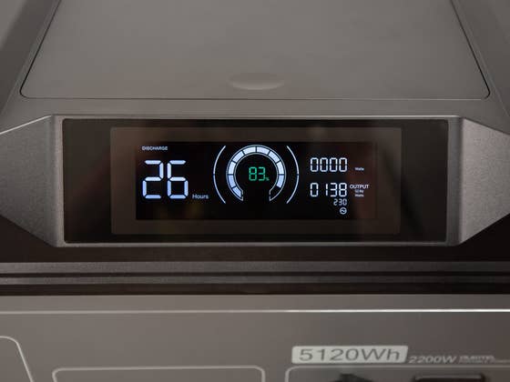

Ecoflow Delta 2 Max display
Some power stations—here from EcoFlow—show you on the display how long they will last with the current power. / © nextpit Image source: nextpit

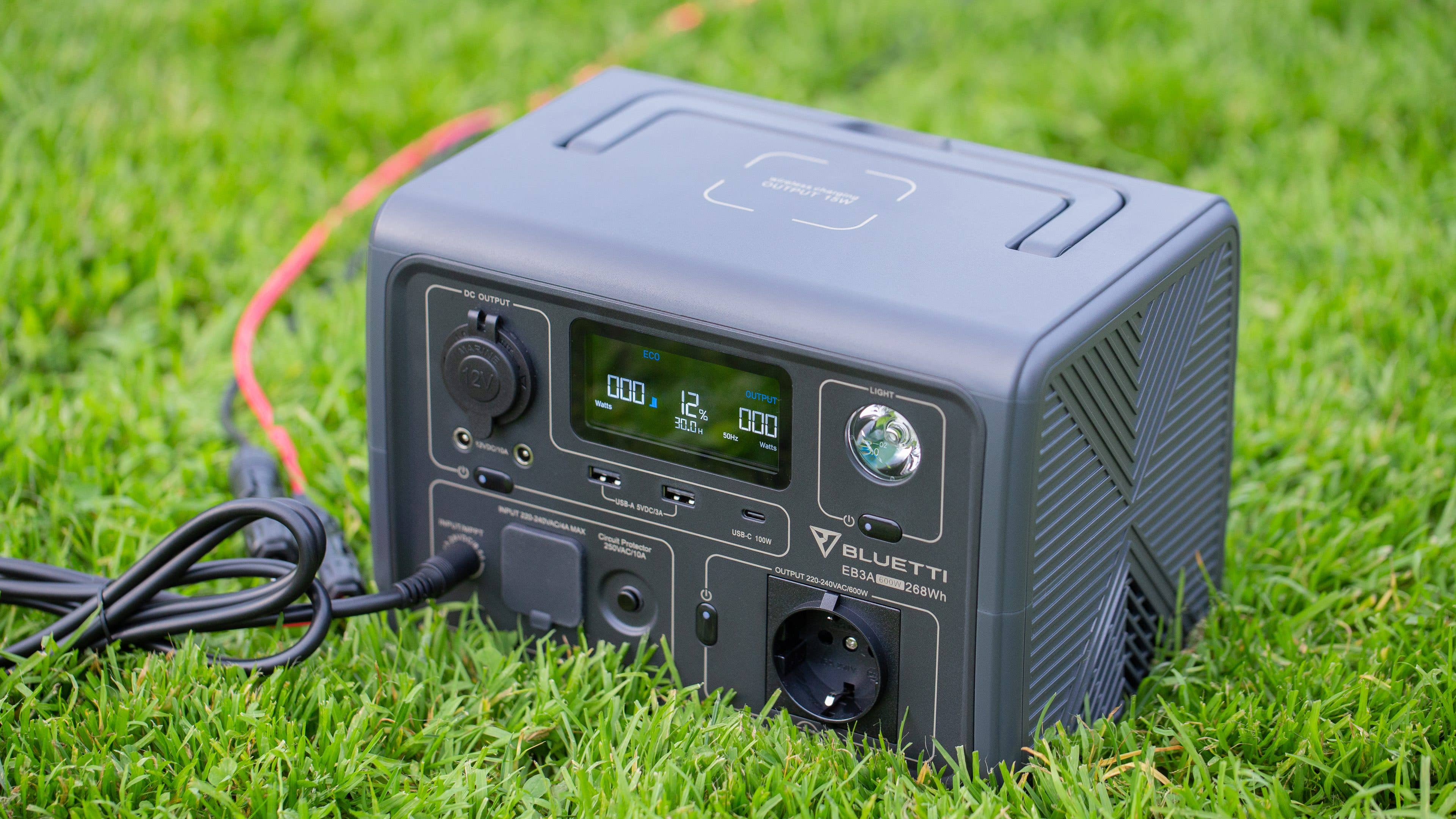

Bluetti EB3A
The inverter turns the direct current in the battery cells into an alternating current for the 110-volt socket. / © nextpit Image source: nextpit

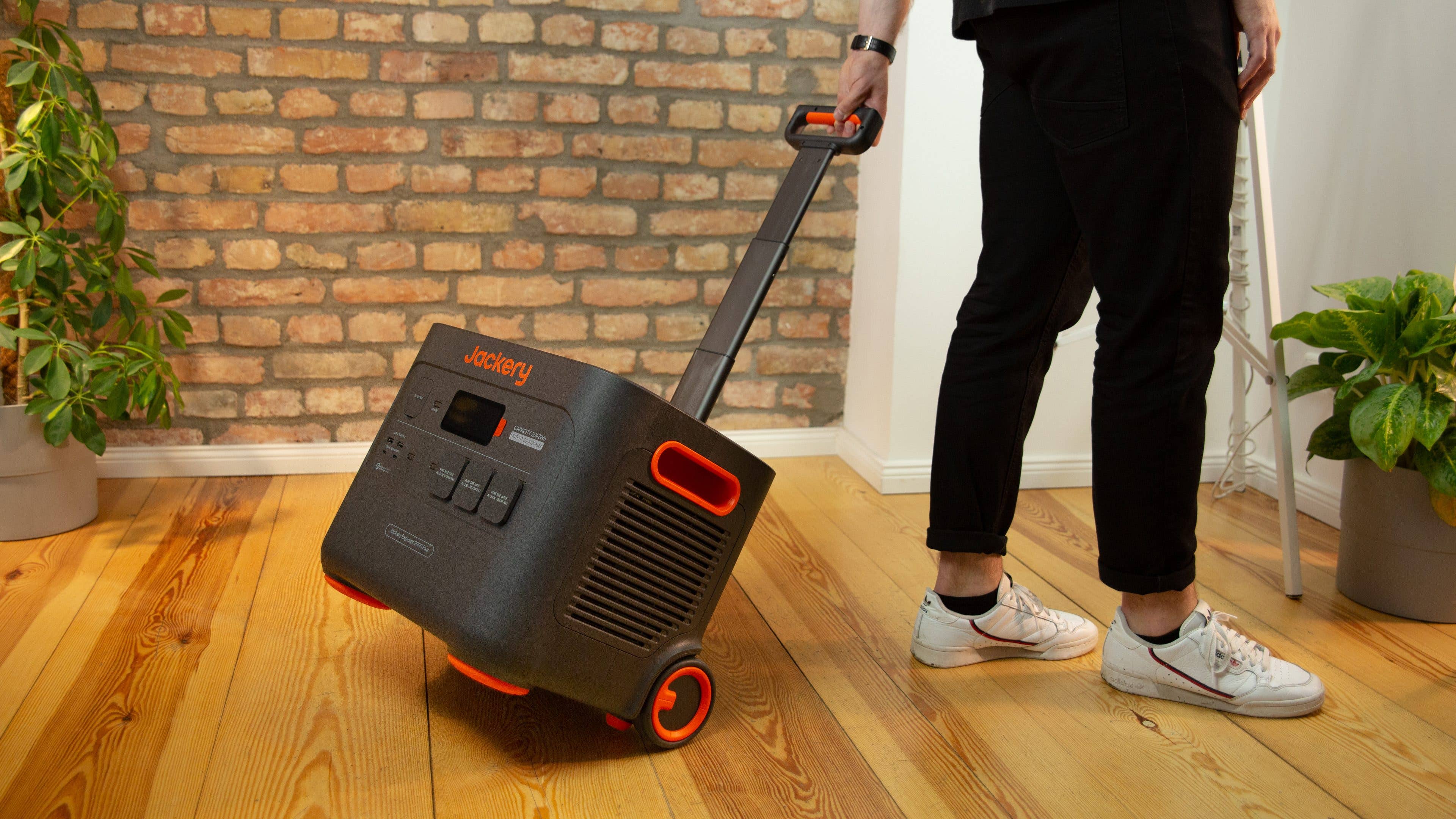

Jackery Explore 2000 Plus has a carrying handle
The Jackery power station Explorer 2000 Plus lithium iron phosphate batteries. / © nextpit Image source: nextpit

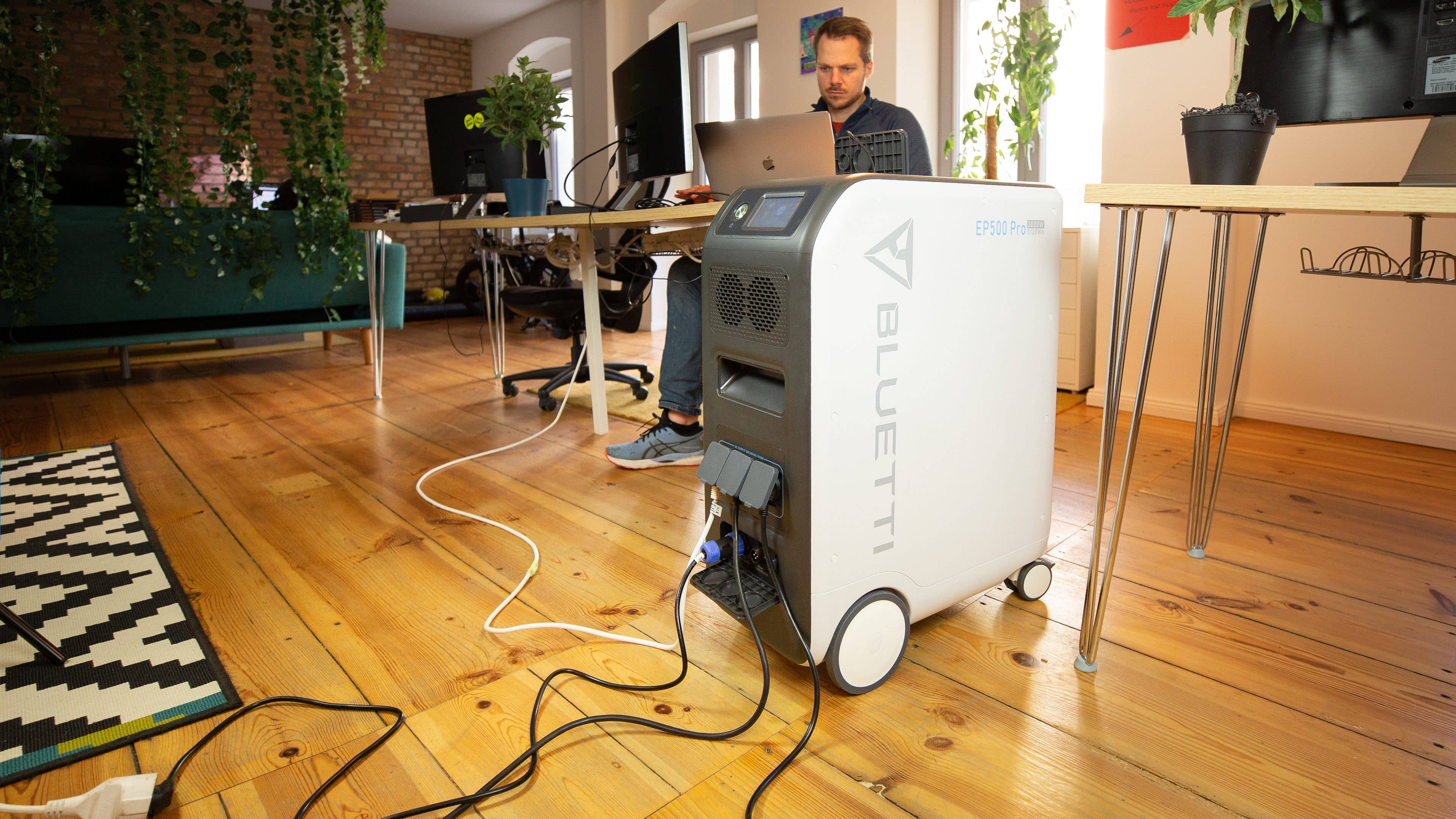

Bluetti EP500 Pro
If you use 50 percent of the capacity in the Bluetti EP500 Pro every day, it will take around 20 years for the battery capacity of the Power station to drop to 80 percent. / © nextpit Image source: NextPit
