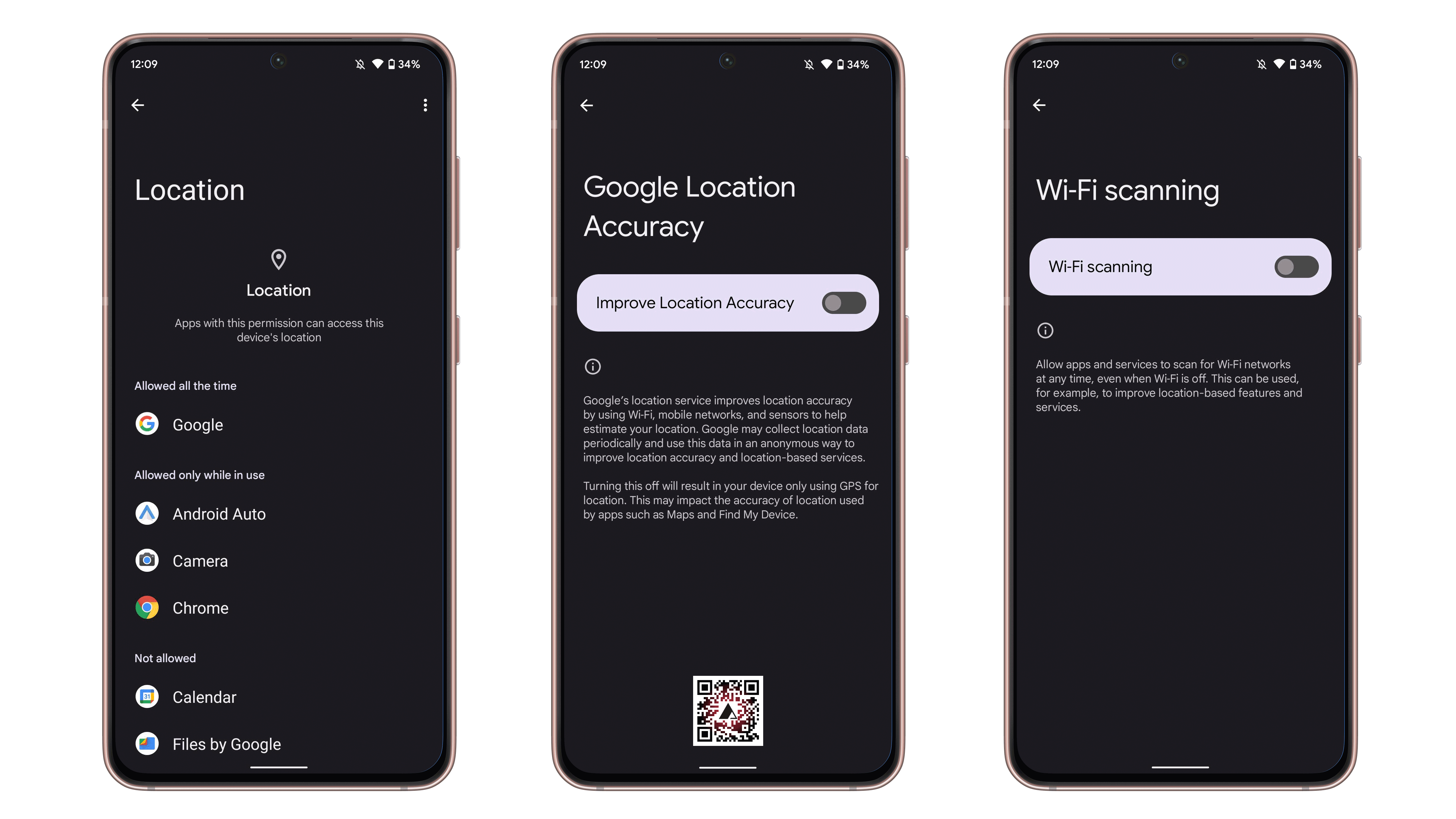

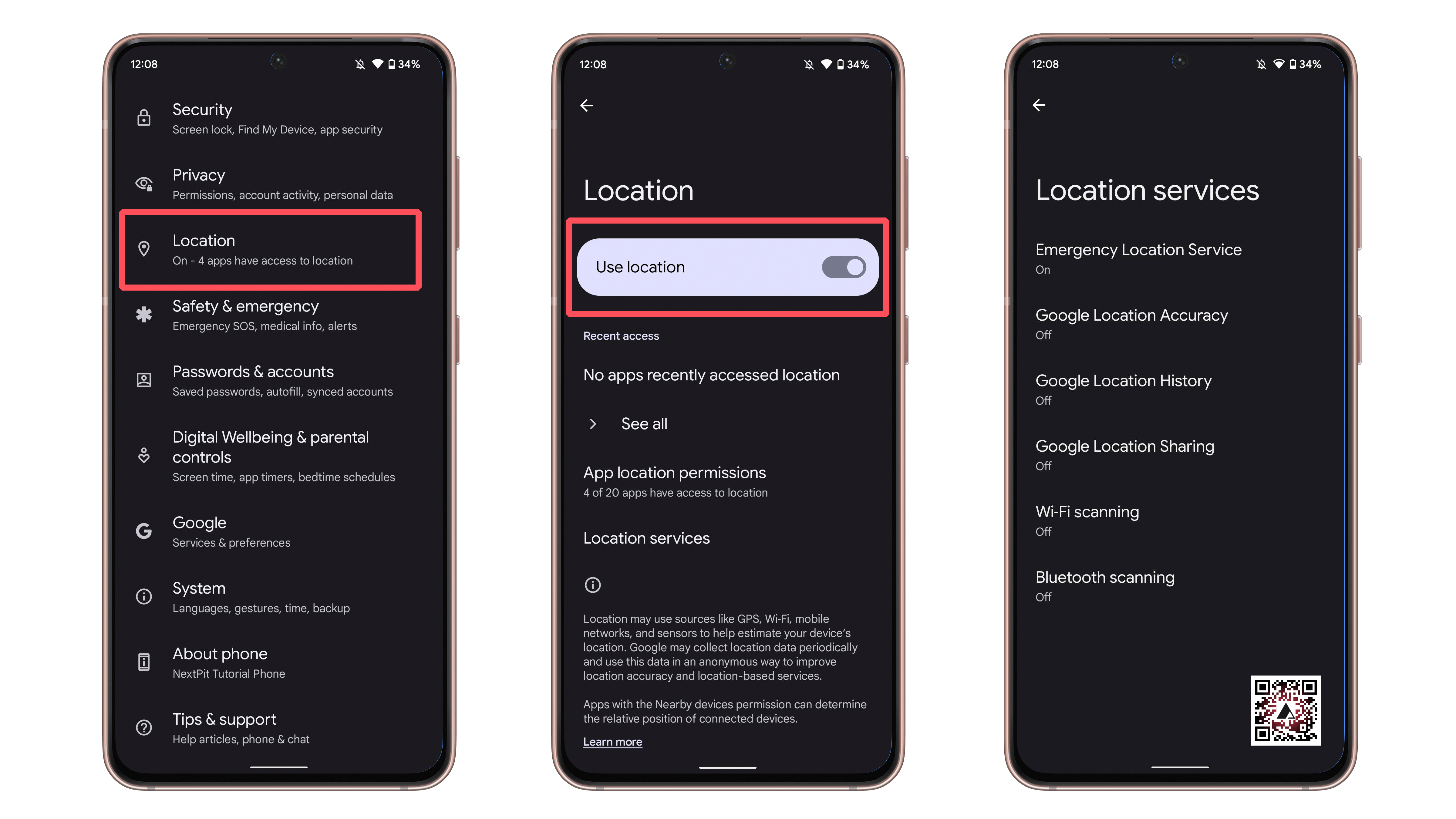

1. Enable Google Location Accuracy
To get the best possible signal, you have to be prepared to use your battery a bit more than normal. It’s a necessary sacrifice, and you can always reverse that decision later when you don’t need to use GPS anymore. Enabling this is easy: just follow a couple of steps and you’ll be on your way.
Go into your Settings and select Location to ensure that your location services are on. You should also be able to enable it from the quick toggles when pulling down the notification bar.
Under Location, you need to go to Advanced and then Google Location Accuracy. Tap it and make sure the slider for Improve Location Accuracy is on. This will make use not only of your GPS but Wi-Fi and mobile network connection as well to provide a more accurate estimate of your location. Of course, this setting will drain additional battery life, but it will make use of all available methods to provide you with the most accurate location possible.
On some smartphones, you will also find additional options under Scanning in the location settings page. You can enable Wi-Fi scanning and/or Bluetooth scanning. The first will improve accuracy even more by allowing apps and services to detect Wi-Fi networks all the time. The same applies for Bluetooth scanning, which will detect nearby Bluetooth devices.

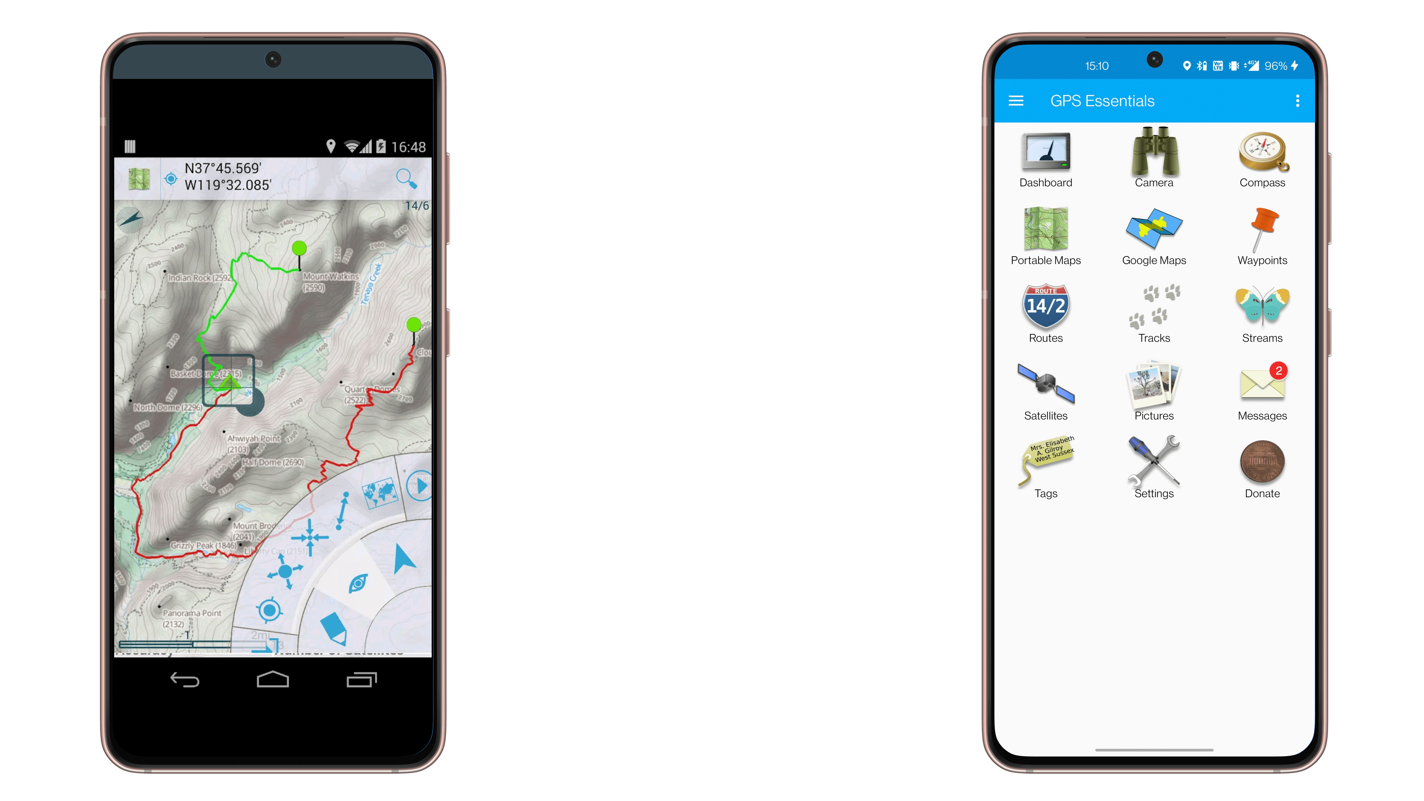

With GPS Essentials, you can diagnose whether a poor GPS signal is due to a hardware or software issue. In the GPS Essentials main menu, select Satellites, then watch (with a sense of wonder) your smartphone connect to the numerous satellites that hover around the earth.
If no satellites appear, then this could be due to interference from metallic objects around you, your smartphone case, or even malfunctioning GPS hardware. If satellites do appear, but your GPS is still out of whack, then this is a software issue, and you should refer to the other tips in this article to help you. In any case, you should always be out in an open space and not within the confines of a building or in a basement when you are trying to obtain a GPS lock.

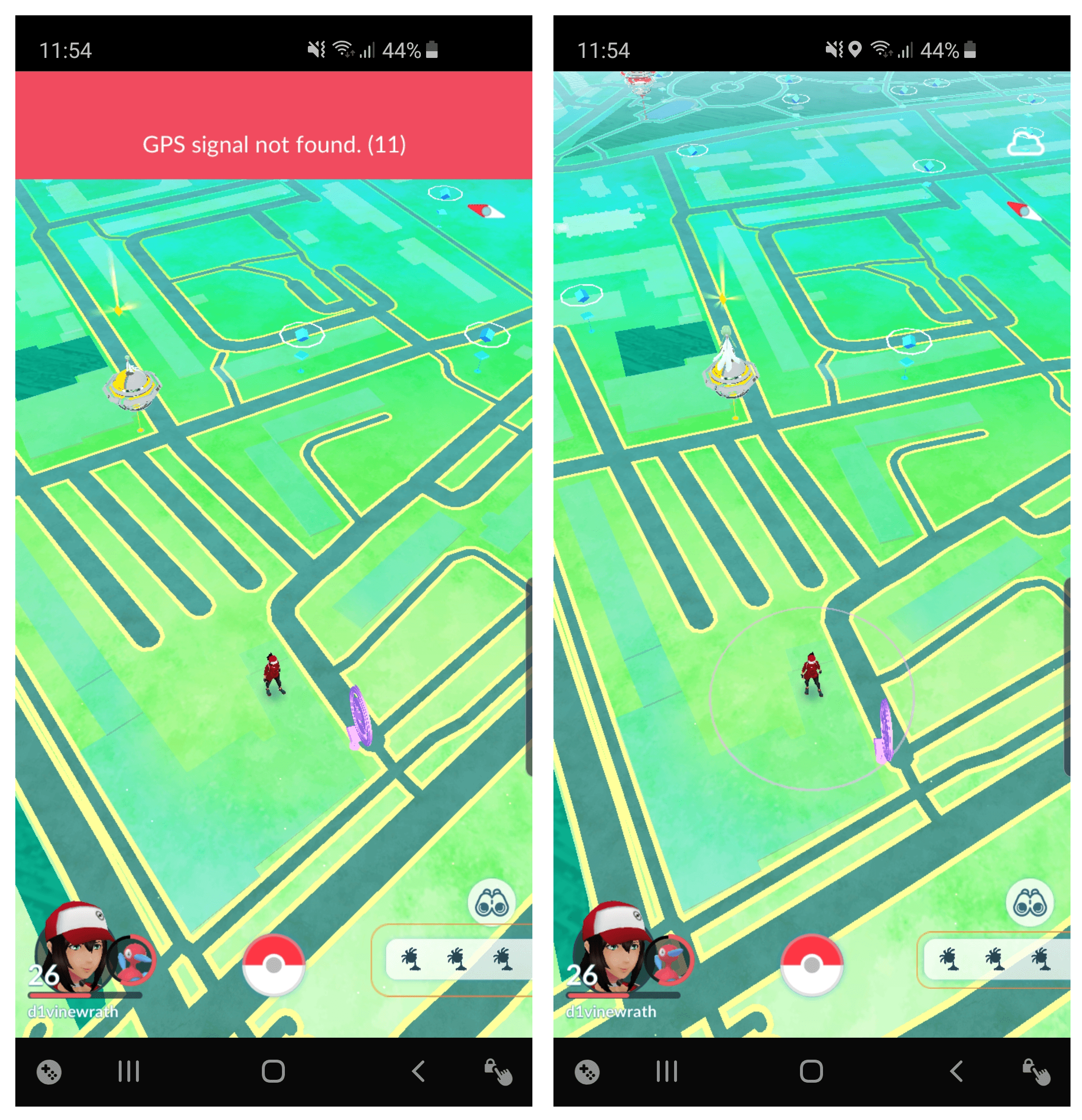

7. Bonus tip: Fixing Pokemon GO GPS problems
The apps that most often utilize your GPS besides Google Maps would most probably be AR-location based games like Pokemon GO and Ingress. However, the dreaded ‘GPS signal not found’ error is a rather common occurence. How can you fix it? First, make sure your location is enabled and then turn on high accuracy, as described in the steps above. You should now be able to go on the hunt for more Pokemon and be the best trainer there is.
If the error does not disappear, however, you will need to restart the app. If it still persists, log out of your account, close the application from the recent apps menu, wait a couple of seconds and re-open it. Once you log back in, the problem should have cleared up. Restarting your phone is always something you should try as well as a last resort. Finally, you should also make sure you have the latest version of Pokemon GO or Ingress by checking the corresponding app version on the Play Store.
