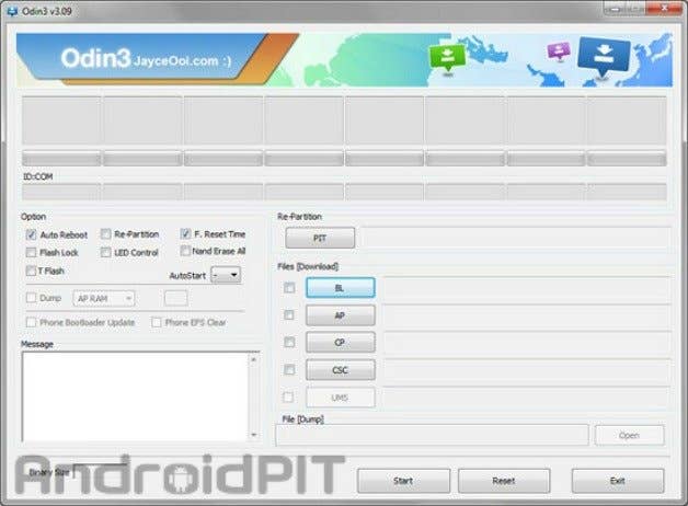

Downgrading your firmware is exactly the same as upgrading, you simply use an older firmware version than the one you currently have. So if you’ve found yourself stuck with an unworkable 4.3 update, follow the same process you normally would to manually install the new firmware, but instead use the firmware you started with before the OTA update. First of all make sure you have a full backup of your S3 because the flash procedure will wipe your data.
You’ll need Odin v3.09 and the necessary USB drivers for your S3. Make sure you also have USB Debugging enabled in Developer Options.
Then, you’ll need the relevant firmware for your device. You can find the relevant firmware for your particular model number S3 at Sam Mobile’s firmware page.
What you need to do
- Download the appropriate firmware .zip file for your S3 (link above) and extract it on your PC. You’ll see a few .tar.md5 files inside.
- From being powered off, start your S3 in Download Mode by pressing Volume Down + Power and Home button simultaneously.
- Open Odin and connect your S3 to your PC with a USB cable. Wait until Odin recognizes the device (a blue box appears in Odin).
- In Odin’s Files [Download] section, navigate to the relevant tar.md5 file/s in the downloaded S3 firmware. If you only have one file in the extracted firmware it goes in AP (in older versions of Odin, the AP box is called PDA). If you have multiple files, just plug them into the appropriate boxes in Odin.
- Make sure the repartition box is not checked.
- Click Start and wait. Once the procedure is complete your S3 will restart and you’ll be back to where you started from before your update nightmare began.
If your S3 doesn’t reboot on its own, enter Recovery Mode by pressing Volume Up + Power + Home button simultaneously and then performing a Data Wipe/Factory Reset and wipe any cache partition. Then select Reboot System Now and you should be good to go.

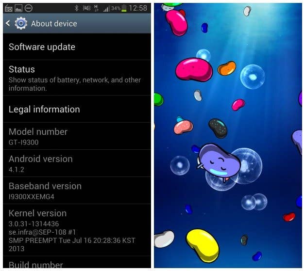

I have Samsung galaxy S3 purchased in December 2012 from Australia. I am not able to update the android version and it is struck on version 4.1.2. Whenever I try to update the s/w it says latest version has already been installed on your phone. I also tried updating the firmware using Kies but there also the same message 🙁
Can any android czars pls help.
Thanks
Hi @Nikhil, what is the model number? If you have the standard I9300 model then you should be able to upgrade to 4.3 at least. KitKat will not be available for S3’s with only 1 GB of RAM, but if you have the LTE version with 1.5 GB of RAM then you can get KitKat. I’m not sure why Kies would be telling you that you have the latest version at 4.1.2? Visit SamMobile’s firmware page and enter your specific model number to see what the latest firmware is.

The model number is GT-I9300. Yes I understand I can’t have the Kitkat 4.4 for my phone but atleast 4.3 should be upgraded.
I checked the samMobile’s firmware page and as expected it is out of date.
http://www.sammobile.com/firmwares/1/?model=GT-I9300&pcode=0#firmware
How to update the firmware now ? Tried all the steps using kies.
Thanks
NG
You can also use Odin to push the firmware. Here’s a guide I wrote a while back (it was for downgrading though, so just make the appropriate changes): http://www.androidpit.com/how-to-downgrade-galaxy-s3
