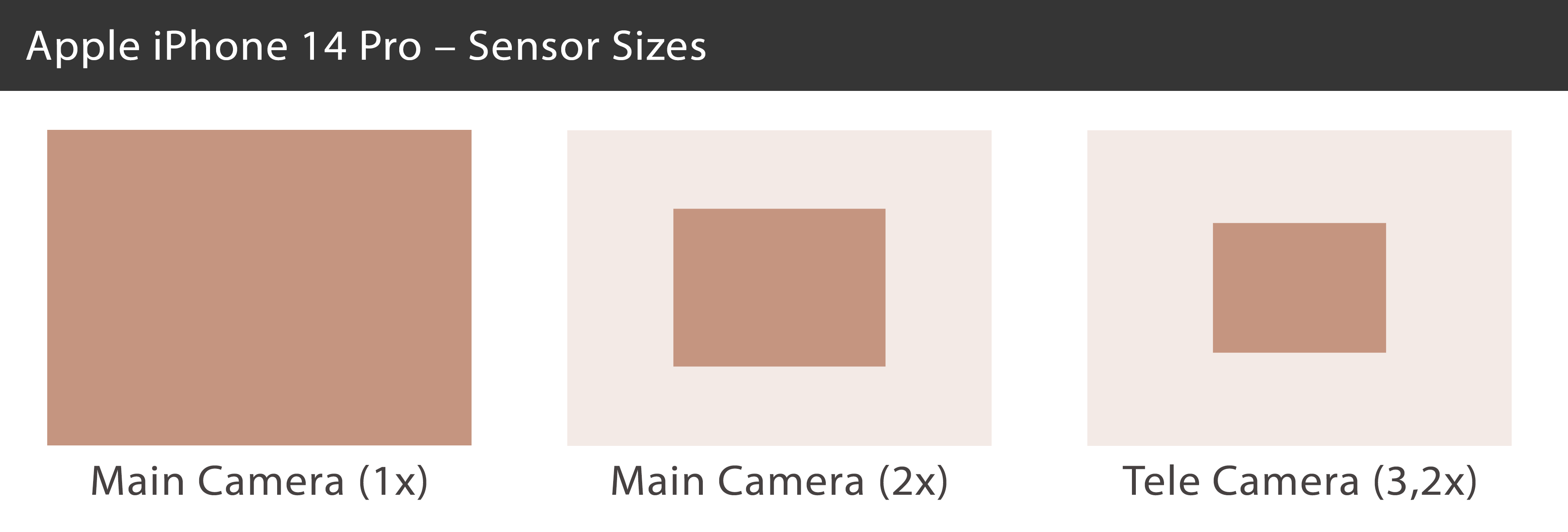

The iPhone 14 Pro’s main camera is a 1/1.28-inch image sensor that measures 9.8 by 7.3 millimeters, with a 48 MP resolution. With the 2x zoom, Apple simply cuts out a 12-megapixel section from the center of the sensor, which then still measures 4.9 by 3.7 millimeters on the sensor – and thus roughly corresponds to the 1/3-inch format. That is still enough for decent photos under good lighting conditions.
At 3x zoom, Apple then switches to the next 12-megapixel sensor (which is actually more like 3.2x with an equivalent focal length of 77 millimeters). With the 1/3.5-inch format or 4.0 by 3.0 millimeters, the sensor is again a bit smaller than the “2x sensor” that was cut out of the center of the main camera.

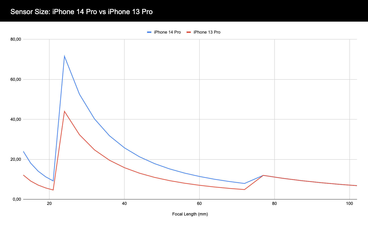

In the following chart, you can see how much sensor area is available for the camera in the iPhone 14 Pro and iPhone 13 Pro at different focal lengths. The ultra-wide angle (13 millimeters) begins on the far left of the edge. The main camera (24 millimeters) shows a significant increase. Up to the telephoto camera (77 millimeters), the iPhone 14 Pro always has more sensor area available than the iPhone 13 Pro. Finally, the telephoto camera remains identical.

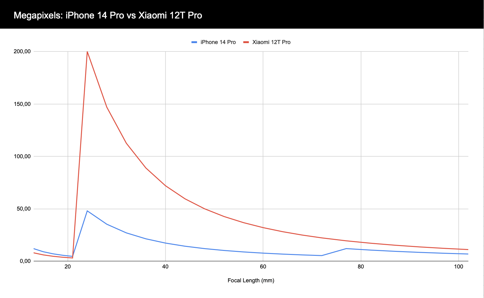

The chart above is also interesting, only with megapixels (MP) instead of the sensor area viewed on the vertical axis. While the progression is identical for the ultra-wide and telephoto sensors that are 12 MP each, the jump to 48 MP is clearly noticeable. The iPhone 14 Pro has significantly more resolution to play with in digital zoom between 1x and 3.2x.

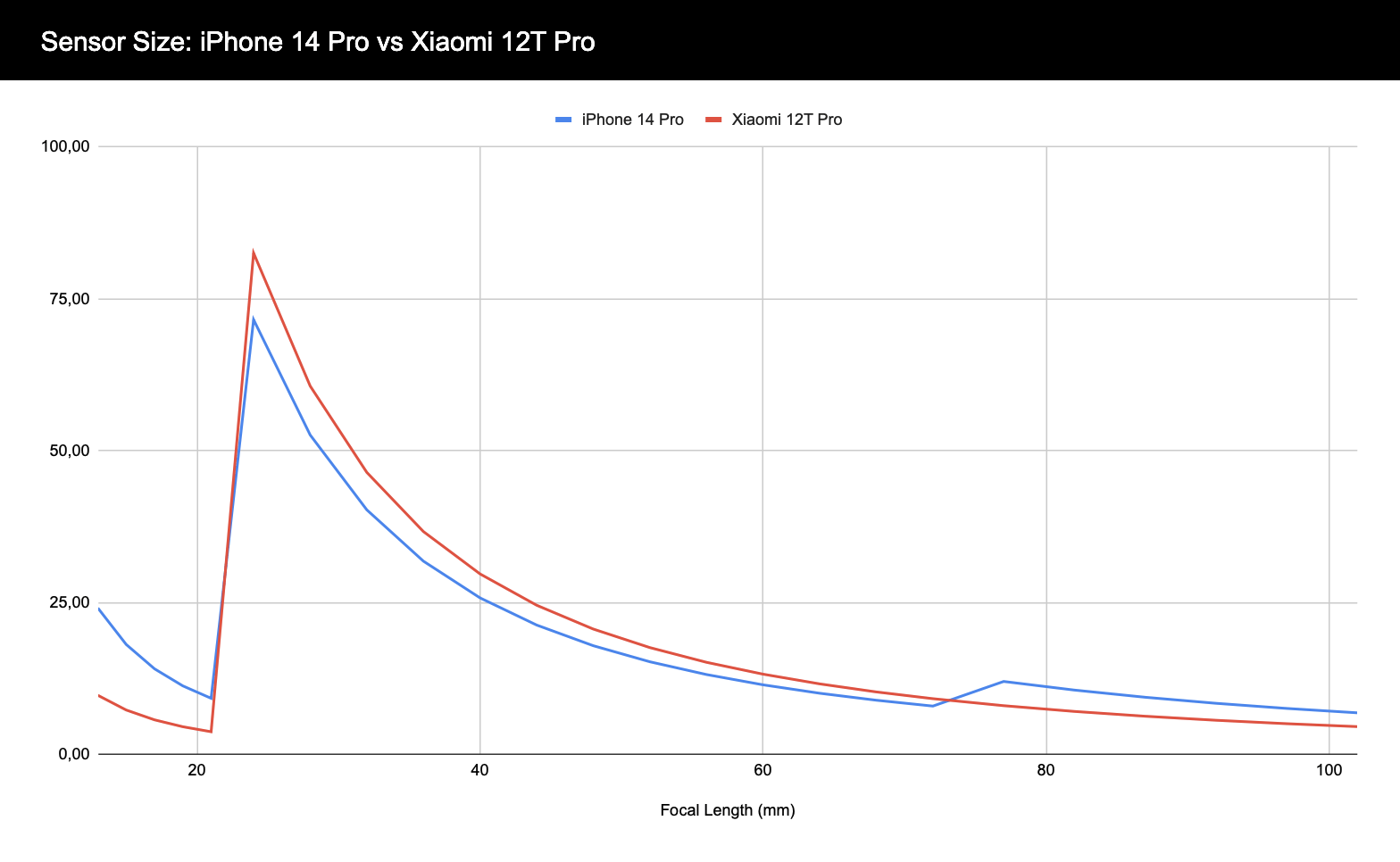

The iPhone 14 Pro discussed so far is not even the smartphone with the highest resolution or the largest sensor. This week, Xiaomi launched the 12T Pro, which offers a 200 MP sensor – and completely forgoes a telephoto camera in return. But how much more room for digital zooming do so many megapixels offer? Let’s take a look at it in comparison with the iPhone 14 Pro:
However, the more important factor besides the resolution is the sensor area that is available to the camera at different focal lengths. The Isocell HP1 installed in the Xiaomi 12T Pro is considerably larger than the main camera in the iPhone 14 Pro with 1/1.22 inches, but it then loses out in terms of the available sensor area when the Apple smartphone switches to telephoto zoom:

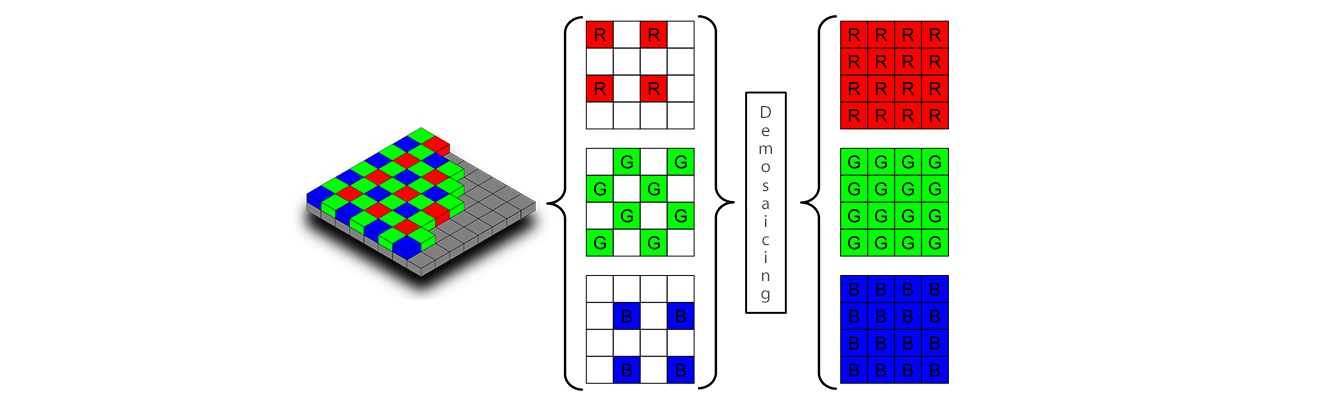

We have ignored one factor so far: the color masks above the sensor. In order to explain Quad-Bayer, we first have to look at how image sensors work. An image sensor consists of lots of small light sensors that only measure the amount of incident light without being able to distinguish colors. 12 MP means having 12 million such light sensors.
To turn this black-and-white sensor into a color sensor, a color mask is placed over the sensor to filter the incident light according to green, red or blue. The Bayer mask used in most image sensors always divides two by two pixels into two green pixels and one red and one blue pixel. A sensor with a resolution of 12 MP has therefore, six million green pixels and three million blue and red pixels each.
In demosaicing , or de-bayering , the image processing algorithms use the brightness values of the surrounding pixels of a different color to infer the RGB value of each pixel. A very bright green pixel surrounded by “dark” blue and red pixels thus becomes completely green. And a green pixel next to the completely exposed blue and red pixels becomes white. And so on, until we have an image with 12 million RGB pixels.
