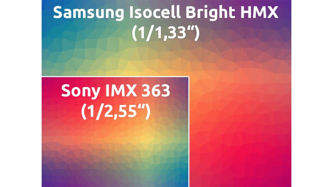

With the Samsung Isocell Bright HMX sensor installed in the Xiaomi Mi Note 10, sensor size is unfortunately in the background. That’s a shame because the light-sensitive chip is really damn big with 1/1.3 inch. The less obvious inch number corresponds to an area of about 70 square millimeters. That’s about three times bigger than Sony’s IMX 363, which Google is using in Pixel 4 (XL), for example.
AndroidPIT sensor size comparison
This graphic shows the sensor in Google Pixel 4 (XL) and the sensor in Xiaomi Mi Note 10 in scale comparison / © NextPit Image source: NextPit

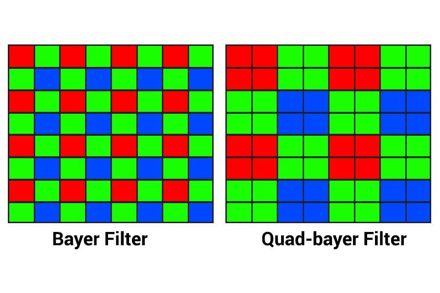

The trick of distilling from high to lower resolution has advantages, at least on paper. Virtually every current smartphone image sensor works with a so-called Bayer mask, which divides the pixels present on the sensor into green, red and blue pixels according to the ratio 2:1:1. Without this mask, every pixel on the chip would only measure brightness stupidly – we would have a black-and-white camera. The camera software then calculates the RGB color values of each pixel based on the surrounding pixels of a different color on the sensor.
quad bayer filter
Both Sony’s Quad-bayer chips and Samsung’s Tetracell sensors always place four pixels of the same color next to each other / © GadgetByte Image source: GadgetByte

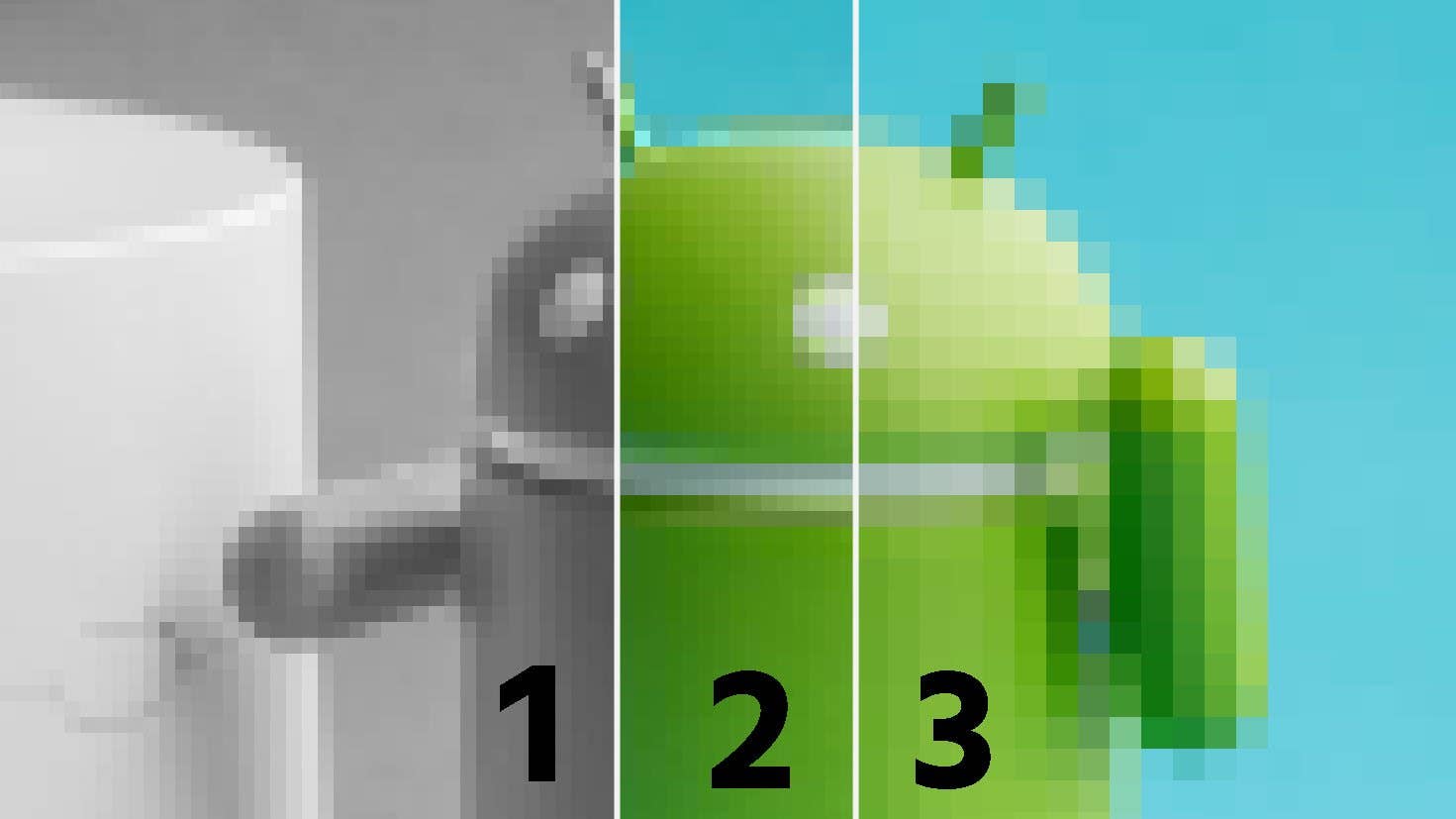

The Bayer mask on the Tetracell sensor developed by Samsung and Xiaomi has – like Sony’s so-called Quad-bayer sensors with 48 megapixels, by the way – no 108 megapixels, but only 27 megapixels – four pixels under each color filter. The advantage, however, is that at least the brightness values can be measured more granularly. And when it comes to perceiving image sharpness, brightness resolution plays a greater role than color resolution.
honor 9 rgb br sensor
The image in the center (2) has the finer brightness resolution of the left image (1) and the coarser color resolution of the right image (3). This lower color sub-sampling, which is common in image compression, is only noticeable at the edges / © NextPit Image source: NextPit
