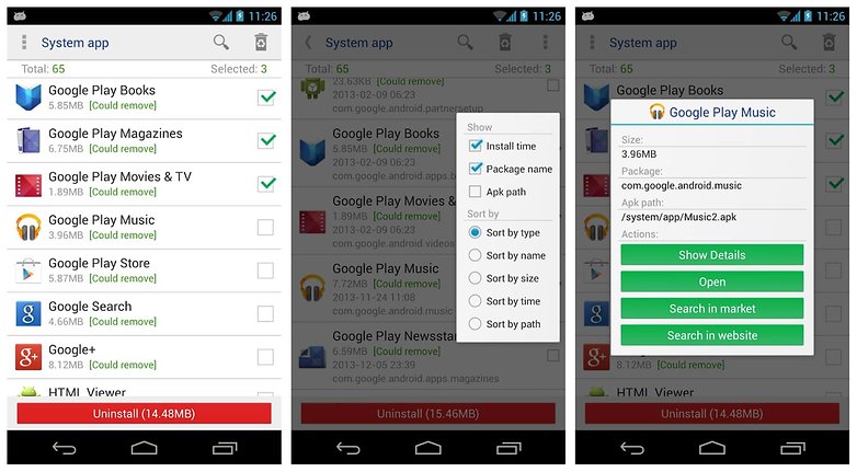

And if you really do want to root your phone....
With so-called root rights, you can completely uninstall all apps from your Android smartphone. However, these rights are accompanied by some complications, which we explain in a separate article:
The System App Remover app does what it says on the tin. You select the pre-installed apps and the app deletes them. Thanks to the recycle bin, you can restore the apps afterward. For maximum storage recovery, you can empty the trash at the end completely.
remove system apps
The System App Remover actually deletes pre-installed Samsung apps completely and securely. / © ANDROIDPIT
