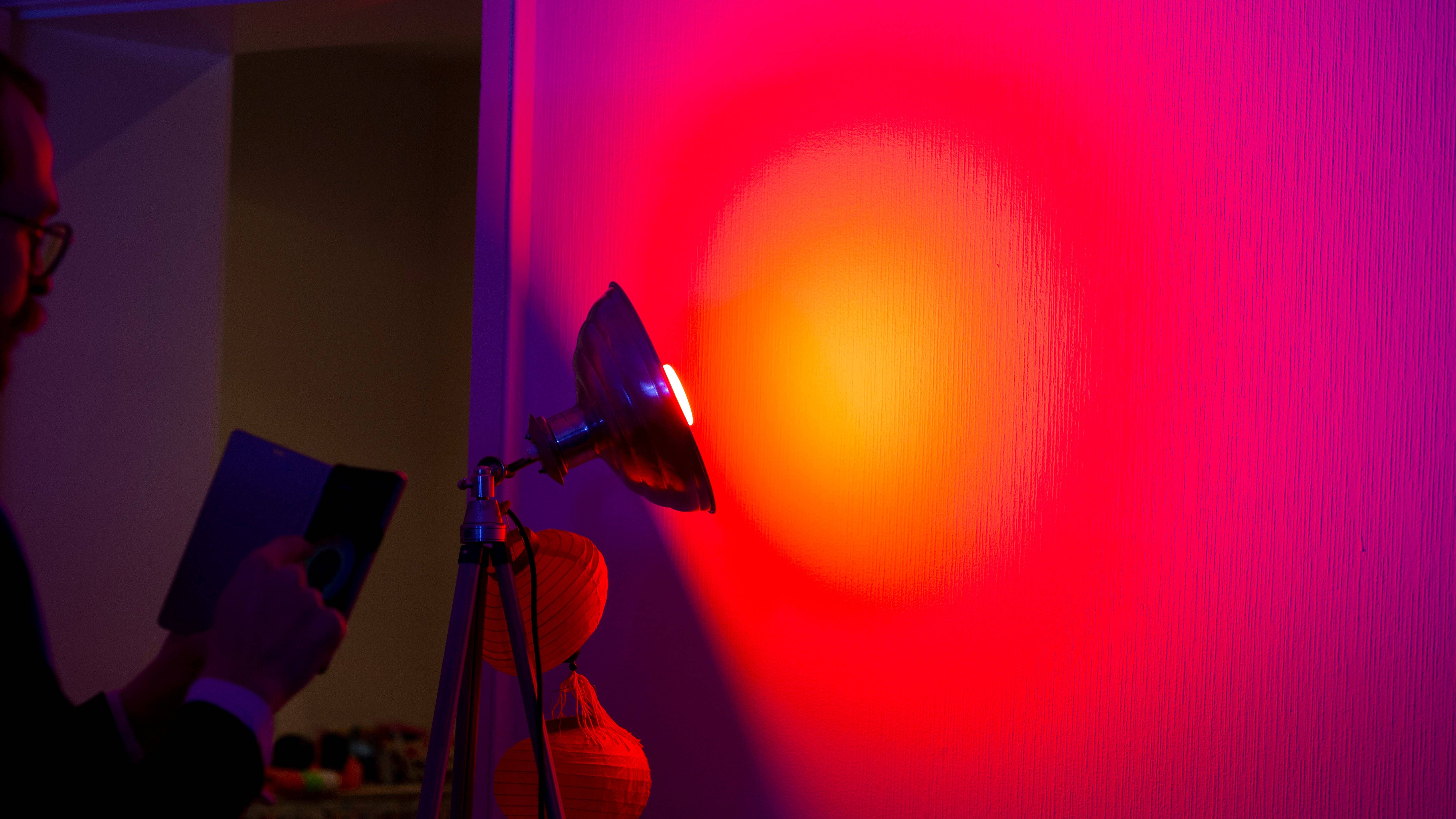

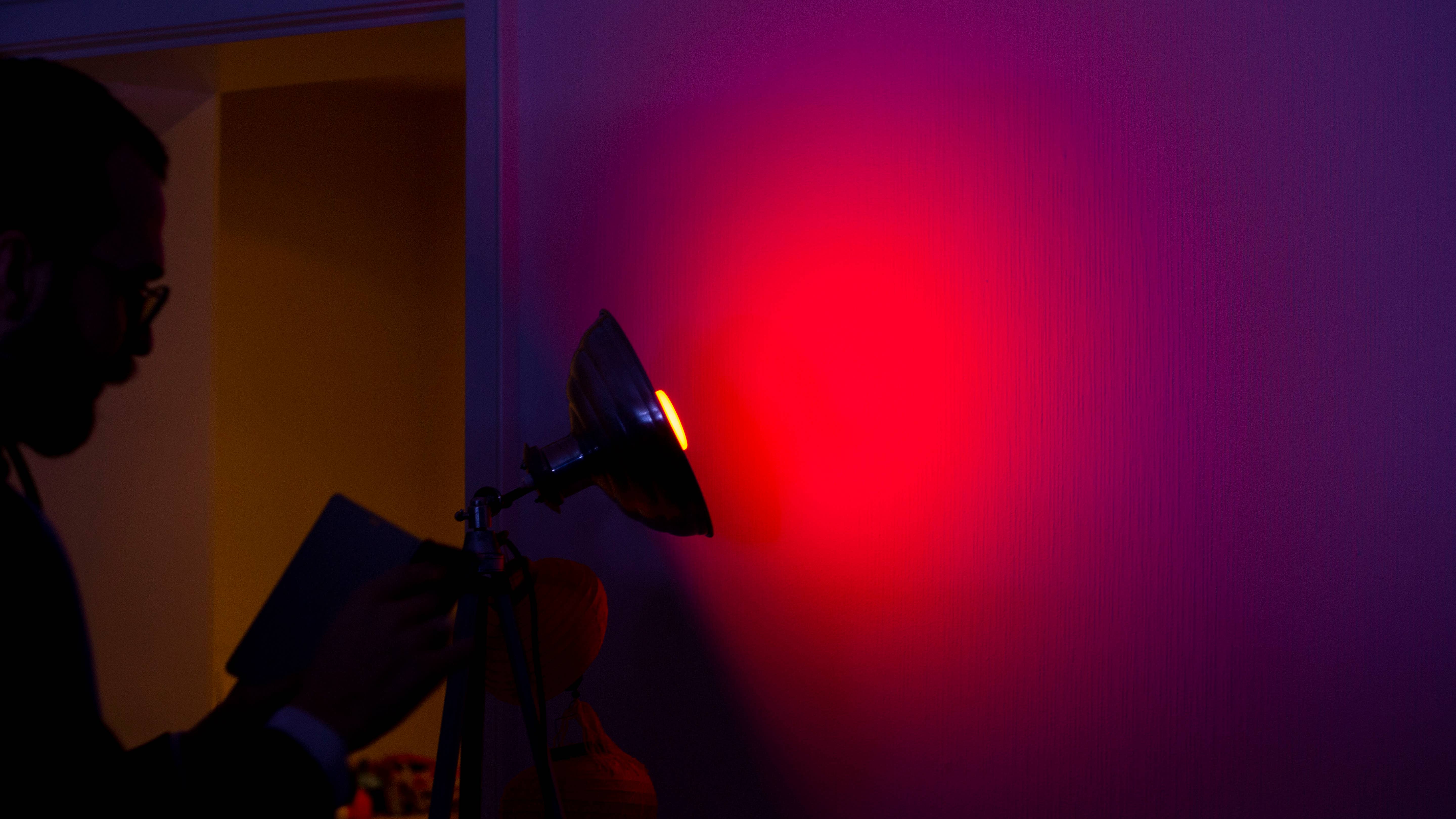

The A60 is particularly interesting for a seemingly simple E27 LED bulb, as its brightness is stated to be up to 1,100 lumens; a significantly higher maximum value than Philips Hue, for example, which only goes up to 800 lumens. Nevertheless, the LED lamp is able to produce all the colors of the RGB spectrum.
lifx beam 6
The light cone of the LIFX A60 is … / © NextPit Image source: NextPit
lifx beam 7
… but at 100 percent it’s much bigger / © NextPit Image source: NextPit

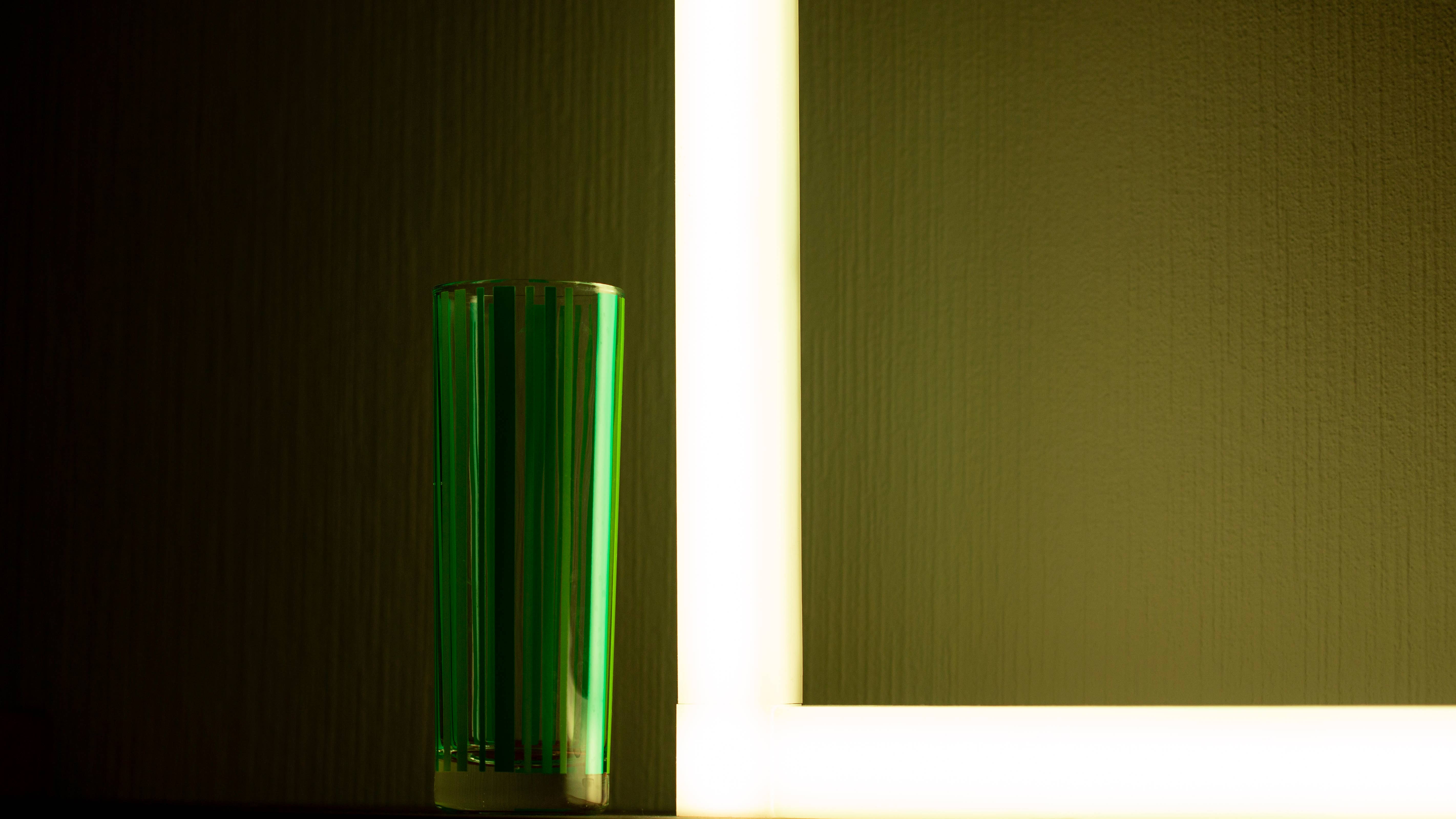

Simple but wobbly construction
You can build the beam either lengthwise, in an L or in a T-shape. You can use the 3M adhesive strips, which are already attached on one side, to fix it to your wall or furniture. If you do not do this, the segments, which are otherwise only magnetically fixed, quickly lose all or part of their contact. They can fall out or behave strangely.
lifx beam 2
Better stick the beam to the wall because the magnetic connection is shaky / © NextPit Image source: NextPit
The power connection, which is also magnetically fixed, is located on a two-meter-long cable that ends at the Wi-Fi antenna. From there, a 0.5-meter long cable goes on to the transformer in your socket. Since the cable only adheres magnetically to the beam, only a slight pull should be applied to it. Interruptions can quickly occur here as well. In our first sample, we even had to replace the cable because of persistent problems.

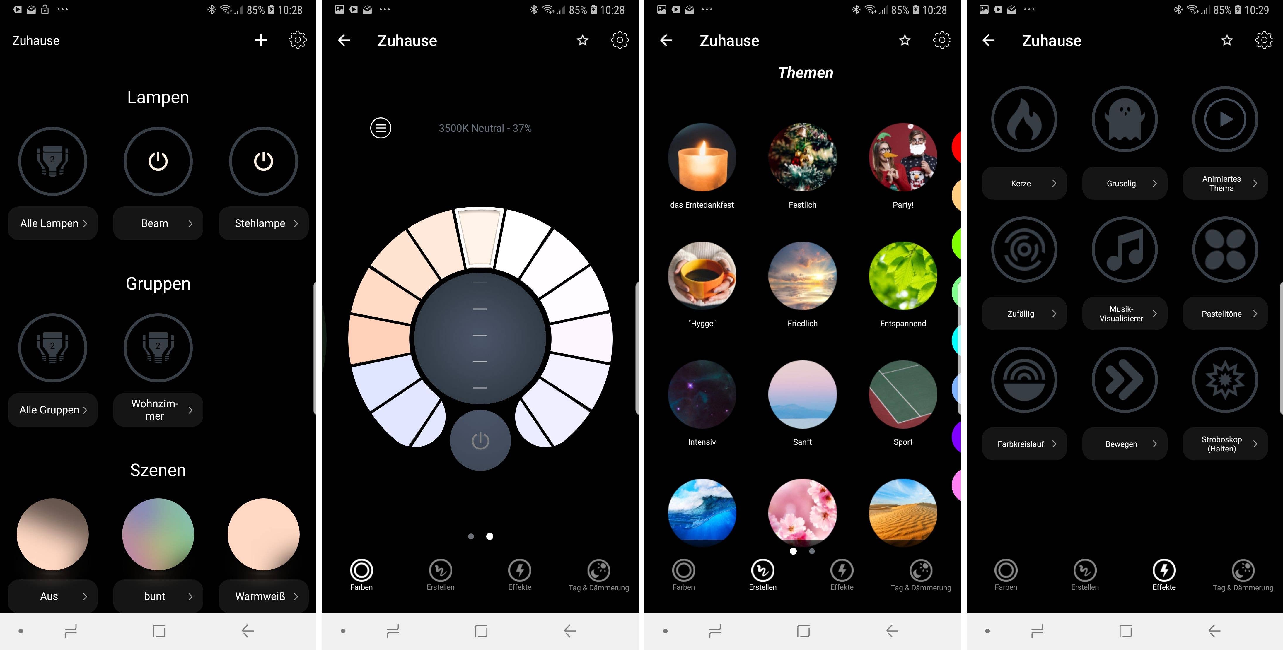

lifx beam 5
Select from 16,777,216 colors and 100 brightness levels in the app / © NextPit Image source: NextPit

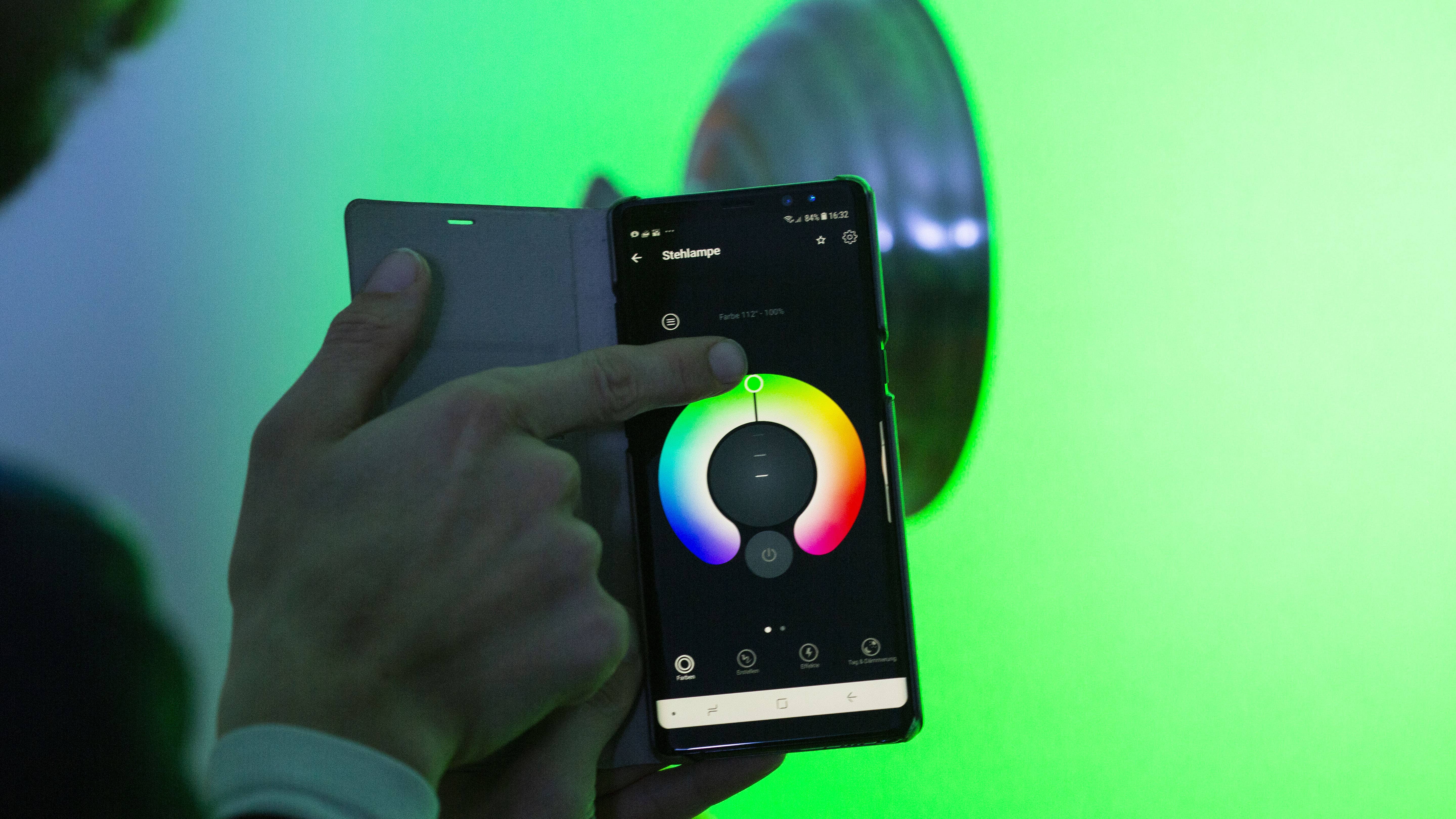

The software is very easy to use . In the basic functions, you set color or white tone and brightness; either by bulb or by room; or for all bulbs in your home at the same time. The respective constellations can then be saved as “scene” and later started via DeepL access. You can also place these shortcuts on the start screen of your smartphone or tablet using the Android widget.
lifx app de 2018 11 a
In the basic functions, you set the bulbs or select animations / © NextPit Image source: NextPit

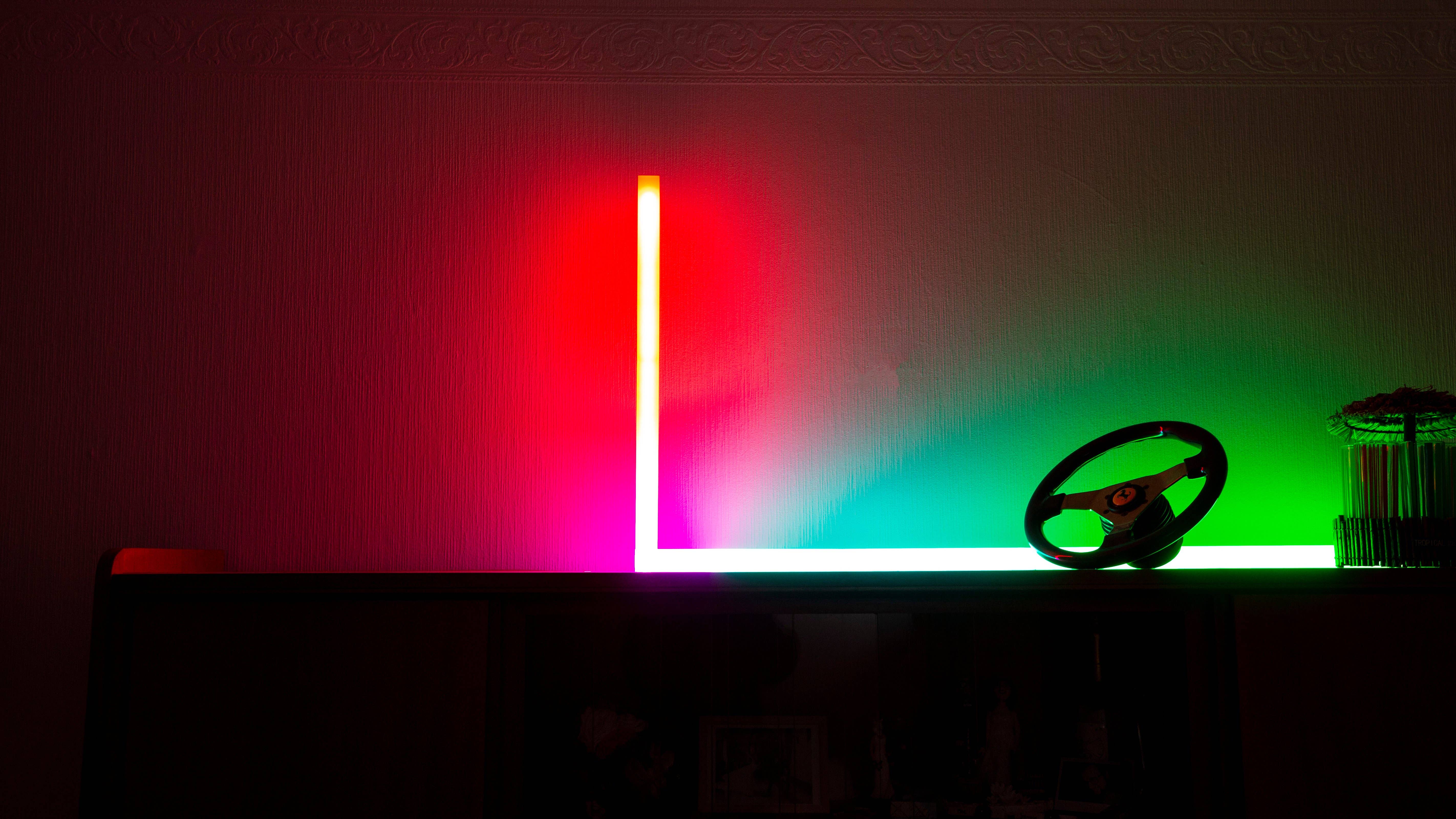

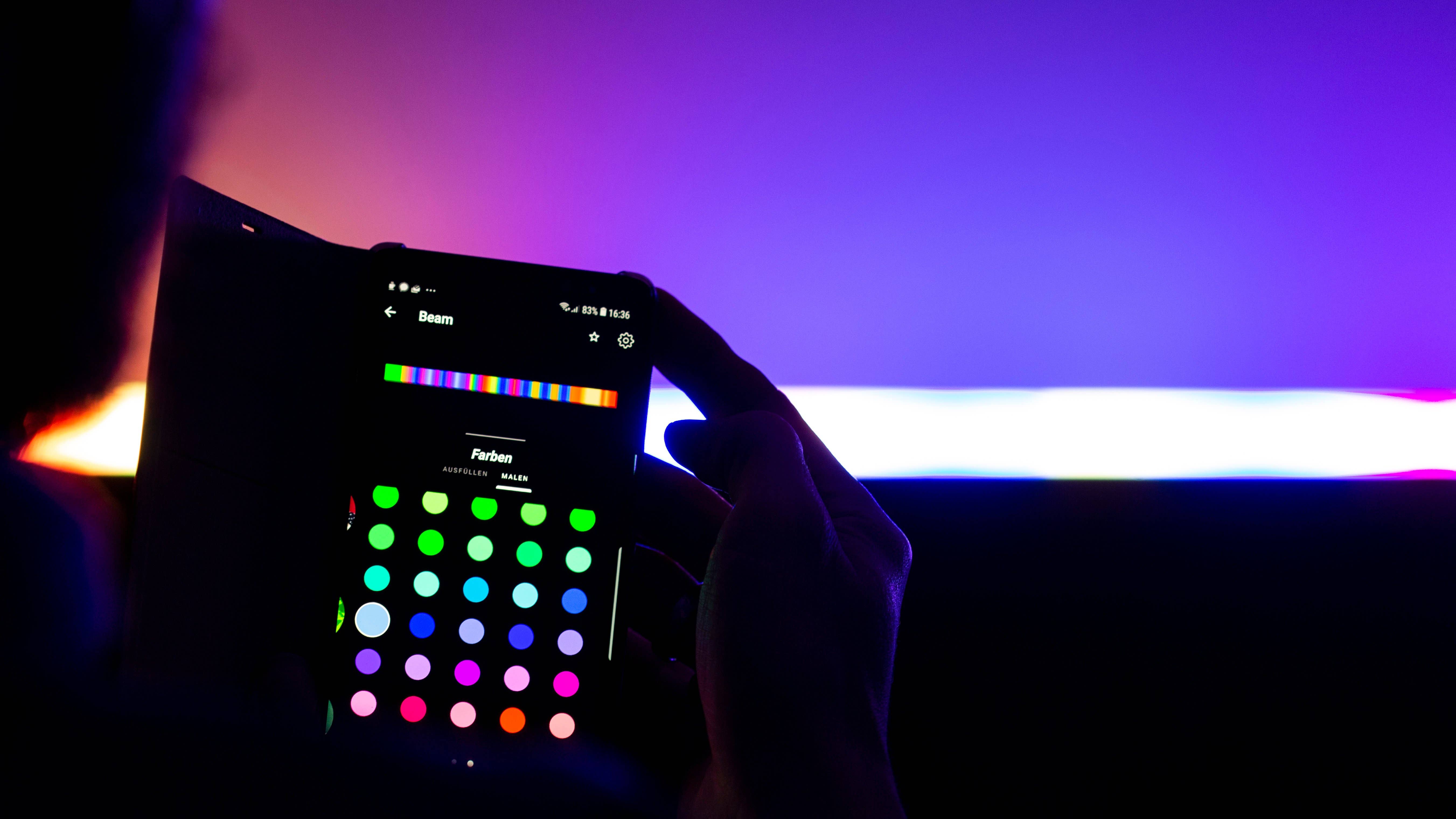

In addition to the basic functions, there are predefined themes that smoke rooms with several LIFX lamps in a colorful mood. Due to its structure, the beam can display several of these colors at once. The app also offers the option of drawing colors over its entire length.
lifx beam 8
Colour your wall with the LIFX Beam / © NextPit Image source: NextPit

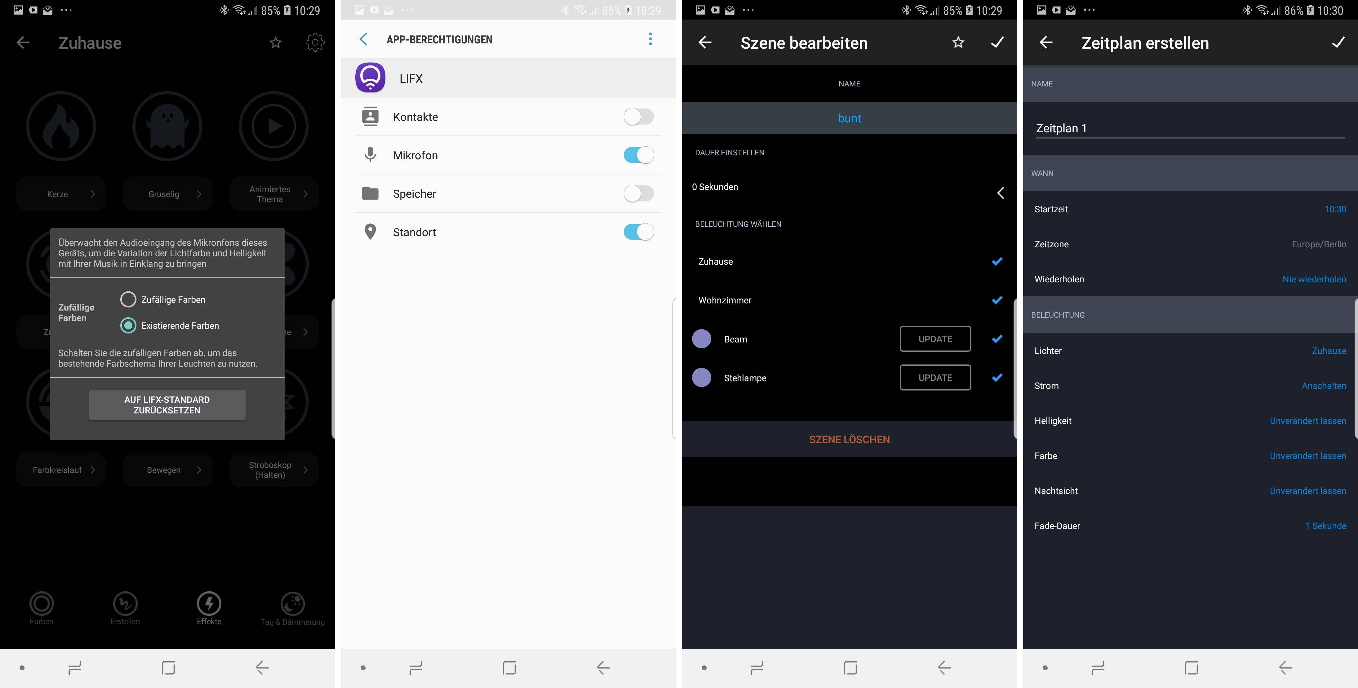

If that’s not colorful enough for you, the LIFX app also offers animation schemes. So you can make the bulbs flicker like a chimney fire. Or you can let the lamps oscillate to the beat of music. The latter option permanently listens to the microphone of your smartphone. Not only does this feature turn your smartphone into a bug, it also worked badly in my tests. The beats were not recognized accurately and the hoped-for disco effect did not occur. So I worked with the quieter “Random” effect, which chaotically shifts the RGB spectrum with all the lamps.
lifx app de 2018 11 b
The “music visualizer” requires the microphone authorization. Apart from a recoverable privacy risk, the effect is unfortunately minimal / © NextPit Image source: NextPit
