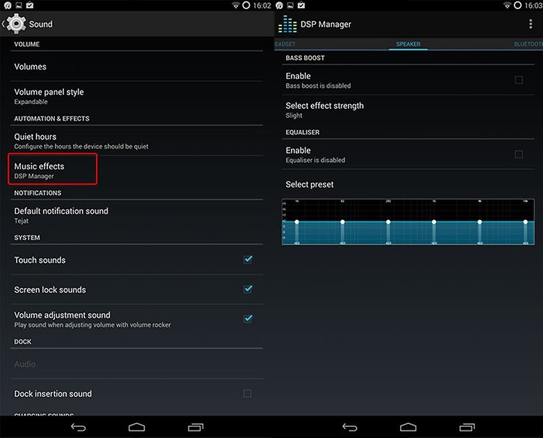

Poor sound quality
Considering the price of the device, the sounds that the Moto G can produce are pretty clear. Of course, there may some bugs or issues with it that can be tweaked. In general, because the speakers are on the back of the device, there may be some distortion if not using your headphones to listen to music.
![motog3](https://fs.npstatic.com/userfiles/4471351/image/Motog/motog3-w782.jpg)
A possible solution is using the equalizer to tweak the sounds to your liking. In order to do this, go to Settings > Sounds > Audio Effects. You can play around with the audio output to the speakers or even to wired headphones.
