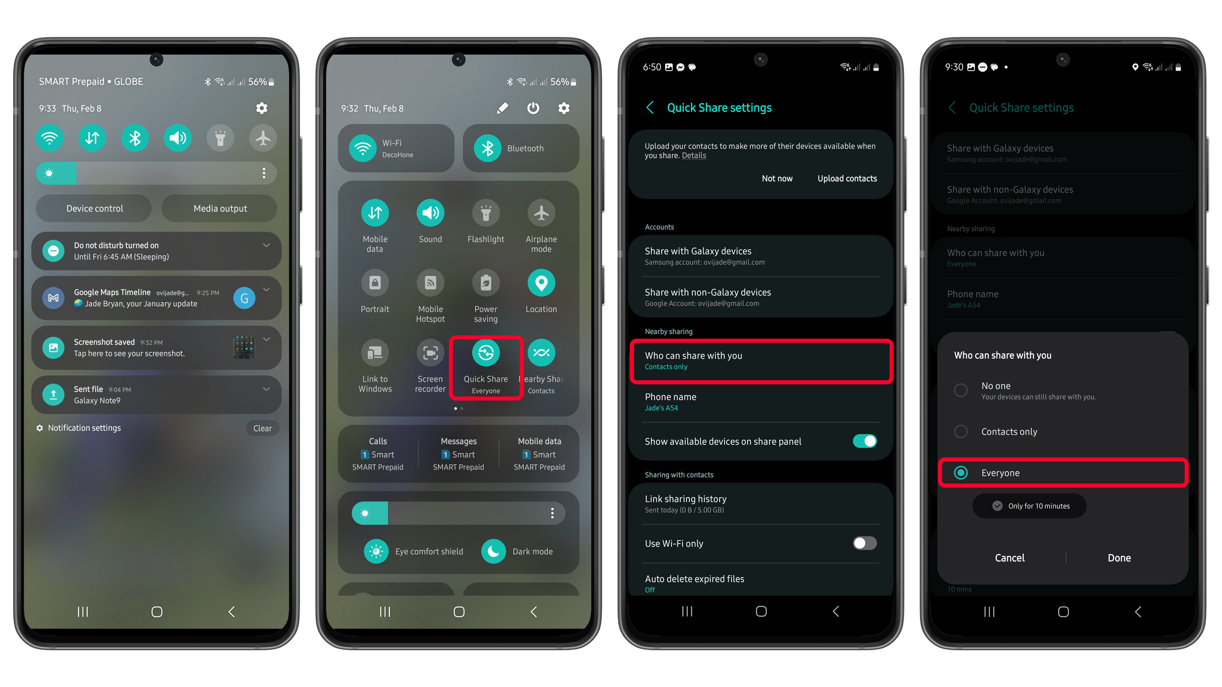

Enable Quick Share
Firstly, it is important that Bluetooth, Wi-Fi, and Quick Share are enabled on a Galaxy device and the receiving device before using Quick Share. All these three can be toggled on from the quick panel.
  1. Unlock your device.
  2. Swipe down from the top of your screen.
  3. Toggle on Bluetooth, Wi-Fi, and Quick Share icons.
How to use Quick Share on a Samsung Galaxy phone
Enable Quick Share from the quick panel. Long press on the icon to open its settings. / © nextpit Image source: nextpit
You’ll also need to check that you have enabled the share to everyone option from the Quick Share settings by long pressing the icon from the quick panel. Below is how to access the settings on your Galaxy smartphone or device through navigating from the settings.
  1. Open your device’s Settings.
  2. Look and select Connected devices.
  3. Tap Quick Share to open its Settings.
  4. Look and choose Who can share with you from the settings.
  5. Pick Contacts only if sharing with your contacts or Everyone.
    1. You can also limit the visibility if you picked Everyone.
You can also access the Quick Share settings right when during sharing by selecting the triple vertical dot or more option from the top right menu.

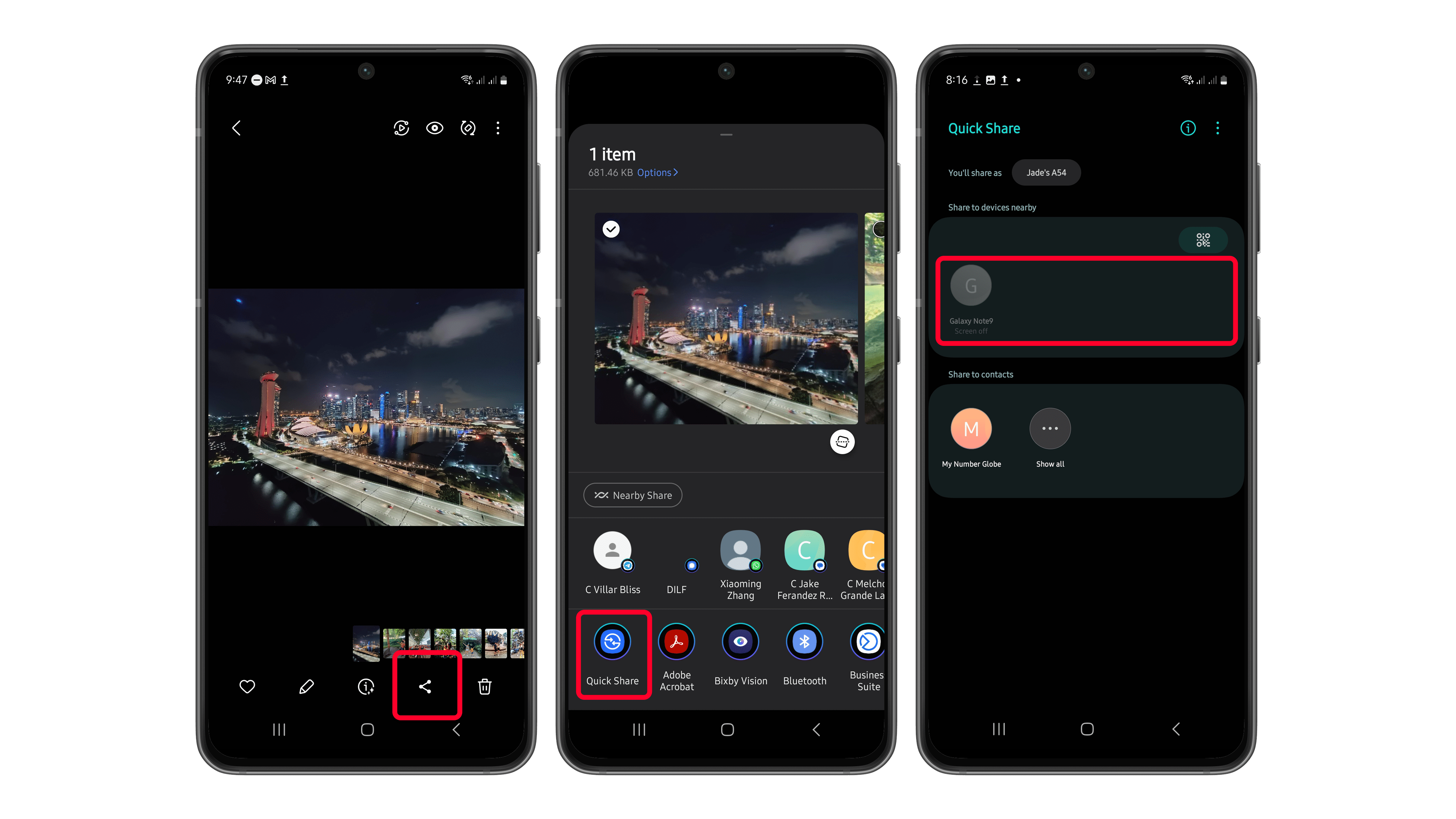

How to Quick Share to nearby devices
If you have switched on Bluetooth and Wi-Fi and Quick Share from the settings, you are ready to share files. It’s also necessary to have the device you’re sending to waked or unlocked. Plus, you’ll need to have Quick Share installed on compatible Windows PCs and laptops. Refer to the step-by-step guide below.
  1. Select which file to share.
    1. Photos, videos, and other multimedia formats can be shared from gallery and related apps.
    2. Files like documents can be sent through a file manager.
    3. You can also share from select apps such as document readers.
  2. Tap the Share icon.
  3. Choose Quick Share from the share sheet options.
  4. Wait for your device to scan nearby devices.
  5. Select which device to send the file.
    1. The receiving device will be prompted to accept receiving the file.

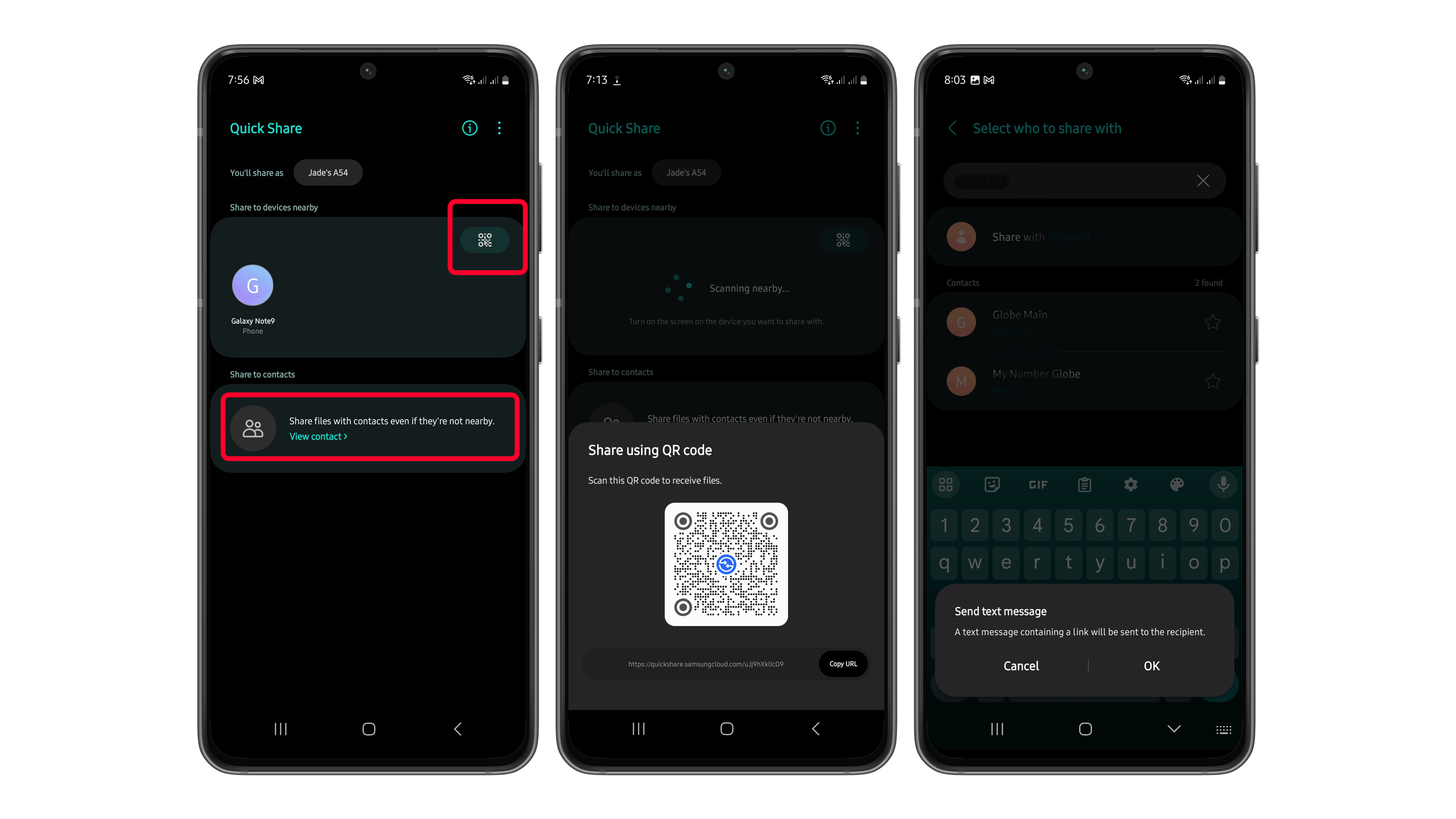

How to Quick Share to incompatible devices and iPhones via QR code or link
As the roll-out of new Quick Share continues, some Android devices won’t support Quick Share. It also applies to iPhone, given the different platform. But it’s also possible to share large files to these devices through Quick Share generating a QR code or a URL link. The latter works with your contacts.
  1. In the Quick Share menu, tap the QR code icon to generate a code.
  2. Let the receiving device scan the code.
  3. They will be redirected to the file URL.
How to use Quick Share on Samsung Galaxy phones
You can use Quick Share to send large files to non-compatible Android or iPhones by generating QR codes or URL links. / © nextpit Image source: nextpit
Alternatively, you can copy the generated URL code and send it via message. There is also an option in the Quick Share menu to send direct messages to your contacts.
