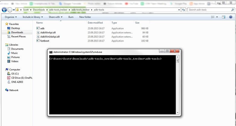

4. Open the ADB Tools folder on your PC. If you don't have it installed already, download ADB Tools here, extract the folders, go to adb-tools_driver > adb-tools_driver > adb-driver and run the 'UniversalAdvDriverSetup' install file.
5. When the installation is finished, make sure that Fastboot is in the ADB Tools folder. If it isn't, download Fastboot for Windows at the link.

10. Open a Windows Explorer window and head to the ADB Tools folder.
11. In a blank space in the window, hold Shift and right click your mouse. Then click on Open Command Window Here.
12. Type in the following command:
fastboot flash recovery recovery-clockwork-touch-6.0.4.5-hammerhead.img

Terribly written. He kept saying Platform Tools, which I assumed to be the android-sdk -> platofrom-tools. But no, he meant abd-tools as per the screenshot. Terrible, uneasy to follow instructions.
