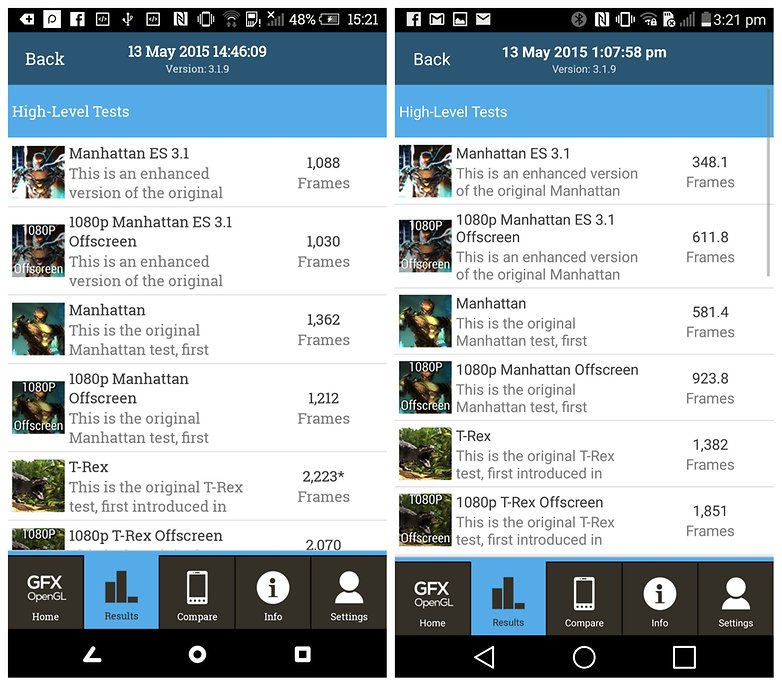

For this test, we used the graphics benchmarking tool, GFXBench. This runs a series of graphics tests that are effectively cut-scenes from videogames. The tests vary in intensity, and give a good idea of the graphical performance of a device, as well as the temperatures it runs at.

The Adreno 430 GPU on the Snapdragon 810 is the more powerful than the Snapdragon 808's Adreno 418 GPU on paper, but what happened when we ran them through GFXBench?
At first glance, the results seemed heavily in the Adreno 430's favor. It ran the most demanding test - Manhattan ES 3.1 - at a commendable 18.1 fps, while the Adreno 418 aboard the LG G4 struggled at a lowly 5.8 fps. It's worth taking into account that the Adreno 418 had to run at the strenuous QHD resolution of the LG G4 screen, while the Adreno 430 was dealing with a mere 1920 x 1080 pixel resolution. Despite that, he same scene at 1080p resolutions on both devices ran at 17 fps on the Snapdragon 810, and 10fps on the Snapdragon 808 - a large difference at such low frame-rates.

The Snapdragon 810's Adreno 430 GPU (left) comfortably beat the 808's Adreno 418 GPU (right). To get FPS scores, just divide the above numbers by 60. / © ANDROIDPIT
The results were considerably closer in less strenuous tests. In the 1080p T-Rex Offscreen test, for example, the Adreno 418 clocked 31 fps, while the Adreno 430 managed 35 fps. The results didn't fluctuate much when we carried the GFXBench benchmarks out several more times, suggesting that the Snapdragon 810 wasn't suffering from the drastic thermal throttling previously reported on the device.

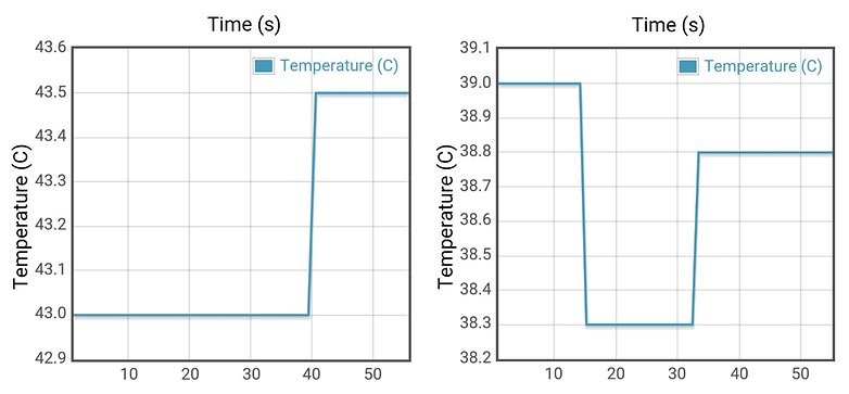

The app we used to benchmark the graphics of the Snapdragon 808 and 810 GPUs also measured the temperatures of the chipsets. Suffice to say that after running the tests five times on both devices, they both heated up a bit. Yet fears of the HTC One M9 turning into a slab of white-hot aluminum were unfounded. Certainly, five degrees celsius is not a negligible difference, but it looks like earlier problems of the Snapdragon 810 heating up to over fifty degrees celsius have been eradicated.
androidpit 808 810 temps 2
Temperatures on the Snapdragon 810 (left) were a bit higher than on the Snapdragon 808 (right) after the graphics tests, but not nearly as alarming as they were a few months ago. / © ANDROIDPIT
As our graphics test showed, the higher temperatures didn't lead to worse performance for the Snapdragon 810 device.

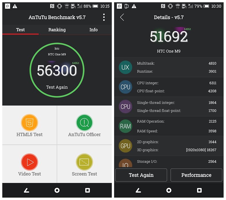

AnTuTu benchmarks should by no means be treated as gospel, but running them five times in quick succession on both of our test devices gave a good idea on whether the Snapdragon 810 suffers from thermal throttling.
After running the AnTuTu benchmarks five times on the HTC One M9 (Snapdragon 810), the benchmark scores decreased steadily with each successive test, dropping from 56,300 in the first test, to 51,692 in the fifth test.
androidpit htc one m9 antutu
The benchmark score on the Snapdragon 810 device (One M9) dropped slightly over five tests, but not enough to suggest some kind of drastic thermal throttling. / © ANDROIDPIT

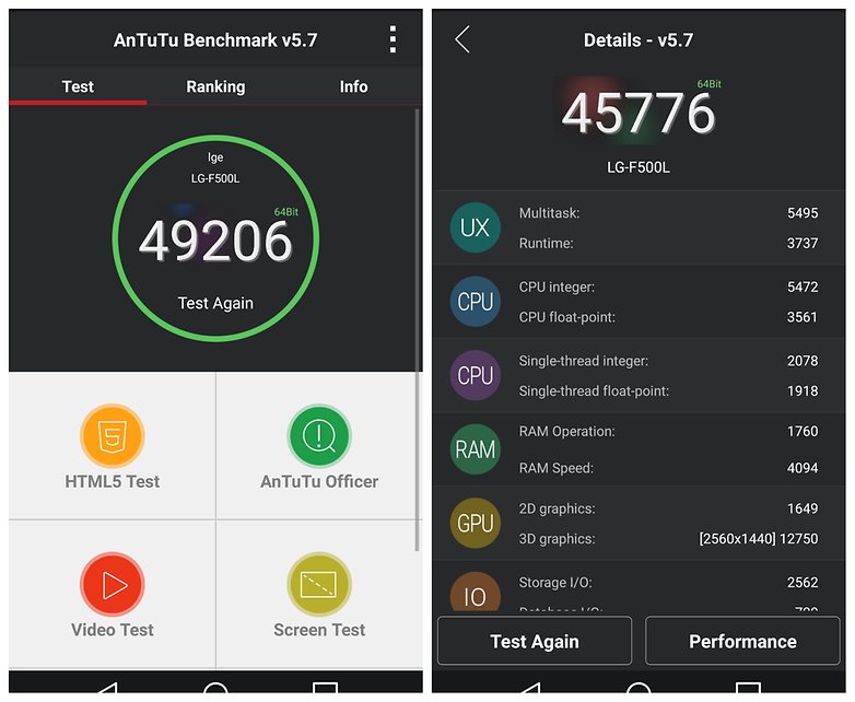

Running the same benchmark test in quick succession on the LG G4 (Snapdragon 808), it was a similar story, with the first test clocking 49,206 and the final test getting 45,776.
androidpit lg g4 benchmark test
As expected, the Snapdragon 808 (LG G4) AnTuTu score was a bit lower than the 810's, and decreased at a similar rate when tested five times in a row. / © ANDROIDPIT
These tests suggest to us that thermal throttling kicks in gently on both 810 and 808 chipsets when put under the moderate strain of AnTuTu benchmarking. We did not find that the Snapdragon 808 was better at keeping up a stable performance than the 810 when put under strain.

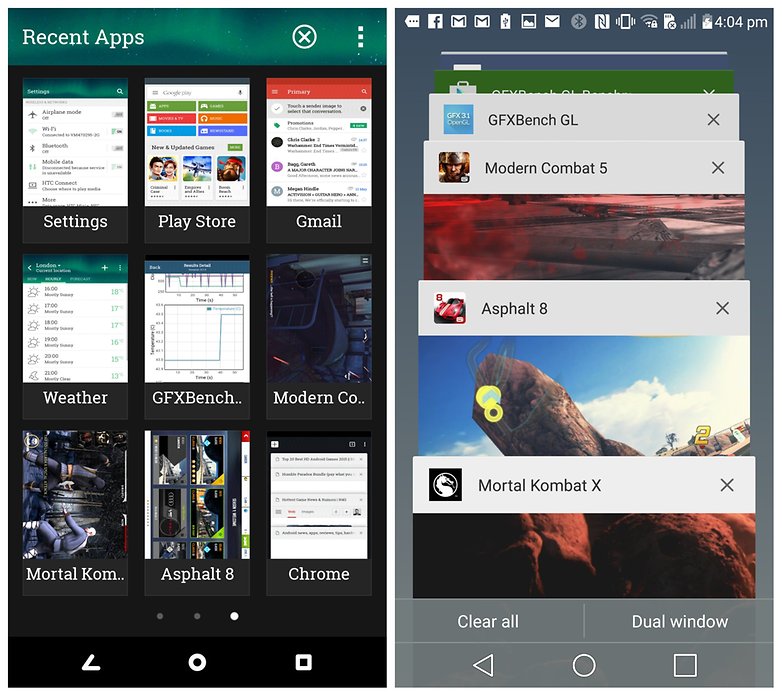

When we reviewed the HTC One M9 and and LG G4, we commended both phones for their flawless multi-tasking. Here, we pushed both devices a bit harder, running the games, Asphalt, Mortal Kombat X and Modern Combat 3 simultaneously, while also having ten tabs open in the Chrome browser.
androidpit 808 810 multitasking
The Snapdragon 810 device was better at running apps in the background than the Snapdragon 808. / © ANDROIDPIT
Neither phone took too kindly to having so much strain put on their resources, but the 810 proved itself a bit more of a willing by letting two of the three CPU-intensive games run in the background and then be re-opened from where you left off. The LG G4/Snapdragon 808 would force-close two out of the three games, so re-opening from the Recent Apps menu would result in them opening afresh.
