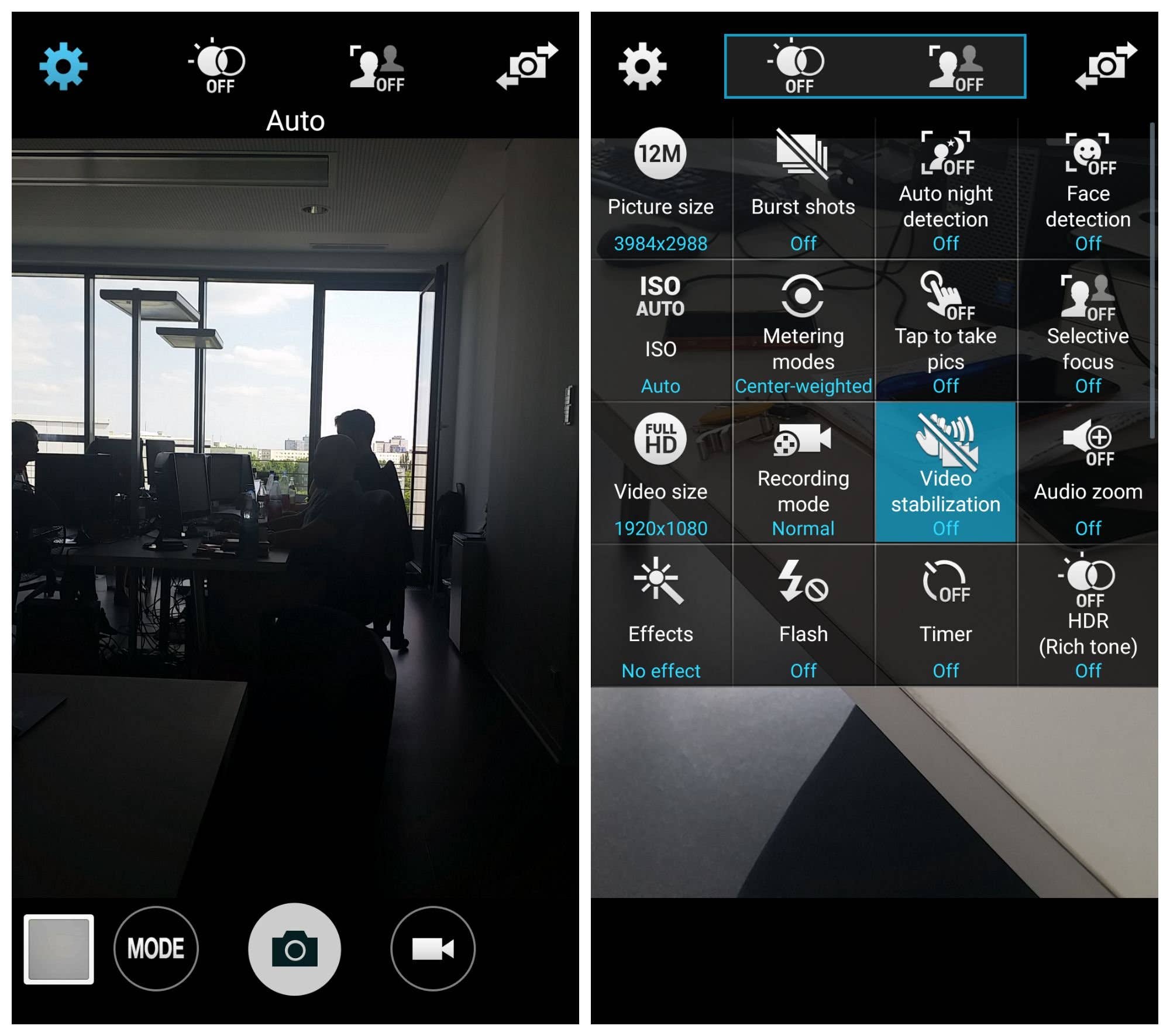

3. My Galaxy S5 camera crashes
If you find the Galaxy S5 camera crashes you can try a few options. First, turn off your phone and wait a minute, then start it again. This simple trick helps surprisingly often.
Secondly, try toggling video stabilization on and off. This was an early fix for the problem and can be accessed in the camera settings. Just go to the camera app and tap the cog icon, then tap the Video Stabilization tile until it says ‘Off’.
Thirdly, you might just need to clear the app data for the camera. Make sure you have a backup of your photos and then go to Settings > Application Manager > Camera and clear the cache and data. If this still doesn’t work, try using a different camera app from the Play Store.
If the camera closes unexpectedly, followed by the message: ‘Camera failed’ or ‘the camera application is not responding’, things are more serious. This error is a hardware issue that affected some S5s. If your phone is one of them, you’ll need to contact Samsung or your retailer.

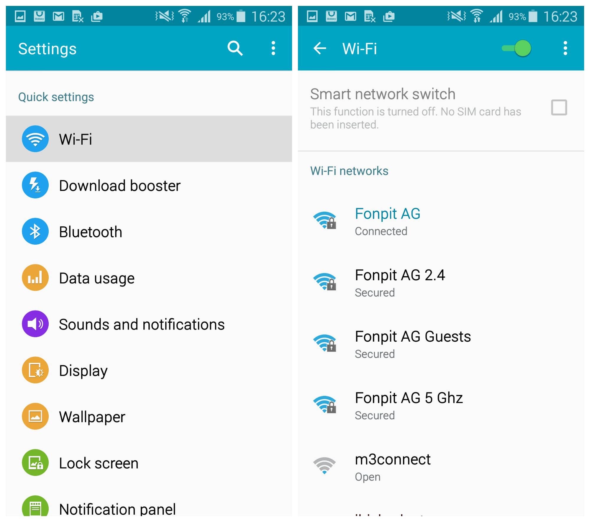

9. Wi-Fi problems
The Samsung Galaxy S5 issues continue in Wi-Fi land. Before we go pointing fingers though, the S5 has an option that makes Wi-Fi shut off automatically if the connection is very bad. It’s called Smart Exchange and will switch you to cellular data if Wi-Fi is bad, so make sure your Wi-Fi ‘problem’ isn’t related to this. Go to Settings > Wi-FI Settings > Smart Network Switch to check.
Wi-Fi dropout can also happen when you open the Google Play Store or some other application. If you think your Wi-Fi issues are related to an app, try disabling it in Settings > Application manager and see if your Wi-Fi problems go away. You can also try clearing the cache of the app that causes the disconnection (or the whole system cache), or check out our guide on how to improve Wi-Fi signal on Android.
