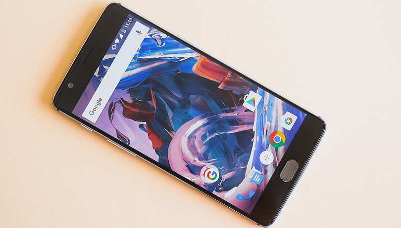

There’s a single spec in the OnePlus 3 that's almost comically large – that 6 GB of RAM. When many laptops still don’t have more than 4 GB, is it a waste to have so much in a smartphone? We now have confirmation that the OnePlus 3 doesn’t utilize all 6 GB of RAM by default. Below, we show you how to use all of it.
AndroidPIT oneplus 3 6685
The OnePlus 3 has RAM you can't use by default. / © NextPit
In several tweets, OnePlus co-founder Carl Pei recently confirmed that the OnePlus 3 doesn’t make use of all its RAM in an effort to minimize battery drain. As such, it can’t run more than three or four applications at once, which is essentially the same performance as current flagships which have up to 4 GB of RAM.
Pei said the extra RAM was available for power users who wanted to make the most out of it. Third-party ROM developers will be able to use all of it after OnePlus released the kernel, allowing firmware developers to adjust how much RAM is used. What this means is that OnePlus has effectively built a phone with 6 GB of RAM, but which users can’t have full access to.
Unused RAM is wasted RAM, as the saying goes. Android does a good job of managing how much of it apps are using, but the OnePlus 3 is built to waste RAM capacity by default. Rather than say this device is ahead of its time, it’s clear that 6 GB is simply too much right now.
Until Android can run more applications simultaneously, is there really a need to boost RAM to 6 GB? If it goes unused, or using it all leads to increased battery drain, there doesn’t seem to be much point.
