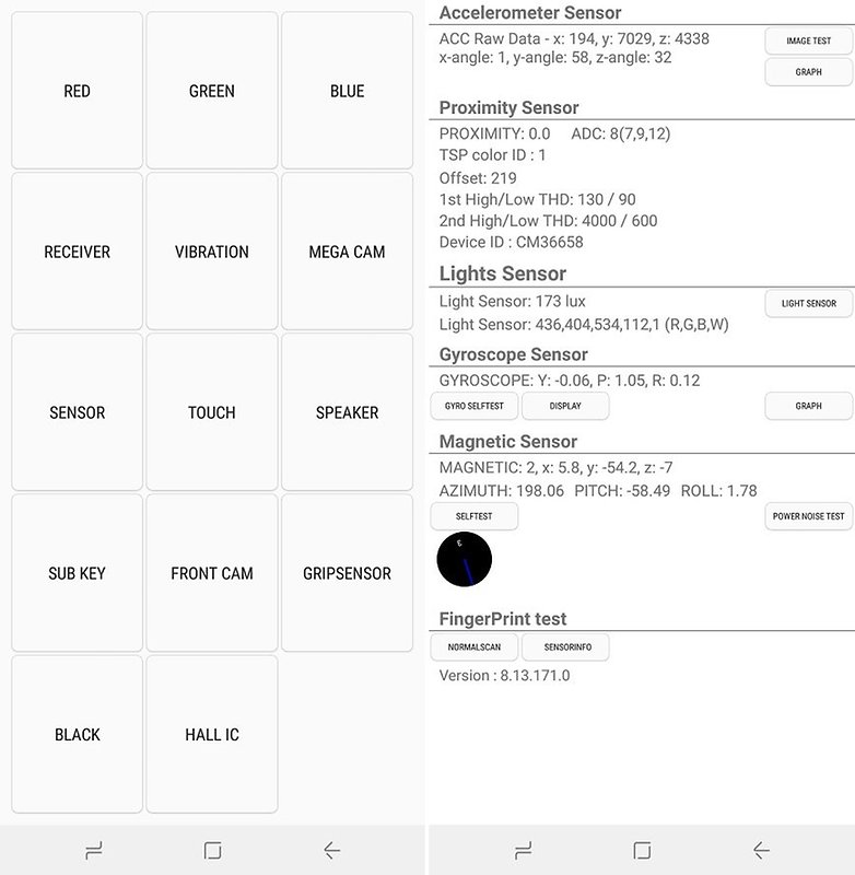

  1. On your phone dial on the telephone keypad *#0*# This brings up a "secret" service menu as shown above.
  2. You will see a list of tiles, tap one named "sensor"
  3. Now in real time you can see all the sensors on your phone, the compass is the circle at the bottom with a line through it pointing to north.
  4. If the compass on the phone is calibrated correctly the line going through the circle should be colored blue with a  number 3 next to it.
  5. If you have a green line going through it and a number 2 this means it is not properly calibrated on one axis, so you need to do the figure 8 dance as described in the above method (preferably outside not near any magnetic fields).
  6. The check that the line going through the circle is now blue with number 3 next to it.
