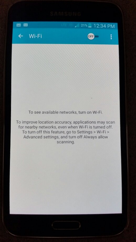

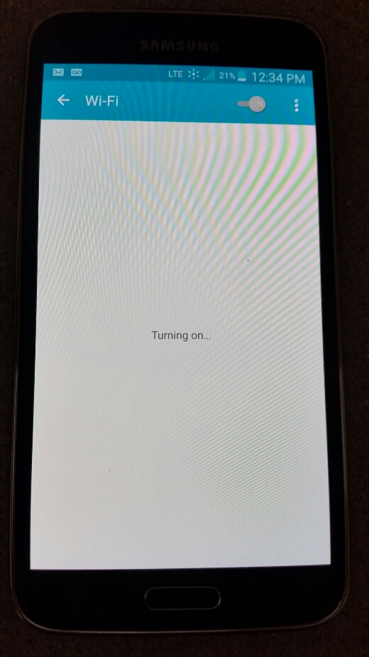

Kurtis Thompson
Jul 22, 2015, 9:43:20 PM via Website
Hey guys, been having the same kind of problem with my wife's phone. Tried factory reset, tried clearing the cache, tried going to settings and using the "WiFi Help" just to be sure... her wifi doesn't even turn on.
When I tap the WiFi tab to turn it on, it doesn't move and in the WiFi connections area it just says "Turning on..." and doesn't.
uploadedImage1437594097304
And then...
uploadedImage1437594142739
Any ideas?? Thanks in advance guys..

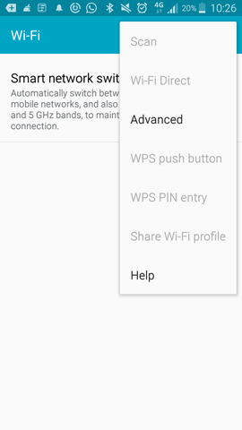

Dr. J
Nov 17, 2016, 11:09:46 AM via Website
Found a workaround that I have not seen mentioned above. Created an account just to share, because I know how frustrating this bug is!
So yeah my Wi-Fi icon in quick settings also keeps blinking on and off every few seconds.
Things I tried that DIDN'T work:
  • removing battery
  • removing MicroSD card
  • (un)checking Smart network switch
  • updating to Marshmallow (6.0.1 - via PC because no wifi :( )
  • YouTube video 'Fix Samsung Galaxy WiFi problems!!! - Howtosolvei' (no 'ON' button)
  • prayer
Workaround that DID work, and has worked repeatedly:
  1. long press Wi-Fi icon in quick settings
  2. tap menu icon (3 dots in top right corner)
Screenshot_2016 11 17 10 26 32_cropped 1479376983145
  1. tap Help
  2. tap Turning Wi-Fi on or off
