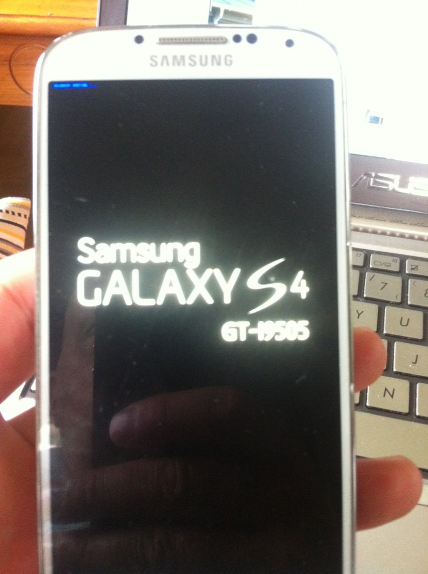

Hello. Read all your forum for help on my samsung galaxy s4. And also tried with failure.
Even in hard reset it gets frozen after realeasing the volume up + home + power button. On the screen the logo is showed and in the left upper corner its says in blue print something about rebooting. But there it stops and I come no further.
Do you have any idea of how to do it?
I cant startup the phone normally either. It gets frozen when the logo comes up.

Robert Pozek
  • Forum posts: 6
Aug 5, 2014, 12:11:29 PM via Website
No. It gets frozen in startup of recovery mode saying in the upper left corner like RECOVEY BOOTING and the logo showing. but its stops there forever

Robert Pozek
  • Forum posts: 6
Aug 5, 2014, 3:13:35 PM via Website
IMG_0002
Robert Pozek
  • Forum posts: 6
Aug 5, 2014, 3:38:07 PM via Website
The text says: RECOVERY BOOTING
  • Forum posts: 770
Aug 5, 2014, 6:58:28 PM via Website
Robert Pozek
this is something new and this blue text will not make any problems
have you tried emergency firmware recovery with kies?
the blue text appears when
you root your phone or sometimes flashing a kernel / custom recovery
— modified on Aug 5, 2014, 7:12:57 PM
Ready To Help You.

Robert Pozek
Yes I have tried with kies. But I dont manage to get the phone connected to kies do its not possible to start up the phone more than to the logo.
Can I connect to kies in another way with the phone you mean?
Odin and kies fails and you can't enter recovery mode so flash a different custom recovery tar in odin. If ur using CWM, then flash TWRP,
switch off the phone
Press and hold VOLUME UP and HOME (middle) button and power key , when you see the blue text ,release the keys
if you still can't access the recovery after flashing a custom recovery then it can be a hardware problem.
