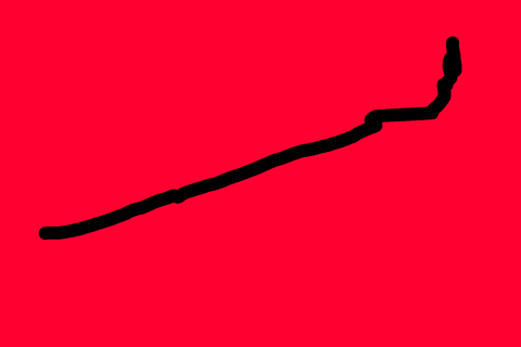

Edit 2012-02-04:
Here's an image that shows the problem.
I drew a diagonal line with my finger, starting from near the bottom left corner and ending near the top right corner.
To start with, the line on the display followed my finger exactly.
As you can see, when my finger reached the "unusable" area at the right, the line wouldn't follow my finger rightwards, though it continued to follow my finger upwards.

I don't think it's a calibration problem. I used the "paint note" function of Note Everything and the "brush" on the display follows my finger exactly, until I reach the start of the unusable area, when the brush stays at the edge of the usable area. I can move the brush up and down along the edge of the usable area, but not into the unusable area.
It seems to me that the finger horizontal position is being clipped or limited. I can see why that could be done temporarily, but the problem is permanent and survives a cold start.

Here's an image to explain the problem better.
As you can see, when my finger reached the "unusable" area, the line stopped following my finger.
It's as if the X-position coming from the touch detector is limited. The Y-position works fine.
painting116
— modified on Feb 3, 2012, 1:40:59 PM

Ah ok..i see what you mean...that is indeed a weird problem. I thought that maybe the pixels in the top upper right corner might be dead, therefore not properly registering the touch. I ve never seen such an issue, so your best bet might be taking it into where you bought it. If its really a screen issue, the screen, or the phone might need to be replaced.

It looks like it is a hardware problem after all.
Sometimes after a reboot, the phone will respond to touches anywhere on the screen, but it registers lots of phantom taps and drags in the right side of the screen. If I run a paint program, blobs and lines appear randomly at the right of the display when I'm not touching the screen at all.
Other times after a reboot, the right side of the touch screen doesn't respond to touch at all, but there are no phantom taps. I think the firmware detects a problem and "locks out" part of the screen.
I will be sending it back for replacement and I'll let you know how I get on.
