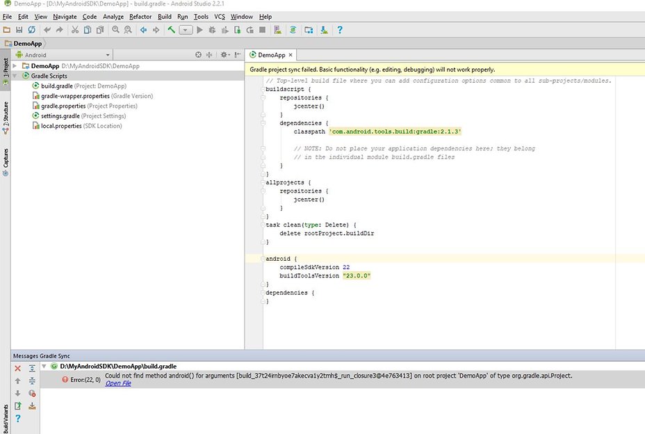

I am learning to become a Android Developer and I am getting the following error after importing a DemoApp lecture/project.
Error:(22, 0) Could not find method android() for arguments [build_37t24irnbyoe7akecva1y2tmh$_run_closure3@4e763413] on root project 'DemoApp' of type org.gradle.api.Project.
I am not sure what to do here, or what is causing this. From what I understand it's something to do with the build or project version?
As I understand it, it is something to do with my Gradle Script or the Build Script, but I dont understand what is wrong.
2018 10 02_06 32 02 2274fa7dfbfdb68d5ed3fb6b23fff9f6
I did some initial research, and found an StackOverFlow article but I can't post the link as I am a new user. But the answer said
You are using the wrong build.gradle file.
In your top-level file you can't define an android block.
Just move this part inside the module/build.gradle file
But I dont understand where you move it to.
Or how I need to fix this.
Can someone please explain what the problem is?
I am using Android Studio 2.2.1

Check whether you have installed Android SDK 23 in SDK Manager.
