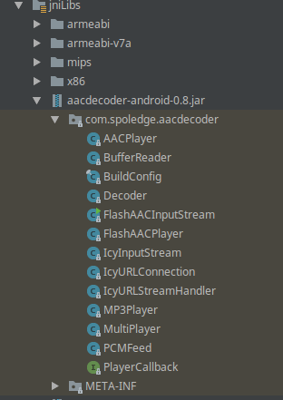

LocucionAR Productora de contenidos
Aug 31, 2018, 12:46:32 AM via Website
Hi,
Yes, BufferReader.class is part of the aacdecoder librery:
Captura_de_pantalla_de_2018 08 30_19 06 33
Yes, I can set a breakpoint, but the problem is that it's not happening in a step, instead, it happen a few minutes later (not always the same amount)
If you prefer, I can send you the project, in that case, tell me an email. I can't post a link en this forum.
Thanks!

James Watson
  • Forum posts: 1,605
Aug 31, 2018, 3:59:16 AM via Website
Hi,
![image][1]
Thanks!
[1]: https://fscl01.fonpit.de/userfiles/7605200/image/forum/Captura_de_pantalla_de_2018-08-30_19-06-33.png
This error about SocketException usually means that there was a network error.
According to your description, is it possible that your app calling the library was stopped from network access several minutes after screen locking due to some device settings about battery saving mode or data saver?
