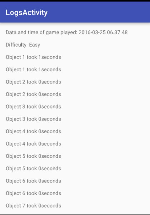

I am trying to write lines of string in to a text file, but I do not know why all the lines are duplicated. I tried to use a code to delete the string but apparently it is not working as well. Capture
Below are my codes that write to the text file, and the code I use to delete the duplicated lines.

Hope someone can advice me on this.

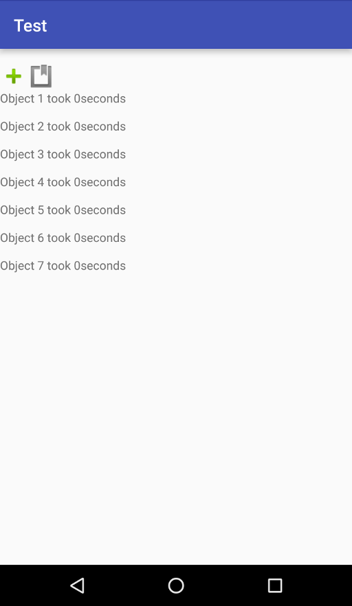

The source code provided appears to work as expected - the following reproduction produces the expected results:

screenshot2 1458909689541
The conditional you tried to use to filter out duplicate lines fails because you emit a second newline in saveText; readfromFile will read "Object 1 ...", "", "Object 1 ...", "", "Object 2 ...", and so on. The following change would likely suffice:
