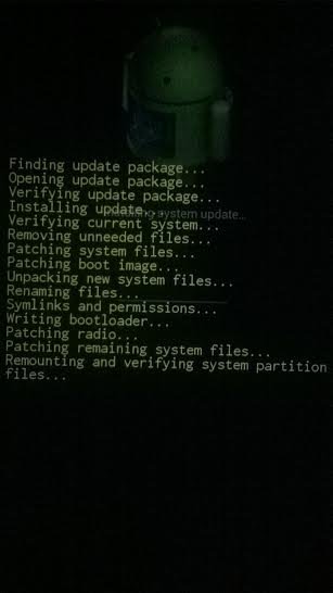

hopefully someone clever out there maybe able to help. Just loaded the OTA Andriod 5.0 which has put my phone into a continually install loop. tried all recovery mode but again just goes back to the install loop. will try and add images later.

Couple of questions first... I presume it's stock recovery, so have you tried the wipe data option again? Does it boot at all? If so, during boot do you get any on-screen messages, or does it just continually show the Lollipop boot? If not, how long does it attempt the install for?
Being a Nexus, it should be recoverable but this info may make it easier.

If you mean do i have a custom rom no i dont its stock andriod. I have attached some pictures that may help.uploadedImage1416425072593 does continually show the Lollipop install but again have an image that may help.if i choose recovey mode again it goes into the install loop. Left it all night trying to install like it gets to a stage then restarts install.uploadedImage1416425267783

I have EXACTLY the same problem. Device shows exactly the same message then hangs in the "Installing sysyem update...." screen forever (over 24 hours!!). If I try to recover, it just goes via the recovery screen straight back to the screen dump you showed.
The phone is completely hosed....unless some bright person can figure out a fix for us!!!
