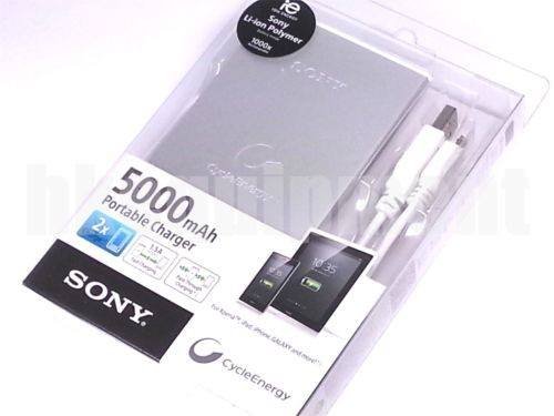

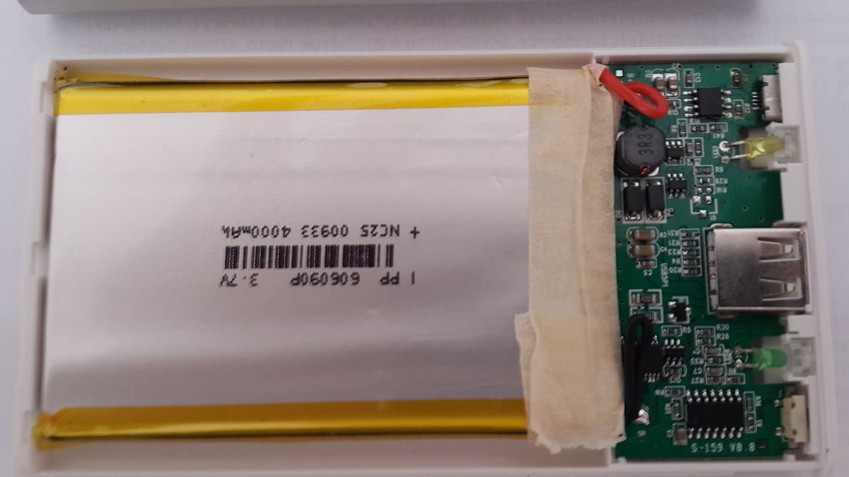

Andres F
Mar 12, 2015, 4:34:54 AM via Website
What do you think about this?
The box says 5000mAh, but internal battery labeled as 4000mAh, original product.
