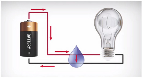

If you happen to drop your phone in water, immediately get it out and
power it off, then what do you do to help save your poor phone? Put it
into a bag of rice to dry it? In fact, rice won't do too much to dry
your phone. It's better to wipe the parts with a clean cloth and lay the
parts in a drafty place; however, after the parts dry what do you do
about the water damage. Here we have submerged an iPhone 5 to show you the steps to diagnose your wet phone and how to save it.

Step 3, Check whether the device is short circuited or not.
Even after phone parts have been wiped and dried, some liquid may
still be left in inside, which will result in a short circuit. First of
all, you can use a multimeter to test if the battery is bad. In most
cases batteries are one of the first things to go. So you may need to
replace the battery. If the battery works fine you'll have to check all
the parts 1 by 1 to find the short.
