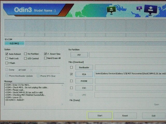

Yes im using custom rom but im trying to flashtock to my origin firmware using odin and i dont know why odin doesn't detect my device.
  • Forum posts: 770
Jun 12, 2014, 1:54:23 PM via Website
Eldrin Jayrerd
disable antivirus from phone and pc
try different versions of odin
install latest version of samsung Usb drivers
use usb port behind the cpu
do not use an usb hub
first clear data and cache from recovery
make sure
Re-Partition-- Unchecked
Auto reboot and F-reset time checked

Eldrin Jayrerd
  • Forum posts: 6
Jun 13, 2014, 6:53:35 AM via Website
it run well and said pass but when im trying to update software it said your "device had been modified". How come ?
  • Forum posts: 770
Jun 13, 2014, 7:04:57 AM via App
Your phone is rooted, you need to unroot to update your phone vie OTA
but flashing usually removes root
Download the latest firmware and flash it with odin
