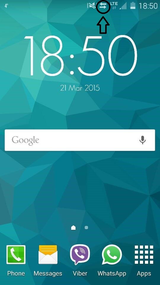

HELP. I need a big, big favour. Yesterday I GOT a new update for my Galaxy S5. And after updating on the notification panel are two arrows from the right and left. Can you please tell me what the hell that mean? I will be very happy if you guys will help me out. I tried to find in Internet about these stupid arrows. Result is 0.

Hello,I have the same. I guess it is for LTE voice. When the net is supported you il, have these arrows

Had the same appear on my Galaxy S5 after latest update, called into "3" shop and told that it means if you have no phone signal then it will connect your call using 4G WiFi.
There is no way to turn off this feature.

I have the same issue. I contacted the tech support with my provider in my case 3. They are aware of the problem and have stopped sending out the recent update. To help fix do the following
Settings
More networks
Mobile networks
Network mode
If LTE/WCDMA/GSM is selected change it to WCDMA/GSM
Then turn off your phone , take the back off your phone to remove the SIM card and but back together, then turn on again. Hopefully you should be able to text.
If this fails you would need to speak with your network support.
I got told this is all due to moving over to 4G voice.(thinking)

or just go to
settings
network connections
more networks
mobile networks
and then you disable the VoLTE Call
its basically the same. it worked for me and i didn't even have to turn off my phone
