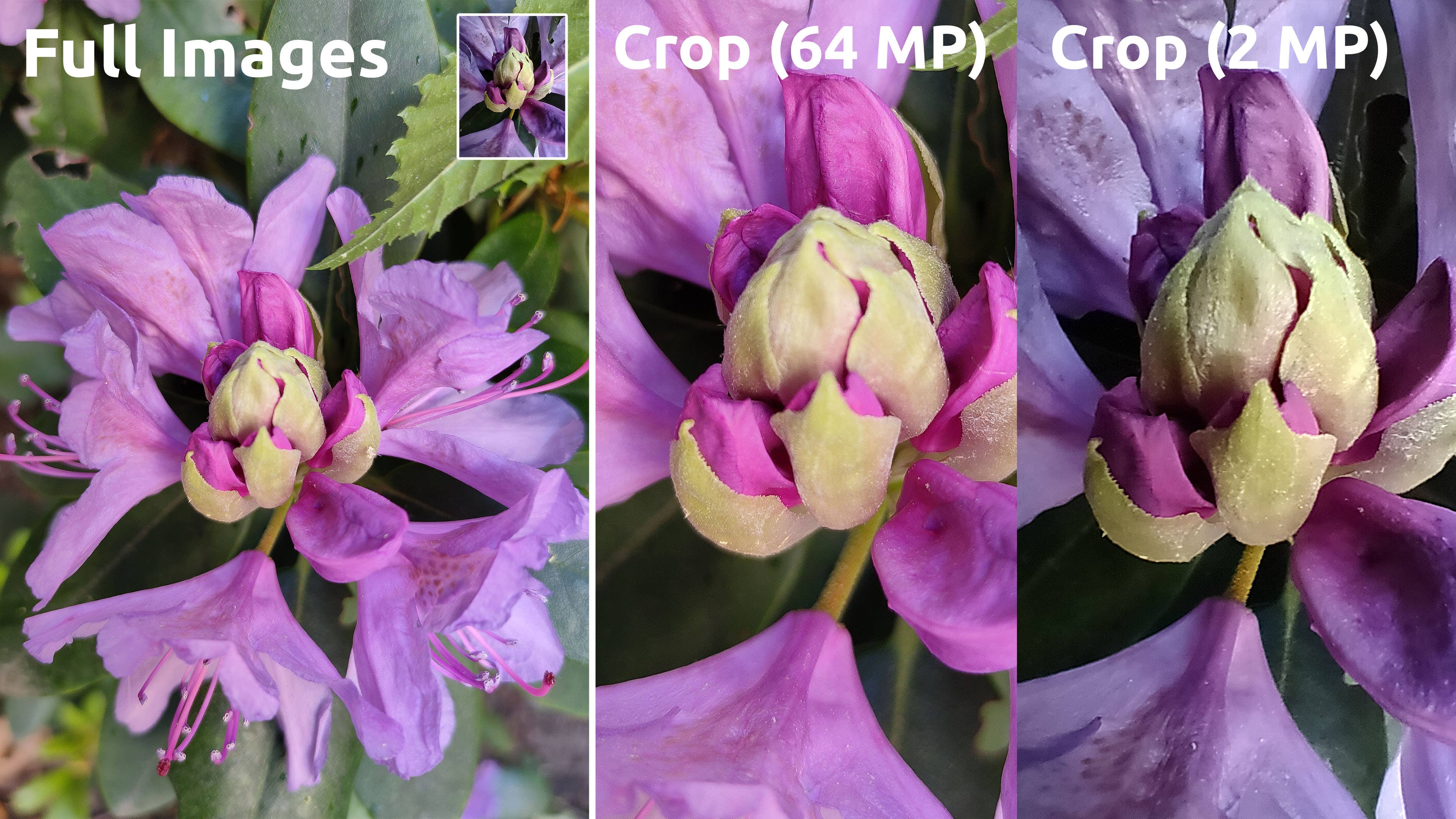

Macro cameras have been another trend in the past few months. However, the foundation is similarly shaky as that of bokeh sensors. The 2-megapixel mini-sensors with their notoriously low resolution are rarely superior in terms of image quality to the results that can be obtained from a reasonable main camera using digital zoom.
AndroidPIT realme x3 superzoom image quality macro stupidity
In the left picture, you can see a 2-megapixel and a 64-megapixel image from the Realme X3 Superzoom in size comparison. A crop does not necessarily give much worse results than the macro camera. This is especially true if you are more careful with the focus than I was with this photo. / © NextPit Image source: NextPit
In contrast to the bokeh sensor, macro cameras actually have an advantage. The notoriously tiny sensors have quite a large depth of field, so that you don’t have to be so careful when taking pictures. And the separately available macro mode in corresponding smartphones invites you to discover the world around in greater detail.
  • All the macro cameras I know of are at best, a nice gimmick. If a manufacturer installs a large-sensor macro camera with high resolution, I might change my mind.

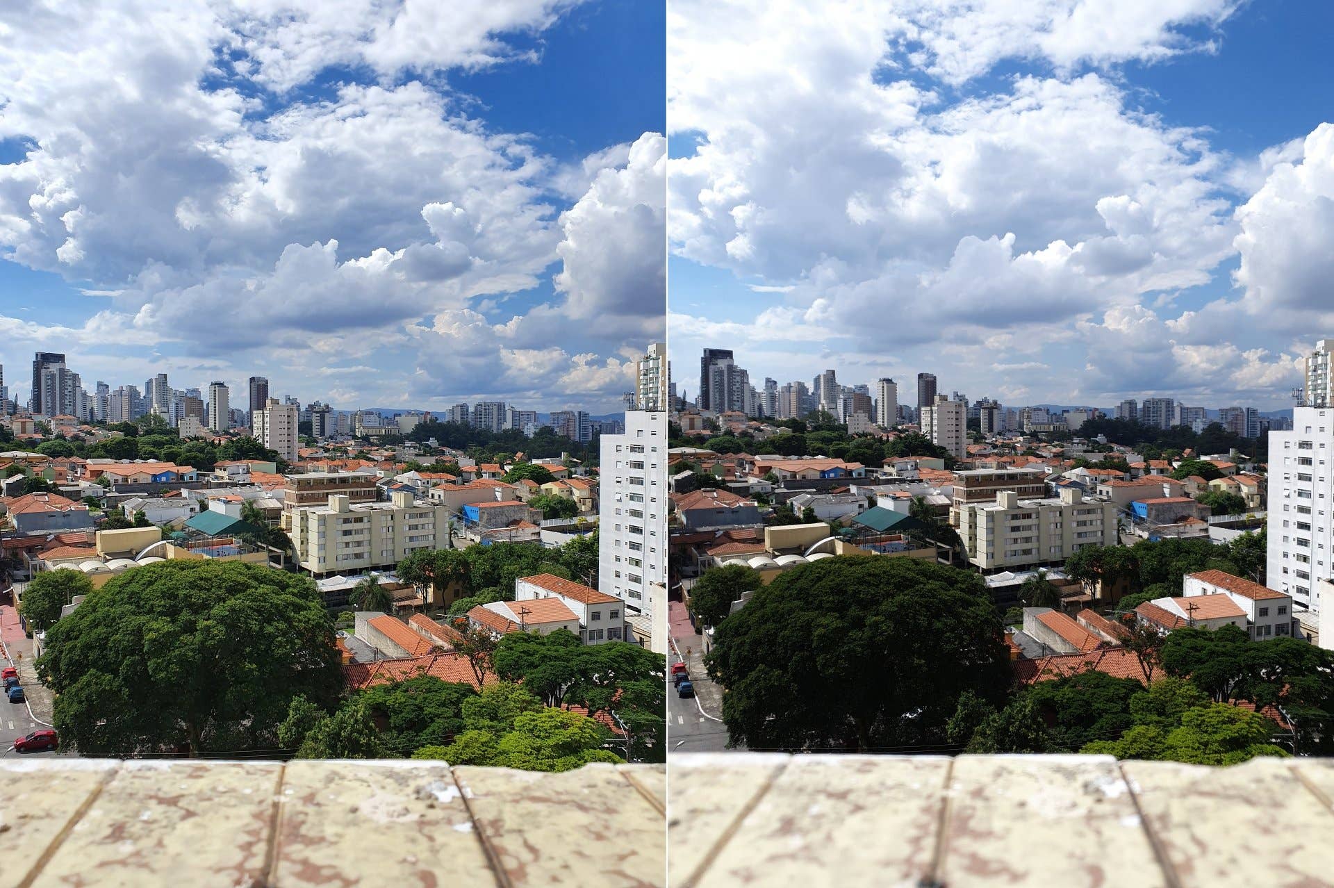

batch 20190313 143555 side
The Samsung Galaxy S10 also benefits from Google’s algorithms. The photo on the left was taken with the Galaxy S10 and Google’s camera app, on the right Samsung’s own app is used. / © NextPit Image source: NextPit
Point two is, the algorithms that capture a photo and work with the sensor data. Here, an interesting development took shape when Google presented its first Pixel smartphone. From that point on, Google decoupled the camera app from Android – and every manufacturer was forced to develop its own camera app.
For big manufacturers like Samsung, Apple, or Huawei, this was not a problem. Within a few months, Google’s camera team had more or less caught up with their rivals’ lead. But for smaller manufacturers such as HTC, OnePlus, or LG, they had to struggle quite a bit to develop their own camera apps, at least at the beginning.
Large manufacturers with large development capacities not only find it easier to incorporate a wide range of functions in their camera apps, but can also afford better algorithms. The differences in quality are especially noticeable in the various night modes.
