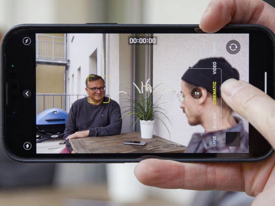

Cinematic Mode is prominently featured in the Camera app of the new iPhones, located between the Video and Slow Motion modes. A tap will activate the respective mode, and the record button begins (surprise, surprise!) the recording.
By default, the camera app highlights all recognized faces and animals, for that matter, while recording. While the recording is running, the Cinematic Mode tries to determine the most active person and set the focus accordingly. However, you can also shift the focus manually by tapping on the display.
In the following video, you can see how the focus only changes automatically when Benjamin Lucks speaks to the camera in the foreground. Otherwise, Cinematic Mode keeps the focus on Fabien Roehlinger until we manually change it with a tap of our finger.

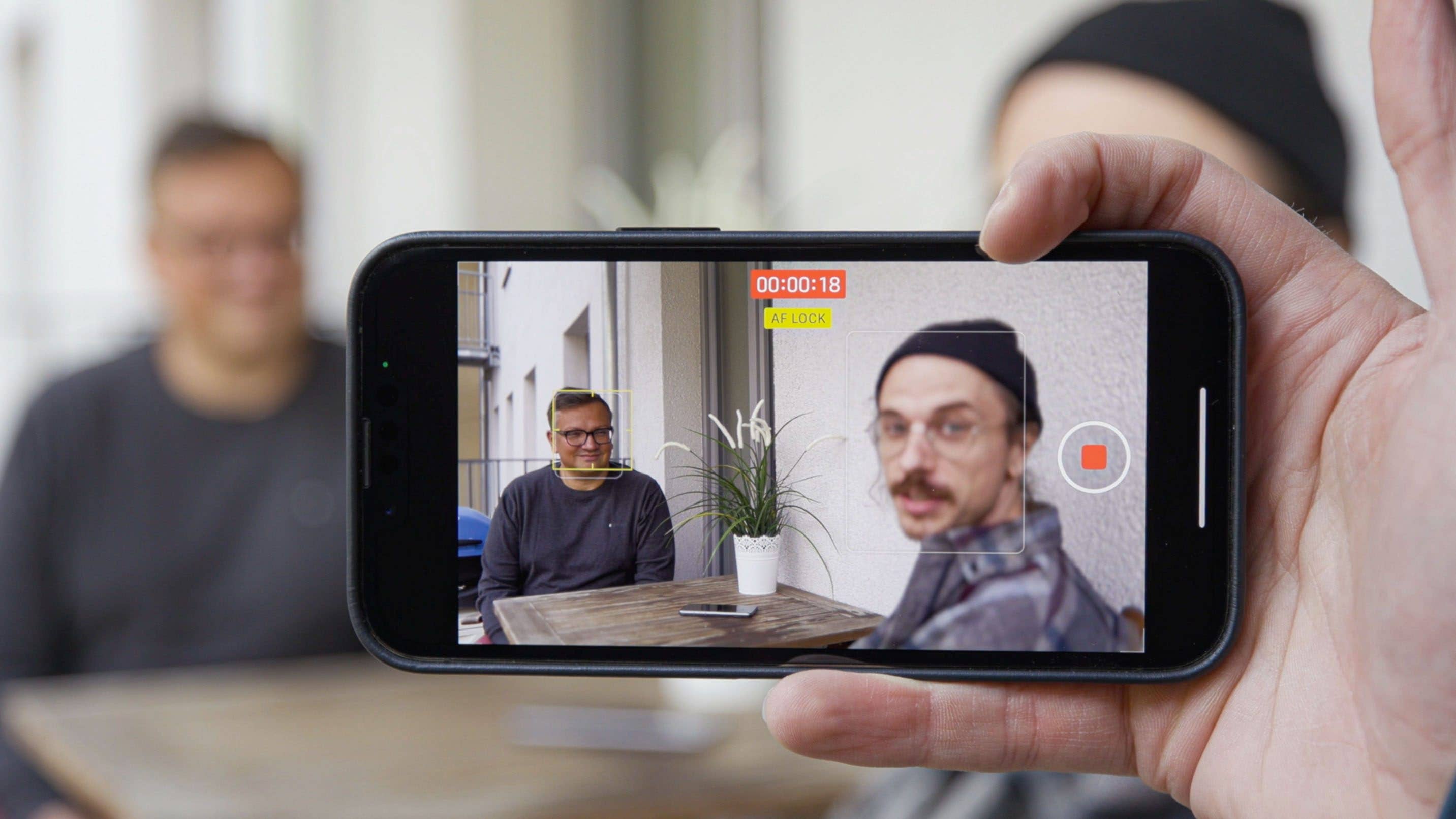

By the way, “manual focusing” works not only with people but also with objects. The Cinematic Mode then tracks them and keeps them in focus. With a long tap, you lock the “virtual autofocus” to a certain distance and thus keep, for example, a person or an object in the foreground in focus, no matter what is happening in the background.
Cinematic mode on iPhone
Hold your finger on a point in the display for a long time to activate the “AF Lock” in cinema mode. Ben can now speak into the camera as long as he wants – the focus remains on Fabi / © NextPit Image source: NextPit

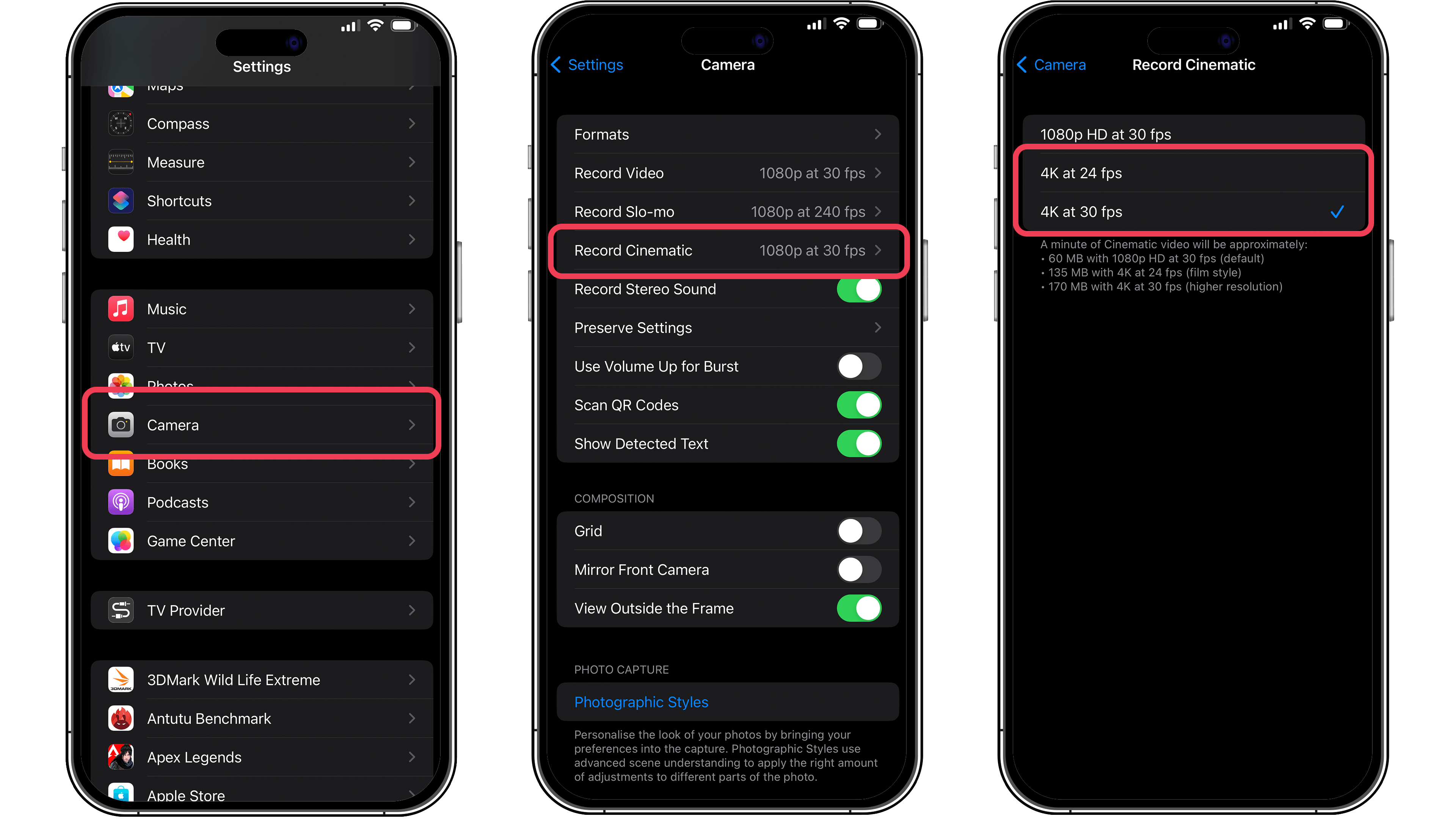

Users can access the feature by opening Camera > swiping to Cinematic Mode. However, the default resolution is at 1920 x 1080 pixels at 30fps. You need to enable the crisp 4K resolution right from the settings. Below are a few steps on how to activate and use the mode with a higher quality.
  1. Open Settings.
  2. Select Camera.
  3. Tap Record Cinematic.
  4. Choose 4K at 30fps or 4K at 24fps (film style).
Screenshots showing how to activate 4k Cinematic videos
iPhone 14 Pro Max: You can enable Cinematic Mode from the Camera section in Settings / © NextPit Image source: NextPit

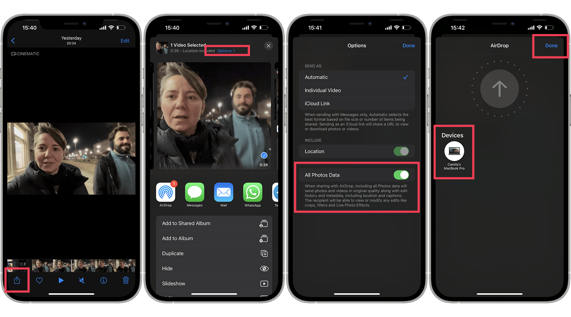

The first thing to know about editing videos on another device – like a MacBook – is that you will have to send the clips via iCloud Photos or AirDrop. Otherwise, you’ll lose the depth information that the iPhone stored in Cinematic Mode. Before doing that though, make sure that the option All Photos Data is toggled. Here is how to do that:
  • In the Photos app on your iPhone, open the Cinematic mode clip or select multiple clips, then tap the Share button
  • Tap Options at the top of the screen, turn on All Photos Data, then tap Done (you will need to turn this option on each time you transfer using AirDrop).
  • Tap AirDrop, then, in the Devices list, tap the Mac you want to transfer the clip to.
How to edit Cinematic videos with iMovie
Make sure that the option All Photos Data is toggled before sharing Cinematic Mode files on macOS / © NextPit Image source: NextPit

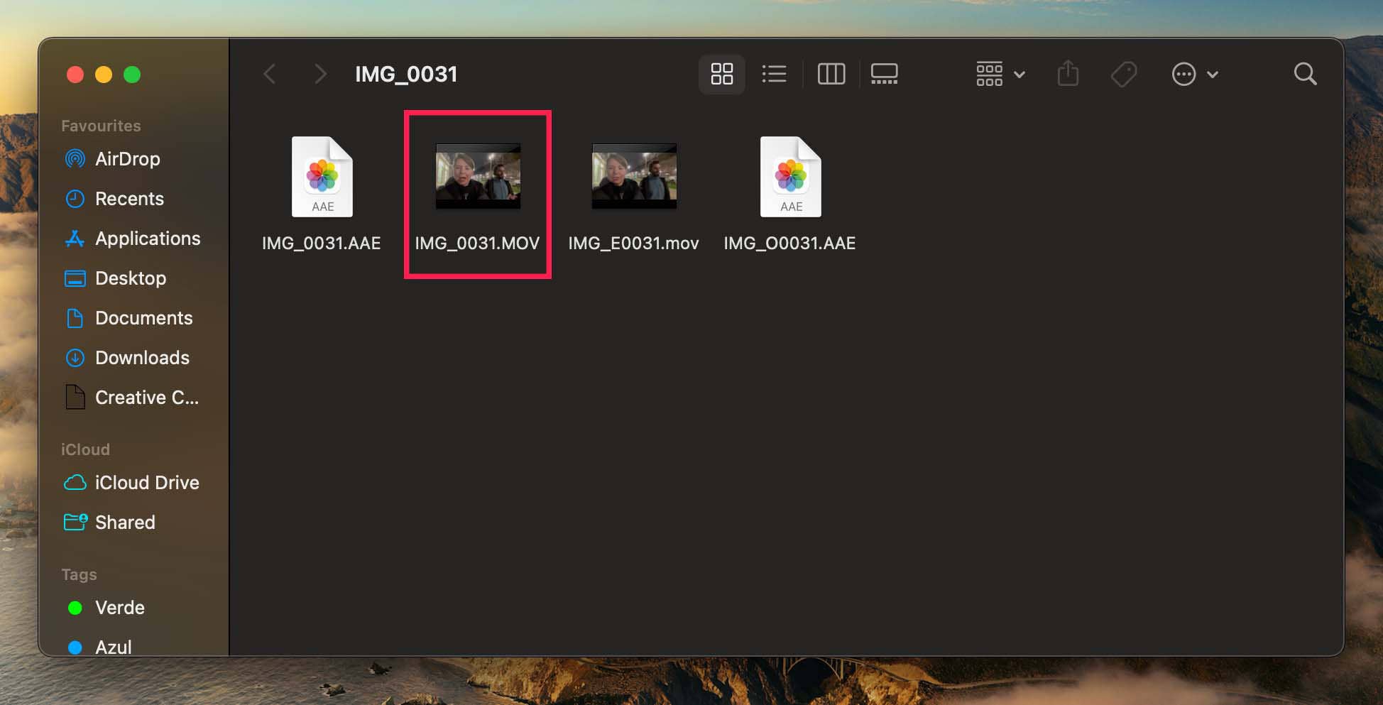

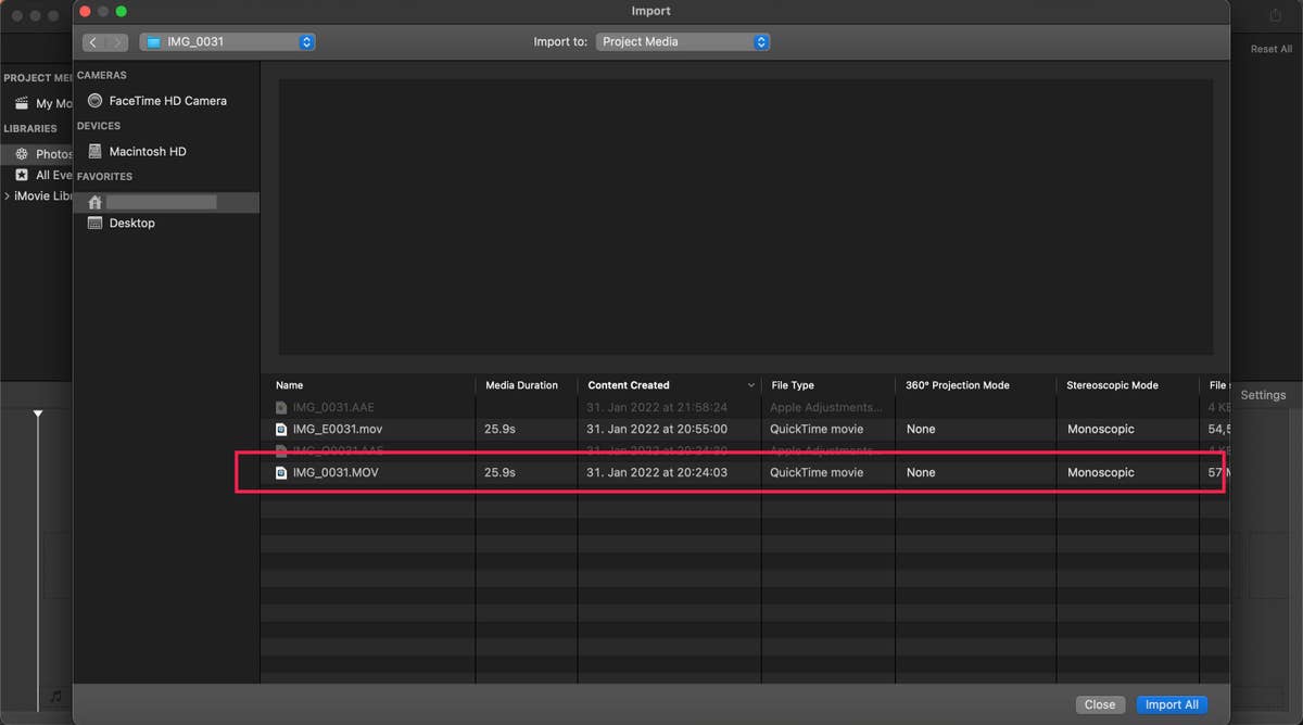

Also note that for each Cinematic clip that you transfer using AirDrop, a folder containing four files appears on the receiving Mac. In the folder, locate the MOV file that does not begin with “IMG_E,” then import it into iMovie.

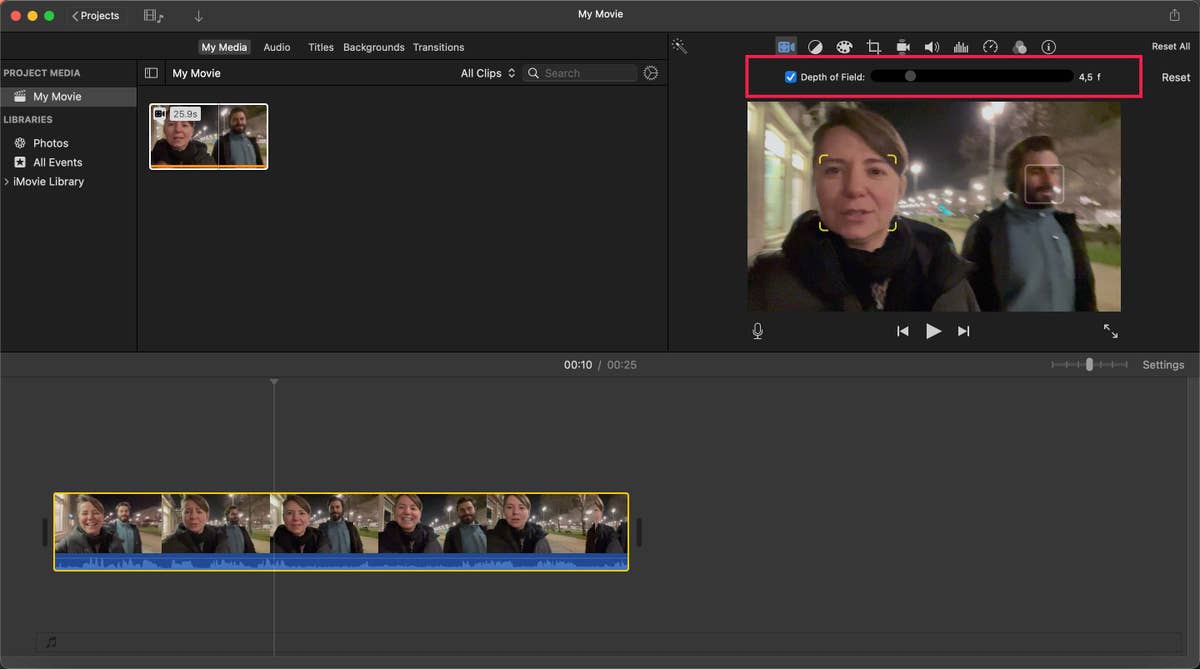

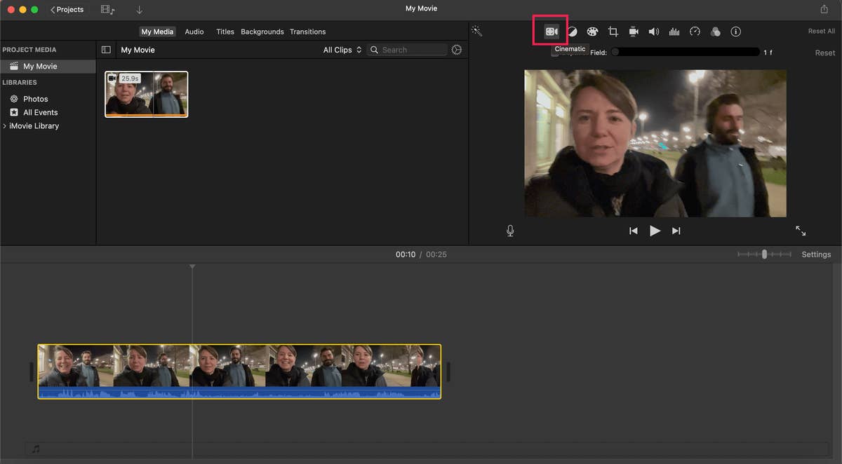

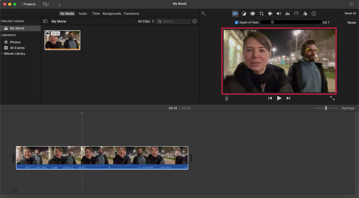

After importing your Cinematic video files into iMovie from a compatible iPhone, editing the videos using Apple’s free video editor is easy. Simply open the right clip as a new iMovie project, drag and drop the clip into the video timeline, and select the camera icon on the top of the video preview.
After that, just select the box “Depth of field” and you will be able to manually changes the focus. Here you can add new focus changes or eliminate existing ones at will. All the steps are explained in the following video gallery:
NextPit
After properly sharing the video file, launch iMovie and open the .MOV file without the E in the name.
Quelle: NextPit
NextPit

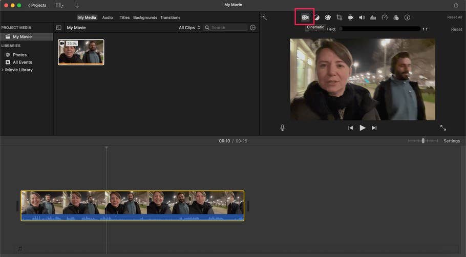

Now, you must click on the camera icon, which is named as ‘Cinematic’.
Quelle: NextPit
NextPit
The next step is to select the box ‘Depth of field’.
Quelle: NextPit
NextPit

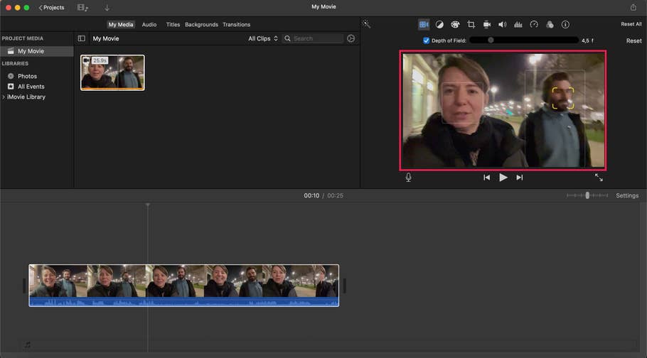

Here we will have the focus frame ready to use in different people or objects in the scene.
Quelle: NextPit
NextPit

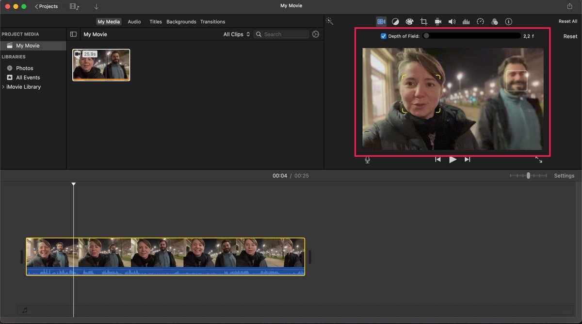

Itu0027s also possible to optimize the focal ratio. Here a smaller number offers a stronger bokeh effect…
Quelle: NextPit

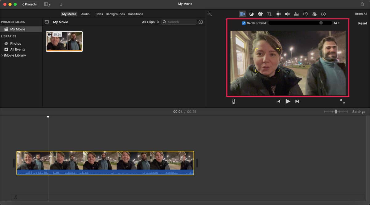

NextPit
… and a bigger number a weaker bokeh effect.
Quelle: NextPit
