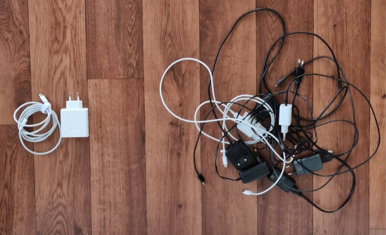

Disconnect the charging cable
Surprising as it may seem, many a time, ghost touch issues happen only when phones are connected to a wall outlet. This is especially likely if you happen to use a charger/cable of spurious quality. Basically what happens here is that these chargers and cables affect the functionality of the digitizer—which is the sensor that detects your touch inputs.
If you are facing this ghost touch issue while charging your phone, it’s best you replace the charger or charging cable with a new/better one. To check if a charger is really the cause, try charging the phone using a different charger/cable combo and check if the issue persists.

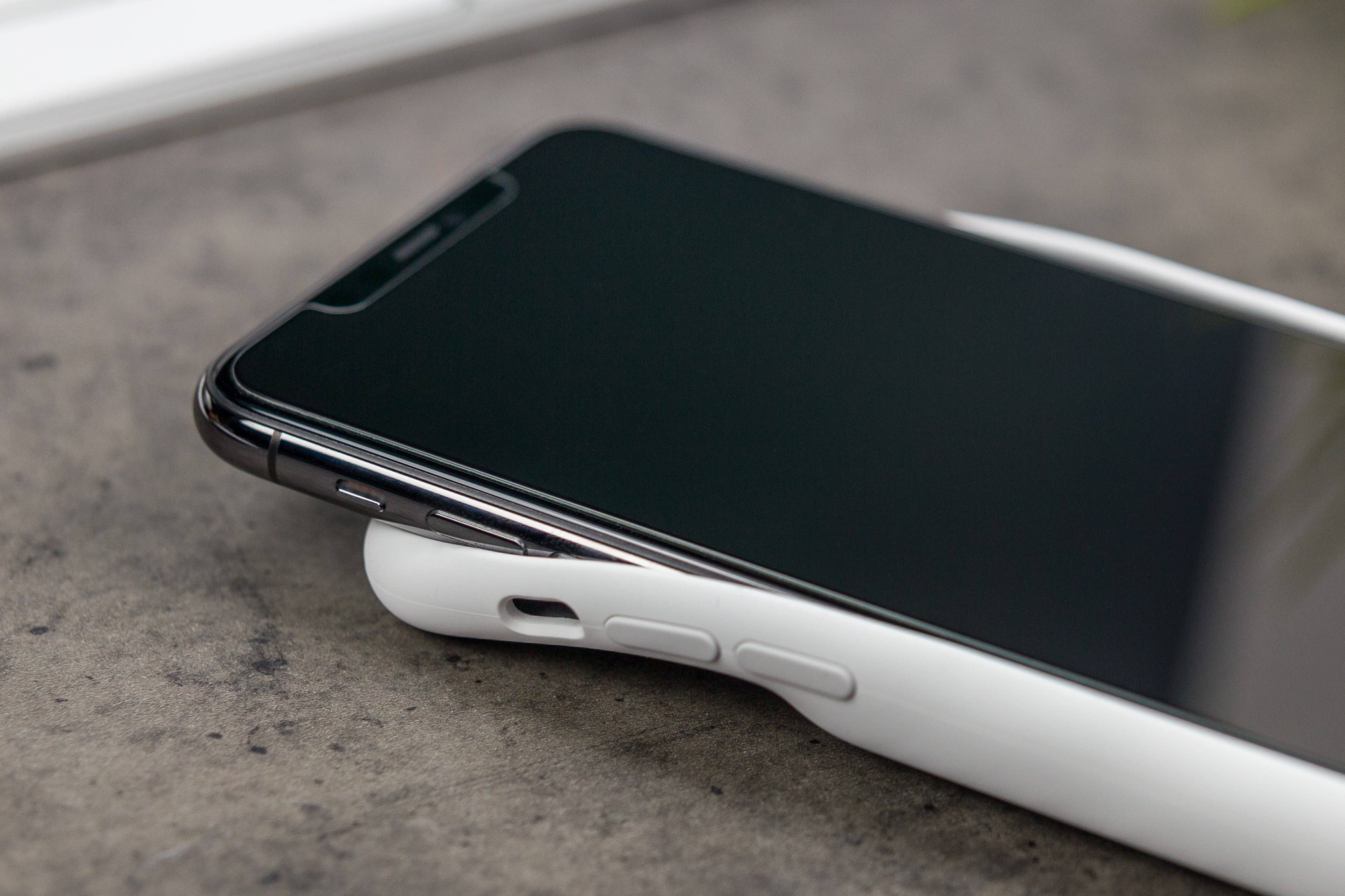

Clean the phone case
Especially with the popularity of edge screens, the actionable area in many smartphone screens now extends to the sides of the device. That not only can lead to unwanted touch detection issues caused by our hands, but also when a phone case is not properly installed, or worse, is dirty.
Similar to the screen protector’s tip above, remove the phone case, clean it properly and then reinstall it on the phone after drying. Remember to take special care if the case has a special feature—like built-in magnets, battery, or other—before cleaning the accessory.
