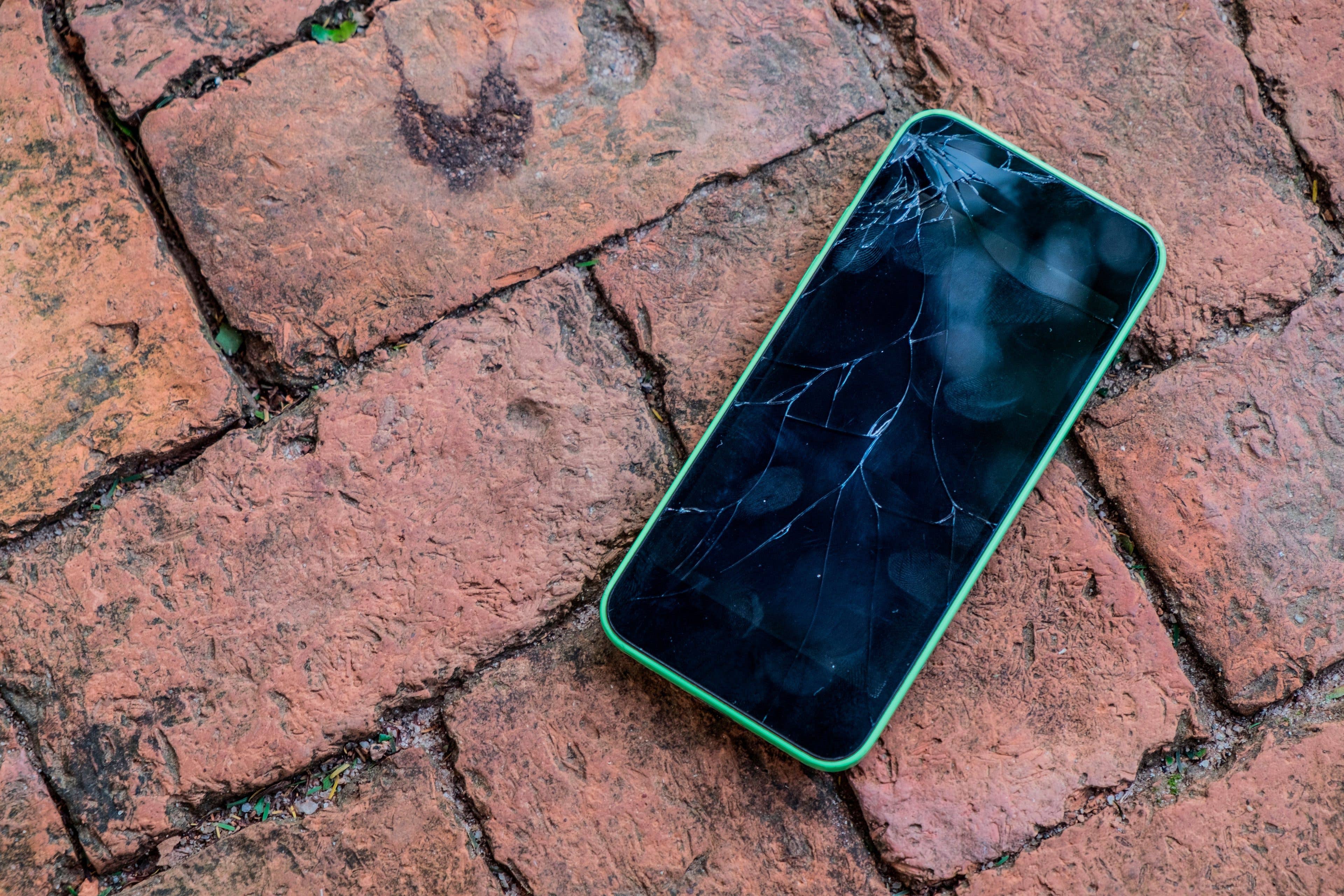

Reason #6: Your phone is wet or damaged
This is one of the most common reasons a phone won’t turn on. If you’ve recently dropped your phone or it has gotten wet, you might have some issues. Trying to turn a wet phone on too soon can short-circuit your phone and fry it, so if it gets wet, follow our guide on what to do with a water-damaged phone.
To put things succinctly, if you dropped your phone in water and it won’t turn on, you’re going to need to take it in for repair as you most likely have a hardware problem or a damaged display or battery. But before that, you can still try getting some data out of it by using the steps mentioned in the article below.

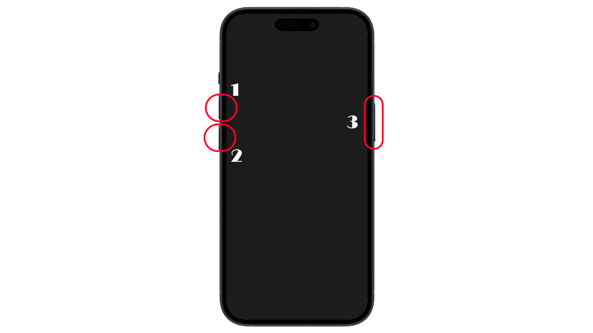

For iPhones, the same process for forced restart can be performed. Ensure there’s enough battery on your handset. Check out the following steps:
- Quickly press the volume up button.
- Quickly press the volume down button.
- Press and hold the side power button.
- Release the button when the Apple logo appears.

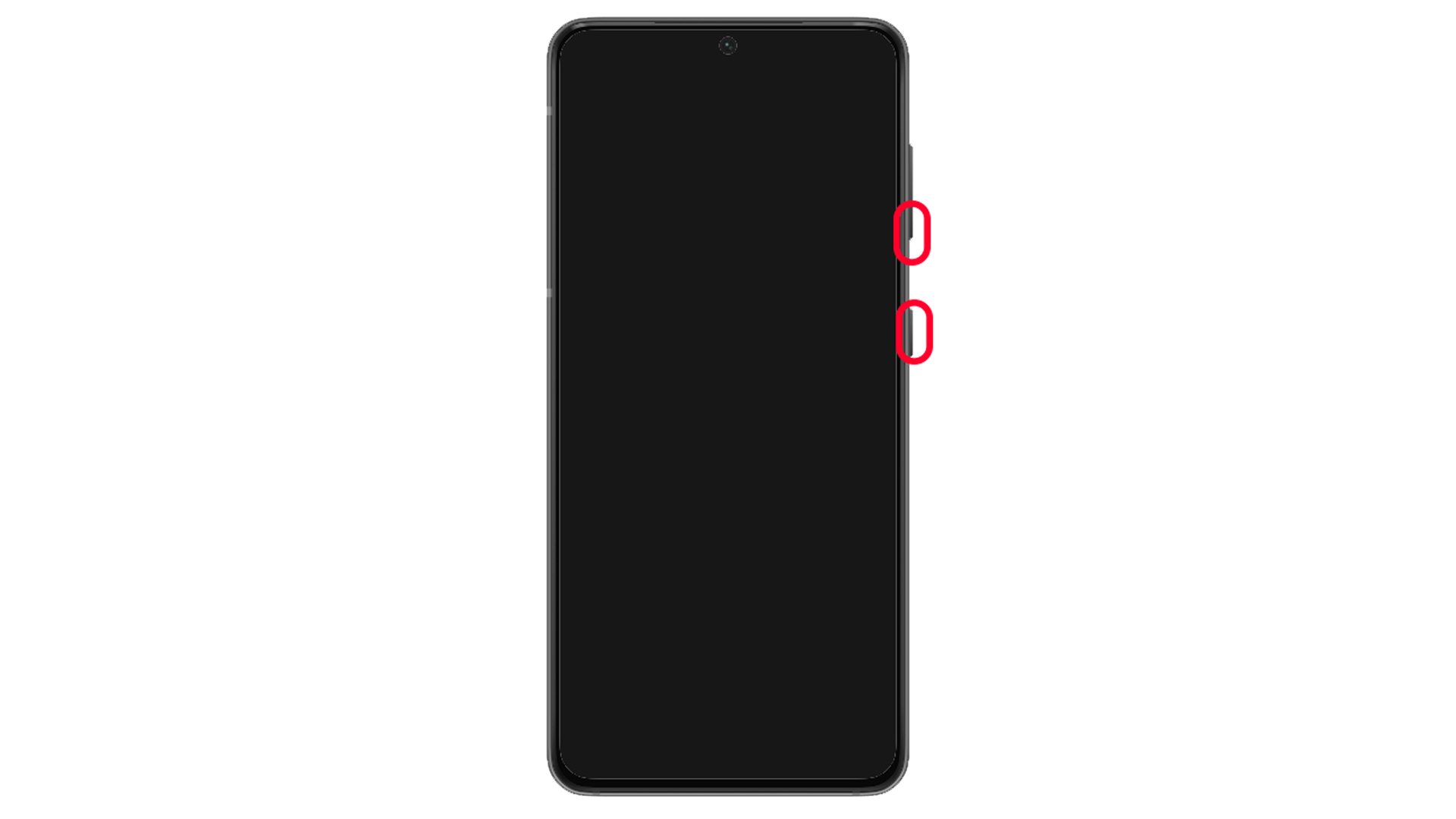

If you have an Android phone or a tablet that is not responsive or won’t switch on from the dead screen, you can also do a force reboot or restart. As usual, be sure that your device is charged or at least the battery level is not low. After that, proceed to the next steps below:
- Press and hold the volume down and power button at the same time.
- Release the buttons when the device vibrates or if the boot logo lights up.
