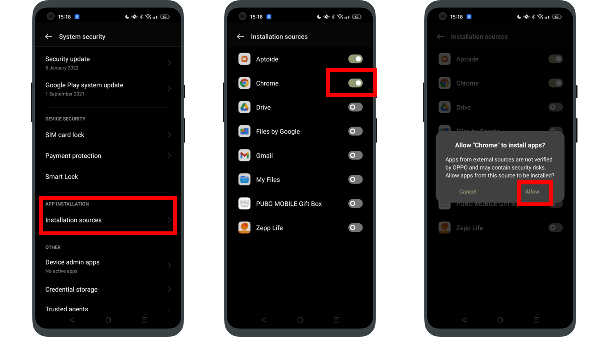

Setting up your device to sideload apps
If you have tried to sideload an app before then you will be familiar with this menu. Most Android skins will present you with a shortcut to this page when you try to get the process done alongside a series of warnings.
While there could be some slight variation in exactly where you’ll find this setting on your Android phone, it’s usually buried within the Security & privacy or App menus. These are the two most common paths:
- Go to Settings.
- Find the Security & privacy option and tap on it.
- Scroll down and look for install from unknown apps. If it’s not there, try under ‘more‘.
- You should be presented with a list of apps. Find your browser – Chrome, for example.
- Tap on it and then select Allow from this source.
If the above path doesn’t work for you, try the following:
- Head to Settings.
- Go to Apps & notifications and then select configure apps.
- Scroll down. Find and tap advanced options or special app access.
- Scroll to the bottom of the special app access menu, where you can find the Install unknown apps option.
- Find your browser, (e.g. Chrome), tap it and select Allow from this source.
If you still have trouble finding these options in settings, you can simply use the search option and type in ‘unknown‘ or ‘install‘, which should save you some time.
By checking ‘allow from this source’, you’ll now be able to install APK files downloaded from your browser. You can always go back to the settings menu and disallow this after you’re done installing your APKs of choice. Keep in mind that there can be additional security prompts or prompts to allow the installation of files from unknown sources on some devices or older versions of Android.

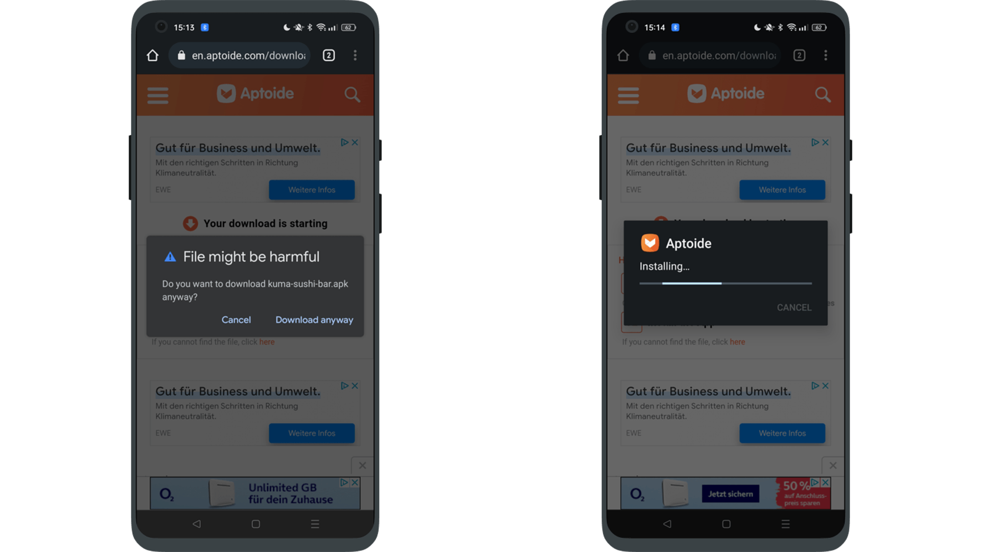

Downloading and installing an APK
By now, you know that where you download your APK from is key. Let’s take a simple example like downloading and installing WhatsApp from outside the Play Store.
In this case, WhatsApp provides its own direct download page that you can either visit on a desktop and then transfer the file to your phone, or visit on your phone browser (requesting the desktop site from your browser settings) and then download it directly to your device.
Once downloaded, you can check out your Downloads in the app drawer and select the downloaded APK file. Clicking on that will start the install process, and if required, will ask you to allow the app permissions to continue.
