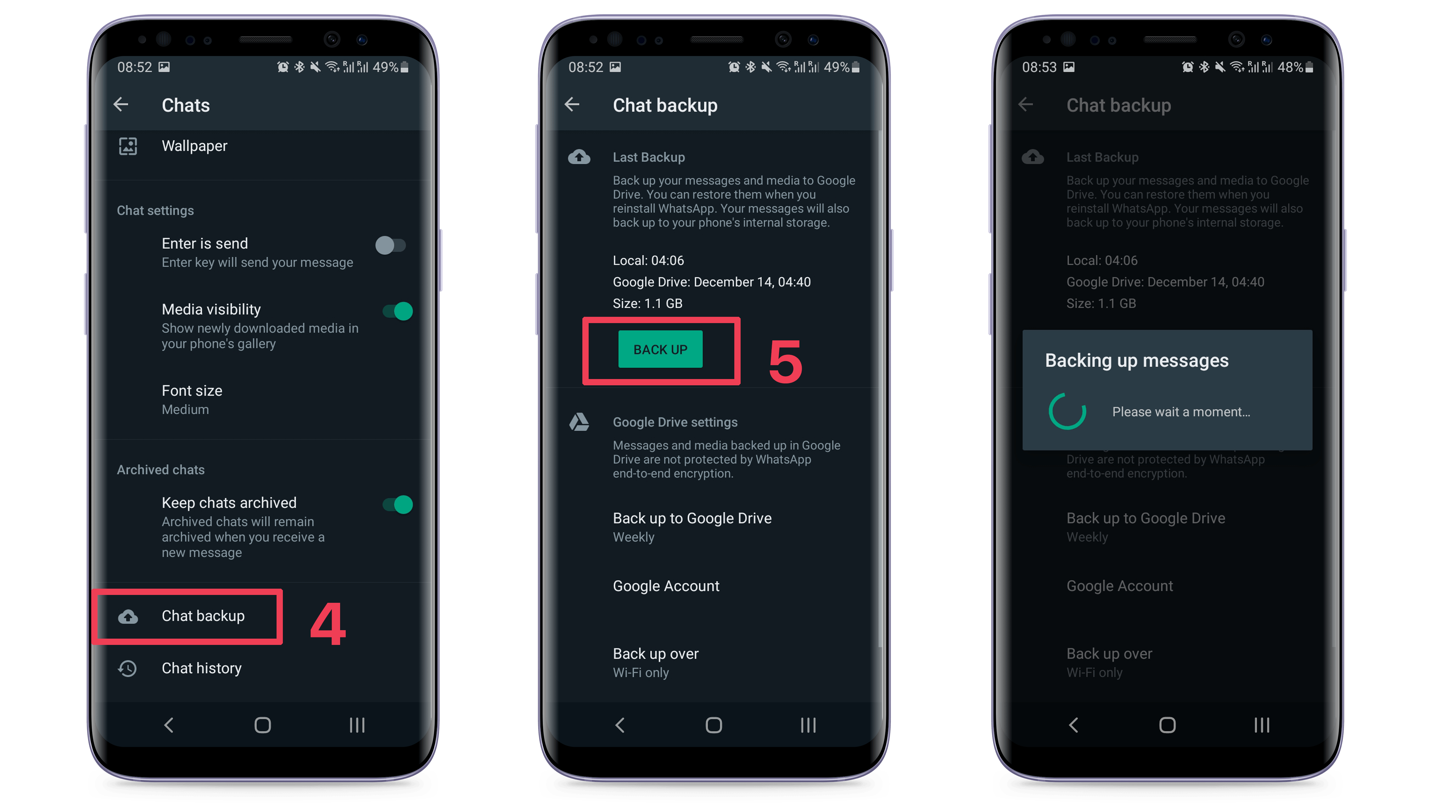

WhatsApp on Android smartphones uses Google Drive for automatic backups. Those are tied to the phone number and Google account they were created on, so it is important to keep these details in mind. The feature makes it easy to transfer chats but to avoid losing messages it is critical to take some steps.
Depending on the current settings, backups may be turned off, or set to a weekly or monthly basis, which can leave an outdated chat history at Google Drive. To ensure your new phone will have all the latest messages, force a manual backup:

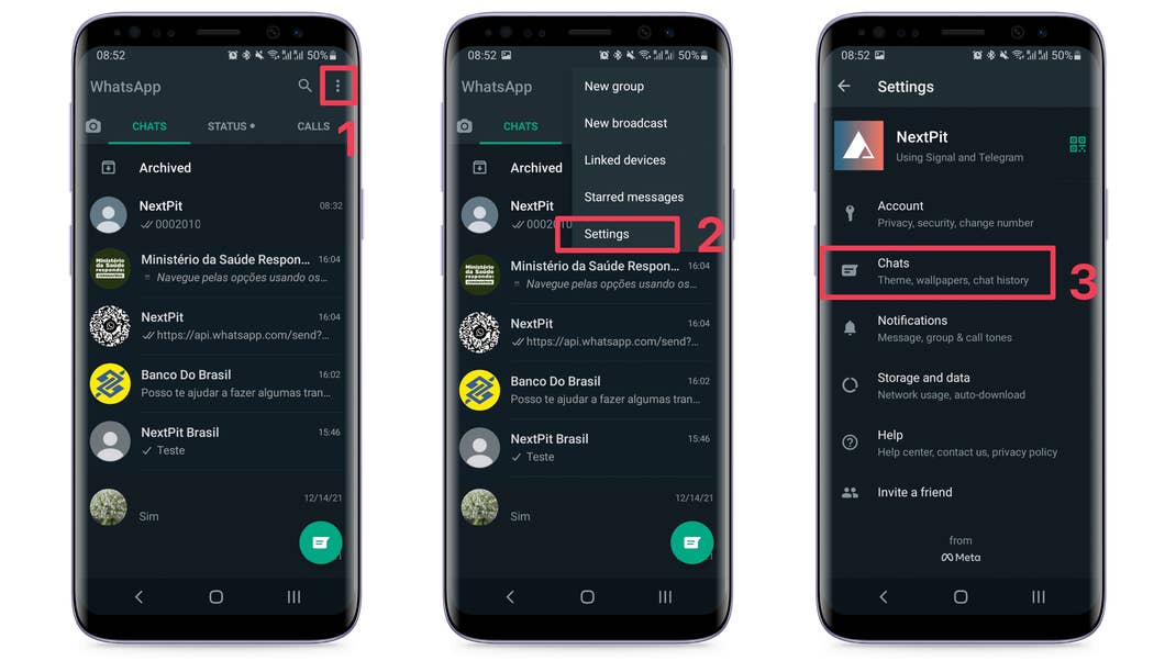

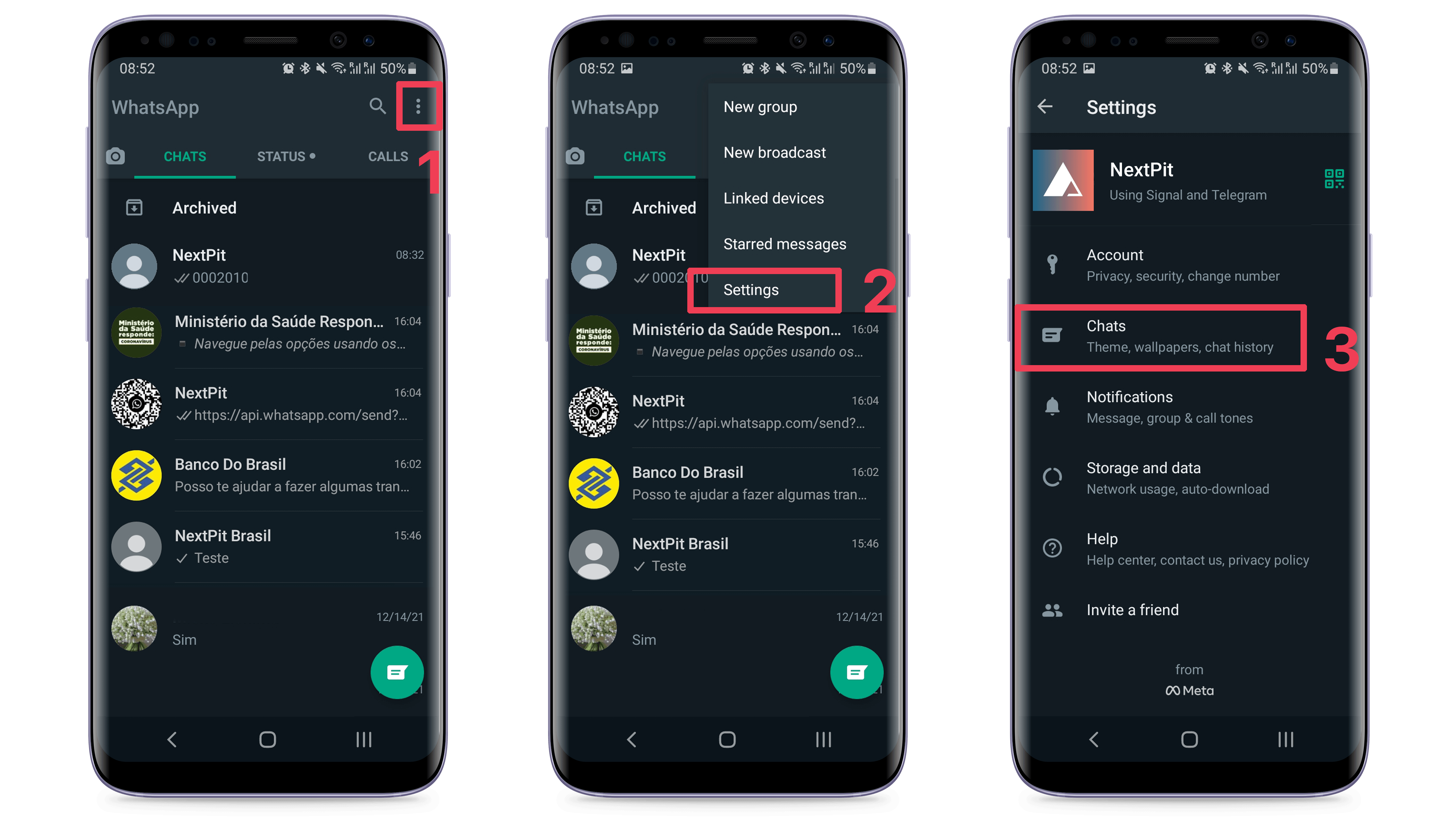

On WhatsApp’s main screen tap the three dots button ⋮.
Select Settings.
Tap Chats.

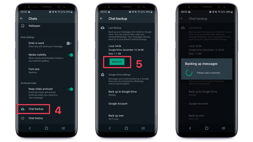

Go to Chat backup.
Tap the BACK UP button.
Important: If your videos are not backed up using other apps (like Google Photos), remember to check first the option Include Videos, otherwise, the backup will have only messages and photos.
Now that all of your messages from the old phone are saved on Google Drive, you can start setting the new mobile up. But first, remember to register the same phone number/SIM card and Google Account on the new device. And to avoid surprises, we recommend you connect to a Wi-Fi access point instead of cellular data.

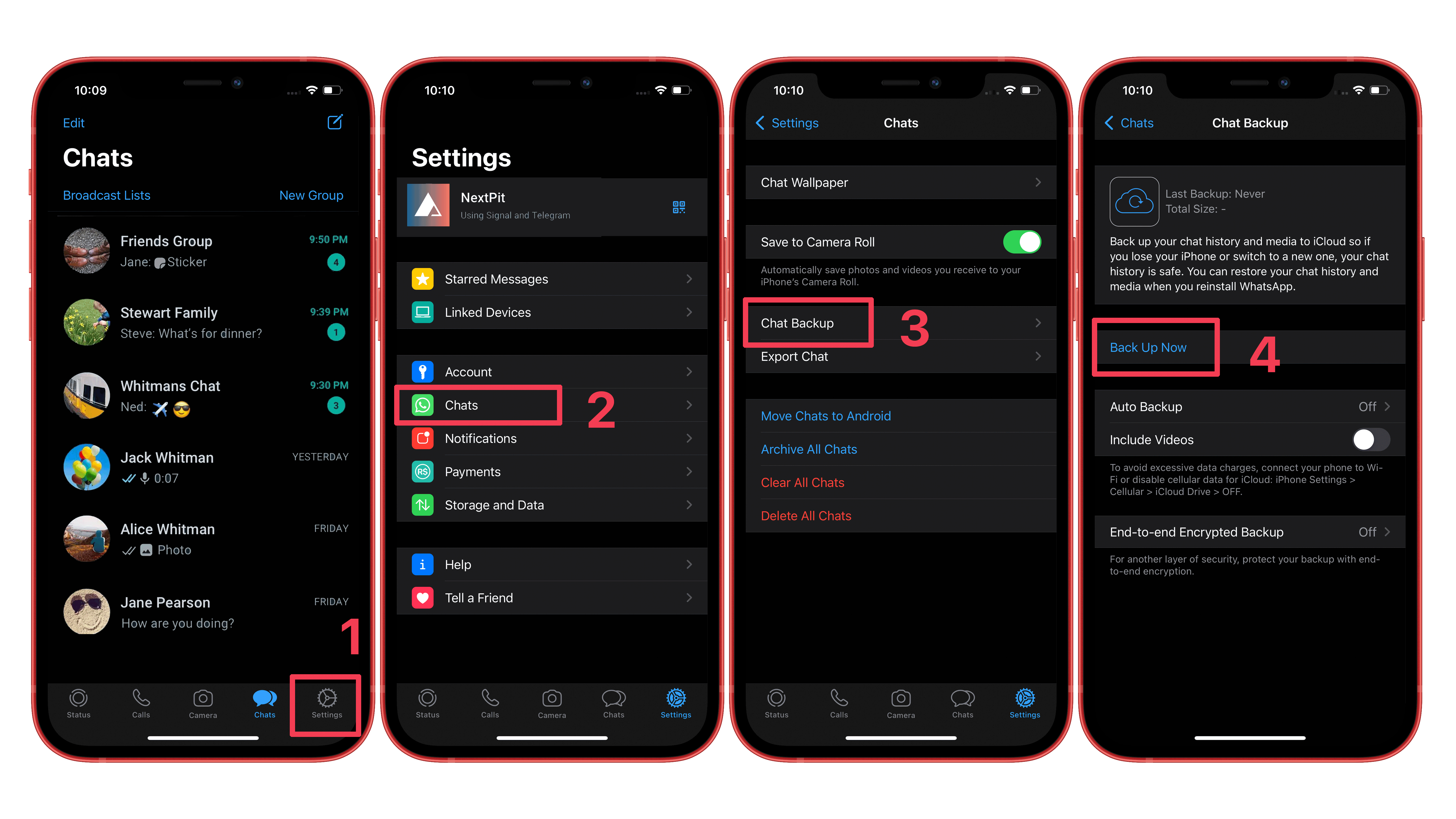

The backup steps are pretty much the same for iPhone owners, the main difference is that your chats are saved to the iCloud account online storage instead of Google Drive.
Tap Settings.
Select Chats.
Go to Chat Backup.
Check the Include Videos option and then tap Back Up Now.
When setting up your new iPhone, remember to use the same Apple ID from the old phone, and to have iCloud Drive turned on, as well as the same phone number used previously. WhatsApp should ask if you want to restore the messages and media saved in the backup during the first run. Confirm, and wait for your data to sync automatically.

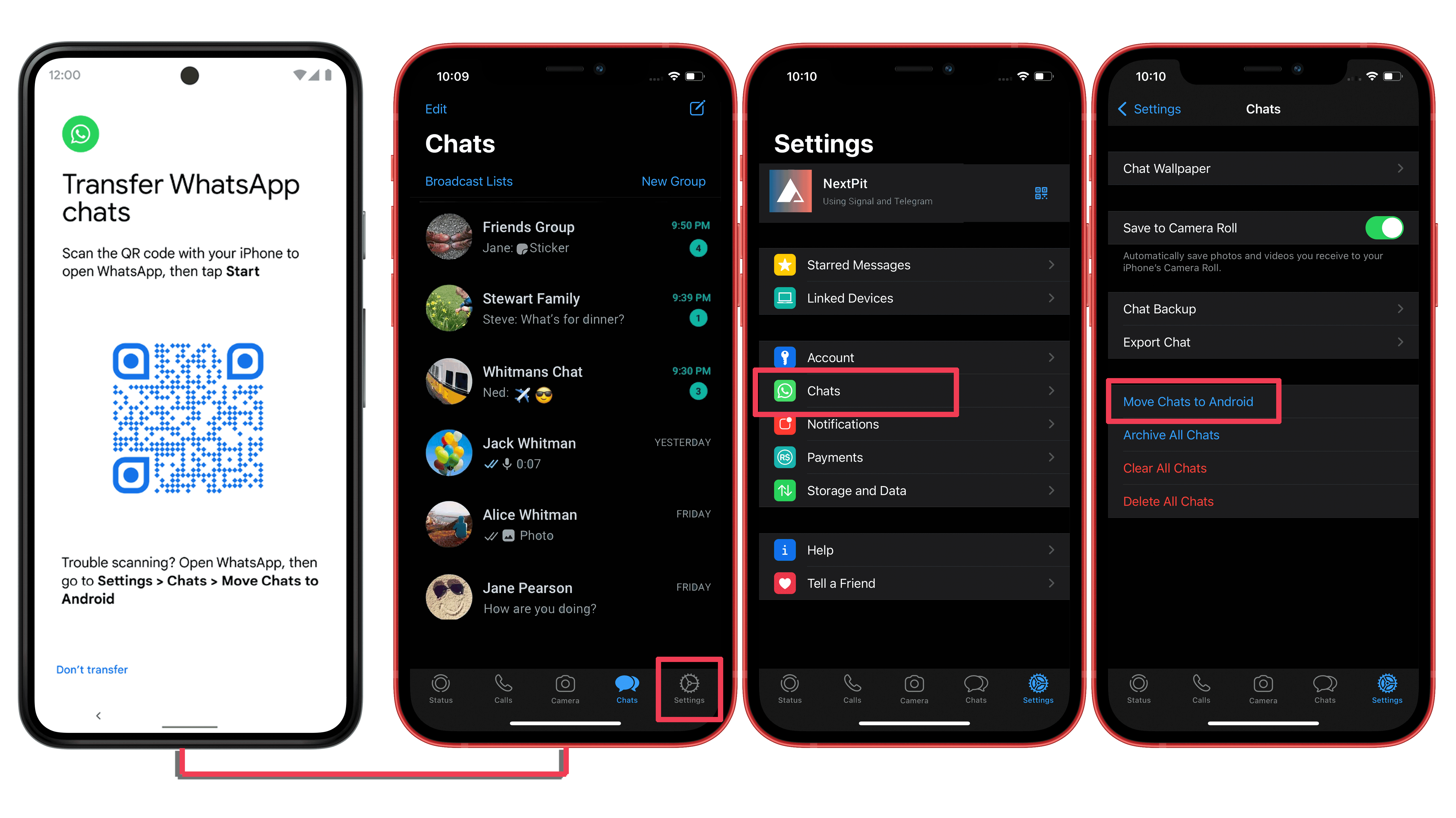

4. Transferring WhatsApp chats from iPhone to Android
In October 2021, Google announced that Android 12 phones can now transfer WhatsApp history from iPhones, using only a Lightning to USB cable — usually USB-C on newer Android phones. Before trying the feature, make sure WhatsApp is updated on both devices, and that the new phone’s app is registered to the same phone number as the old iPhone.
The procedure runs during the initial Android setup, so it is not possible to restore WhatsApp messages to an existing Android installation. If the device was already configured, you will need to restore it to factory defaults.
After activating WhatsApp on the new phone, the old device will stop receiving messages. Remember that payment messages and call history are not transferred to the new device, only messages and most types of media (images, videos, audio messages).
